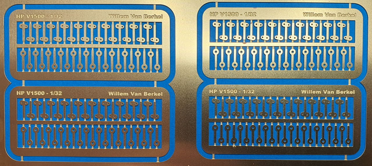

As you may know, I’ve had problems with the control horns. I just couldn't get them right. There are 8 on the elevators, and 8 on the ailerons.
This aircraft has a lot of (complicated) rigging, and the control horns are part of that. Because they catch the eye, I want them to look good, and the same. After struggling for a few weeks, I decided to have them photoetched by a third party. For that, the manufacturer needs CAD drawings in .dwg format, so I had to find someone who can do this for me. I can draw up a pretty good dimensional drawing by hand, but not in a CAD program and the learning curve of these programs is pretty steep. David Hall (Jaysena) has offered me kindly to do this step for me.
PE fret control horns for ailerons and elevators

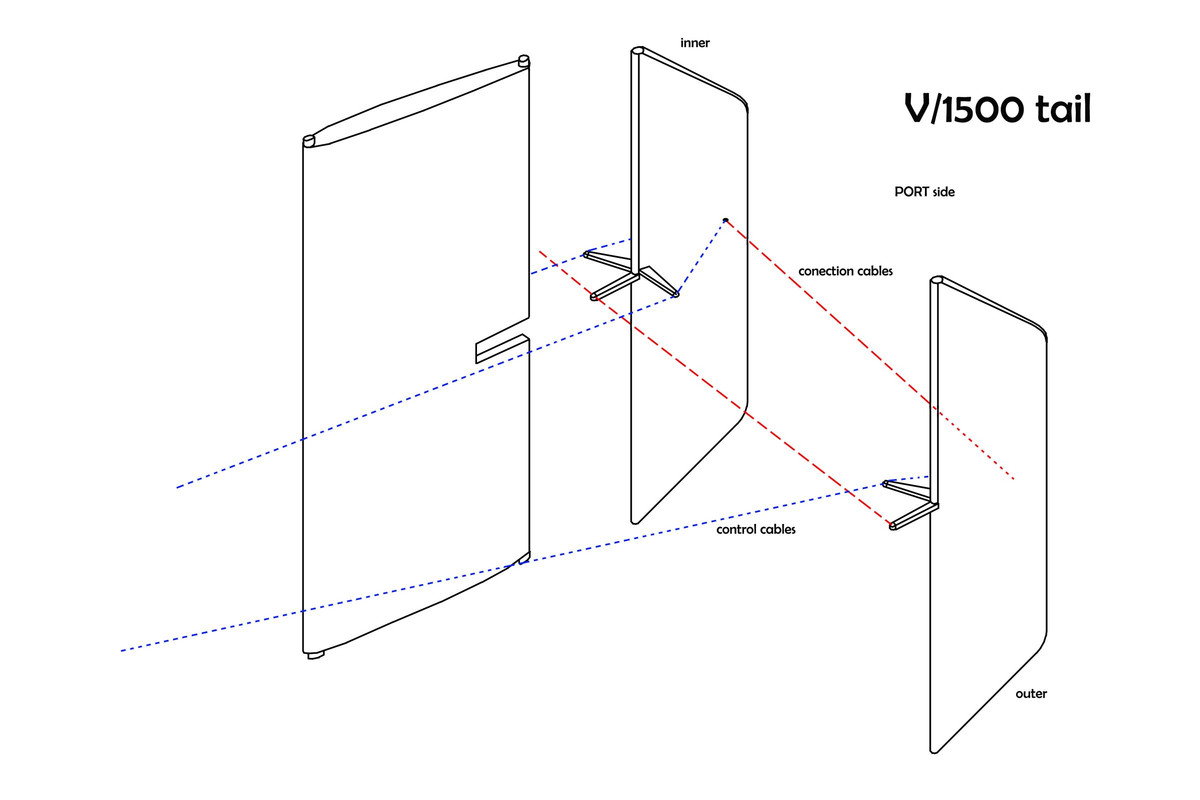

The four rudders that Ron Kootje cast for me were all wrong. That was my own fault entirely (sorry Ron). I overlooked the fact that the rudders (in contrast to the rudders of the O/100 and O/400) were balanced although it clearly says so in the article in Aircraft Pictorial April 1962 “Handley Page V/1500” by Jack Bruce.
Marty Digmayer sent me a sketch with details of the fin and rudder. Each rudder has an extra control horn that slides through a slot in the fin.
Copyright:Marty Digmayer
In the datafile picture no. 55 shows the tail of the machine in full view. Unfortunately it’s not very sharp, but Rob Mulder, author of ‘The First Aviation Exhibition Amsterdam – 1919’ sent me this high-res photograph which shows tons of details.

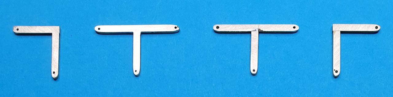

The rudders turn on pivots (1mm brass rod) that are embedded in the leading edge of the stabilizers. The two outside rudders have control horns with two arms, the inner two have three arms. Apart from the control cables, a reinforcement cable runs through the hole of each control arm and is connected to the top and the bottom rudder.
All four rudders are interconnected via a connection cable that runs through the fuselage just forward of the tail gunner’s cockpit.
The horns are made of 0.5 x 1.0 mm brass strip. and will not be installed until the final assembly of the tailplane.

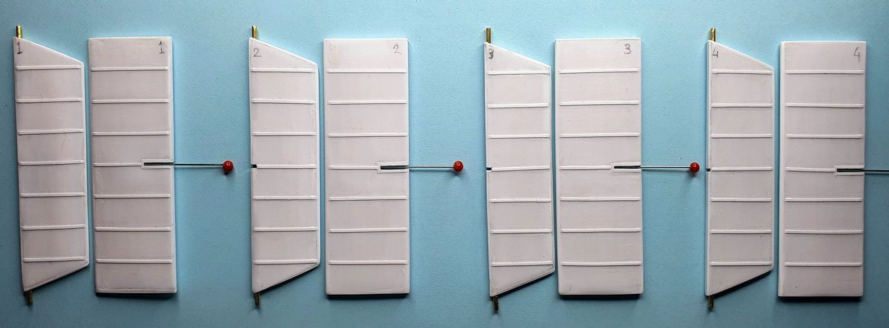

The rudder parts before assembly…
 …and after.

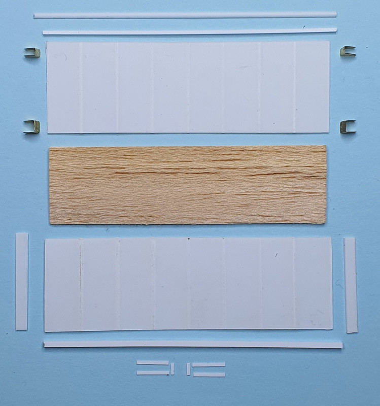

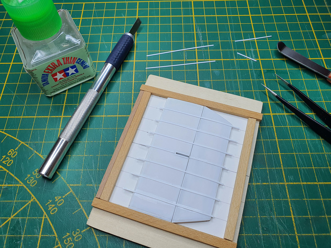

I made a little jig to make sure every part has the same length and to help me to get the rib simulations (0,25 x 1 mm plastic strip) aligned. The strips are laid out over both the fin and the rudder and glued. When al were placed they were separated and cut to the right length.
Alignment jig
Rudder, fin + strips

Yesterday I made good progress. The jig I made turned out to be very useful. The strips are on nicely aligned and I’m quite happy with the results.  So now I have 4 sets of fins and rudders. Today I’ll trim the excess styrene, do a little cleaning up and then it’s off to the spray booth for priming.
I’ll be back.

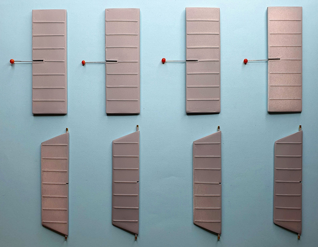

I trimmed the excess and faired the strips towards the trailing and leading edge.
To get this far I used Tamiya super thin glue, Vallejo plastic putty, 240, 600 and 1200 grain sanding paper and Tamiya polishing paste.
Before putting on the primer, all the parts were blown free of dust (with compressor air) and cleaned with 97% alcohol.
This is how they look after a first layer of primer. As expected, they need a little touching up and a little more fairing.
I used Mr. Surfacer 500 from a rattle can, and although it doesn’t really show on this picture, the result is rather grainy.
The 500 grain I used, did not build up a little "ridge" to make the edges of the ribs a little smoother, but maybe that's because this is only one thin layer. I do have a compressor with a pressure tank and a single action and a double action airbrush, but I haven’t used it yet.
What do you, my fellow modelers, generally use to airbrush primer on, and with what psi?
Any advice is welcome.
