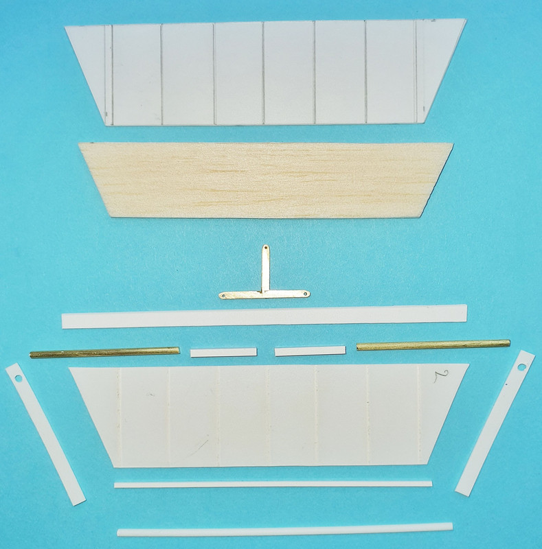

The fins:
Each fin has 4 brackets to secure them between the upper and lower stabilizer. Each fin has a slot  in the trailing edge to accommodate the movement of the rudder control horn.
The fin parts before assembly…
…and assembled
The rudders:
The rudders turn on pivots (1mm brass rod) that are embedded in the leading edge of the stabilizers. The two outside rudders have control horns with two arms, the inner two have three arms. Apart from the control cables, a reinforcement cable runs through the hole of each control arm and is connected to the top and the bottom rudder.
All four rudders are interconnected via a connection cable that runs through the fuselage just forward of the tail gunner’s cockpit.
The horns are made of 0.5 x 1.0 mm brass strip. and will not be installed until the final assembly of the tailplane.
Soldered rudder control horns
The rudder parts before assembly…
 …and after.

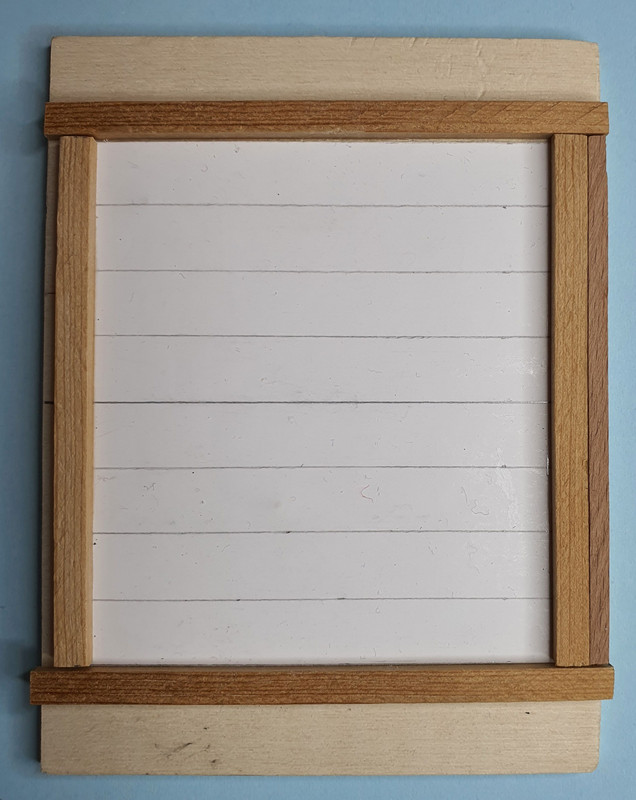

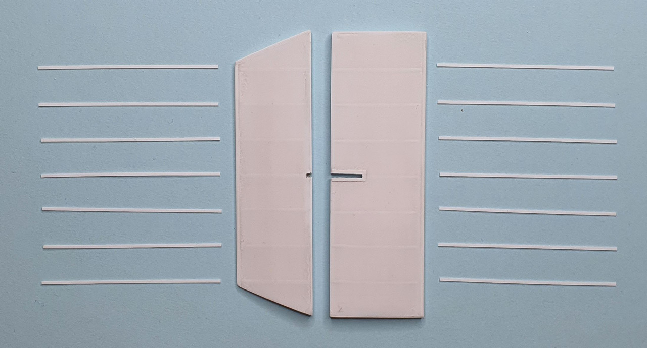

I made a little jig to make sure every part has the same length and to help me to get the rib simulations (0,25 x 1 mm plastic strip) aligned. The strips are laid out over both the fin and the rudder and glued. When al were placed they were separated and cut to the right length.
Alignment jig
Rudder, fin + strips

Yesterday I made good progress. The jig I made turned out to be very useful. The strips are on nicely aligned and I’m quite happy with the results.  So now I have 4 sets of fins and rudders. Today I’ll trim the excess styrene, do a little cleaning up and then it’s off to the spray booth for priming.

Excellent work Willem, your jig worked perfectly. Those strips are perfectly spaced. I am very inspired by this update, keep up the great work!

Outstanding results. Your jig worked perfectly!

I trimmed the excess and faired the strips towards the trailing and leading edge.
To get this far I used Tamiya super thin glue, Vallejo plastic putty, 240, 600 and 1200 grain sanding paper and Tamiya polishing paste.
