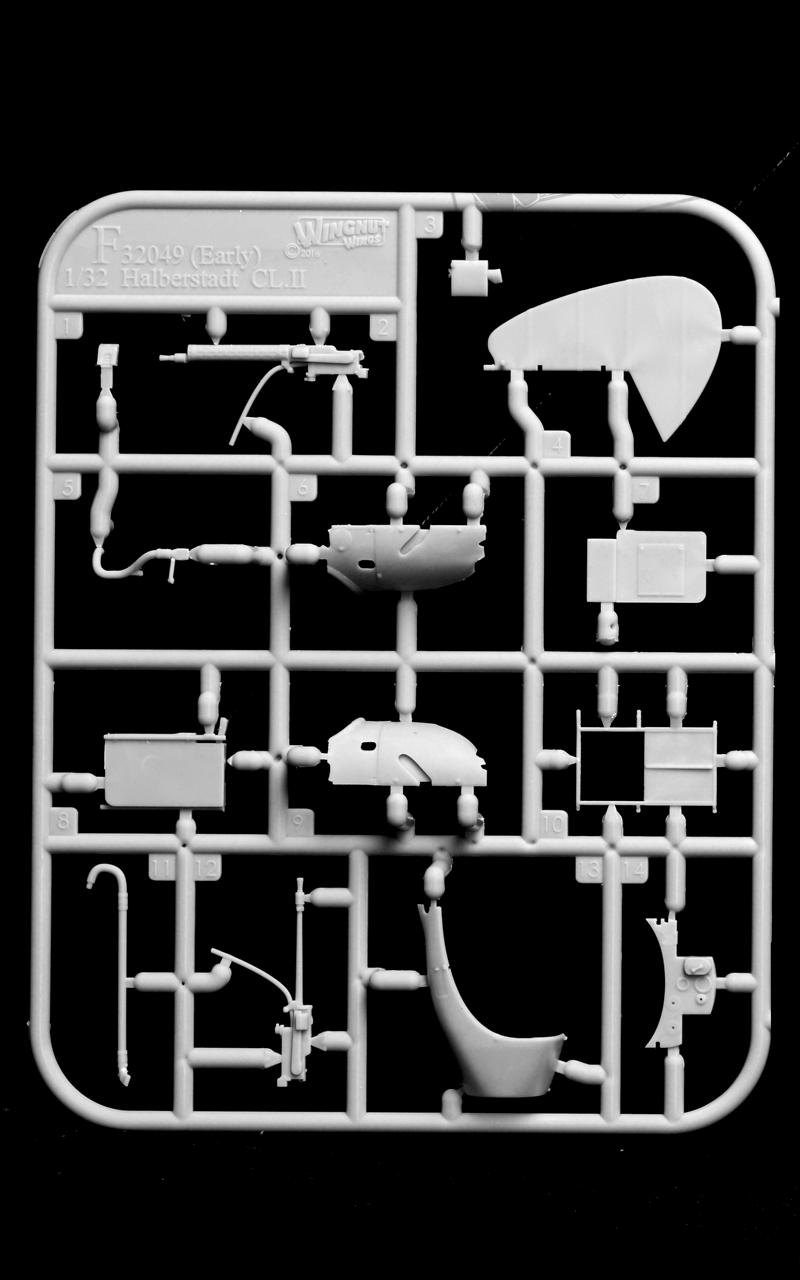

If you need to compare to WNW sprues, here they are. Pictures are not that good, but enough to notice you far exceeded the reference. Congrats again, really deserved.

Very interesting comparison on WNW parts, so thank you for the pictures Giuseppe and Spyros. Spyros, I think those are pictures from you build in progress? You should not forget to paint the rubber ;) But I guess you have done already ....
