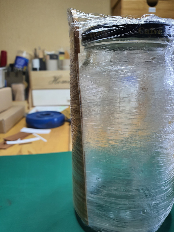

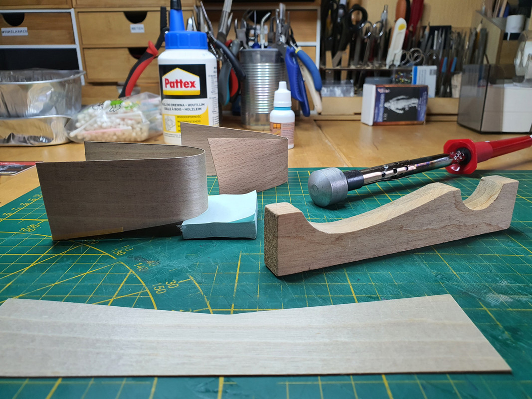

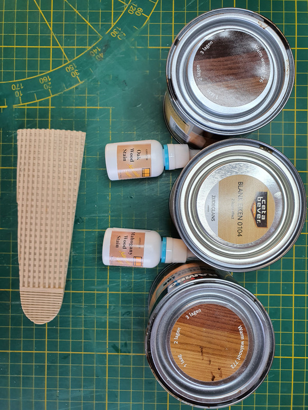

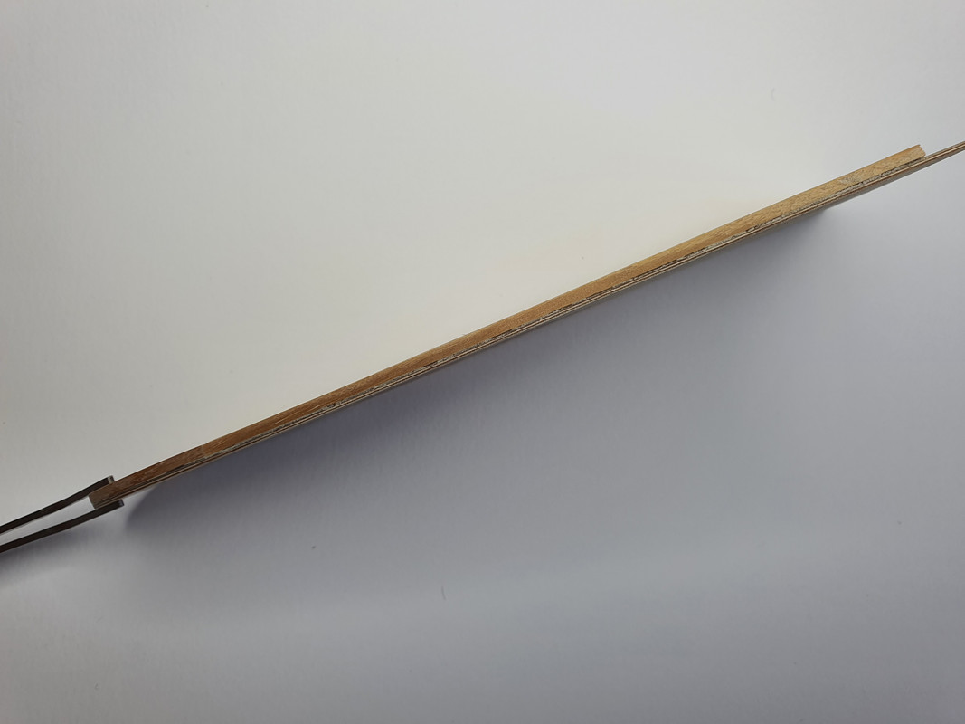

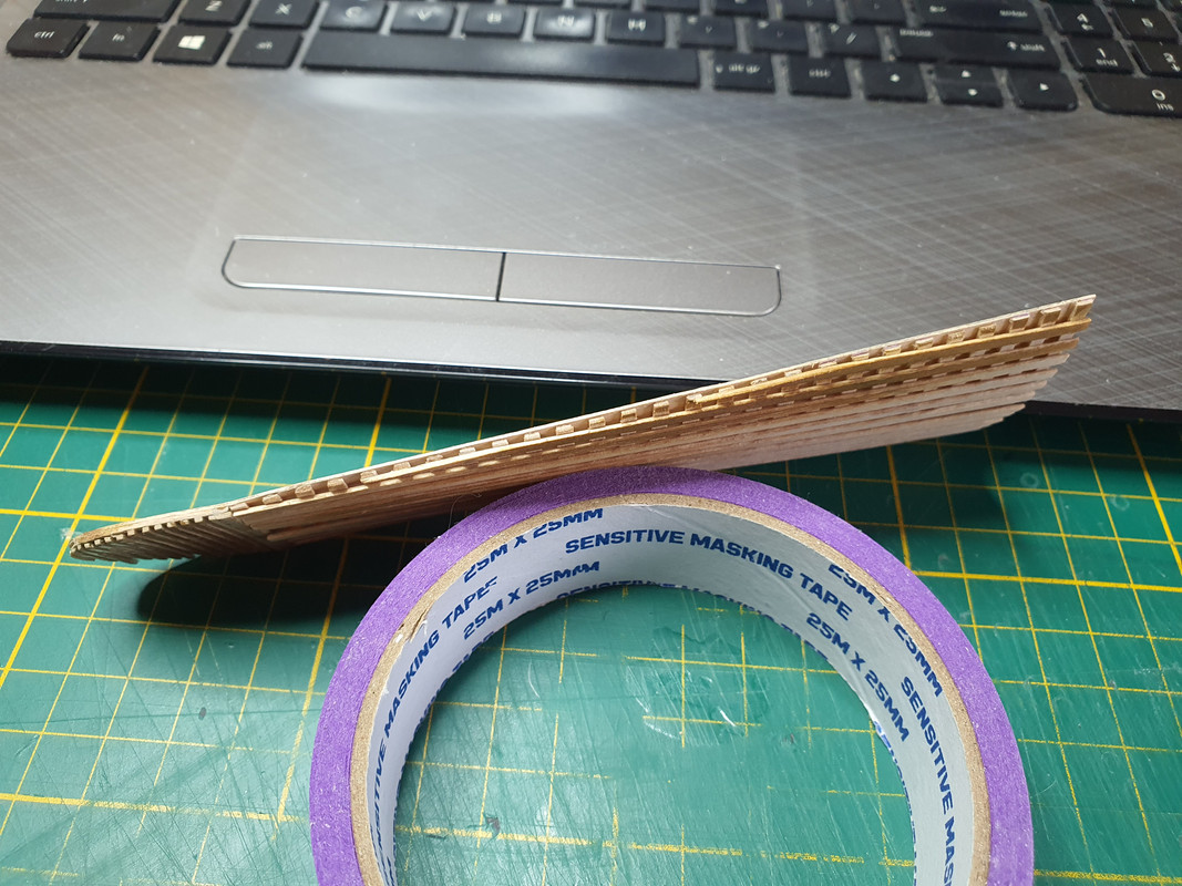

I thought the warped cockpit floor would be an easy fix, but it wasn’t. I tried steaming, bending, heating, soaking, wetting and cling-wrapping it to a glass jar, but every next attempt turned out worse than the previous. It is now propeller-shaped with a build-in sinus wave.

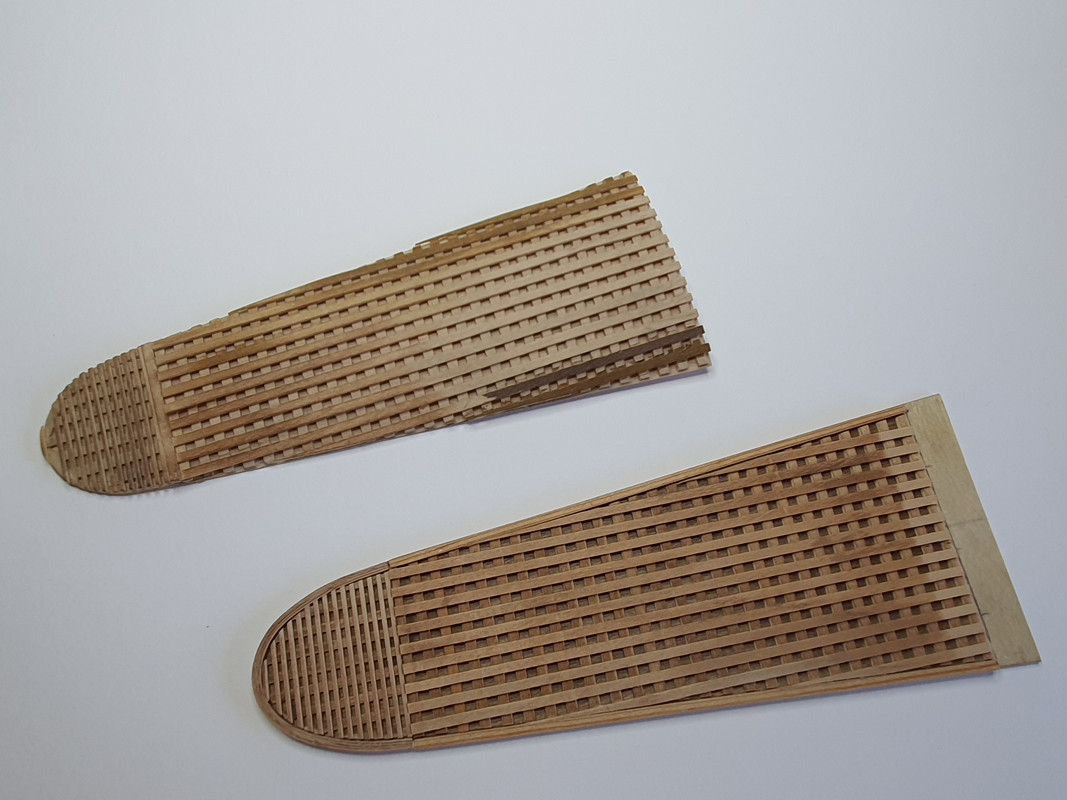

So, I made a second version, only this time I used thick CA glue.
Because this glue dries faster than PVA, and I didn’t have to wait so long before applying the next layer, it took less time to make. This one is as straight as an arrow. It has to have some colour and I had 5 coulors to choose from.

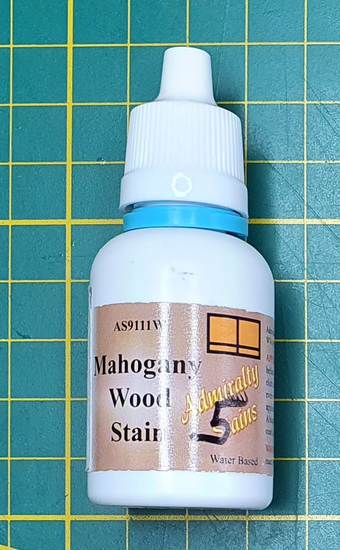

After a bit of experimenting I used Admiralty Stains Mahogany, applied with an almost dry cloth.
Here are the first and second attempt of the cockpit floor decking. Practice makes (almost) perfect.

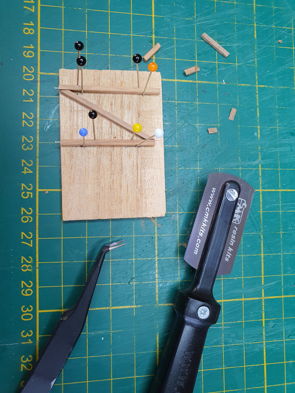

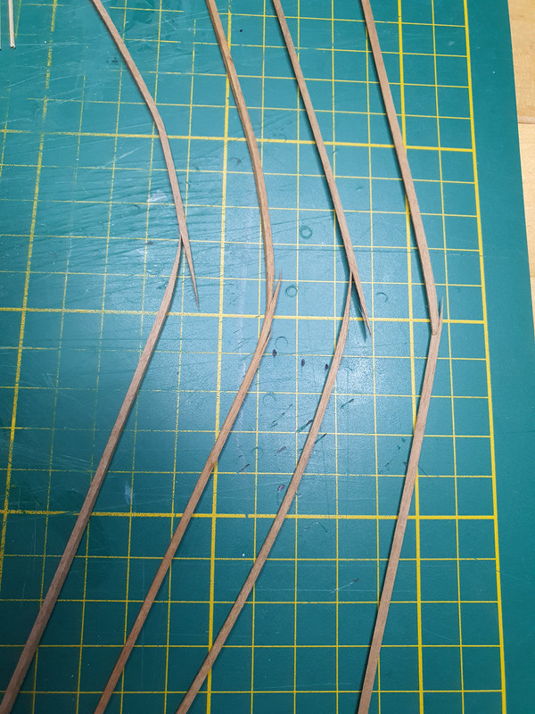

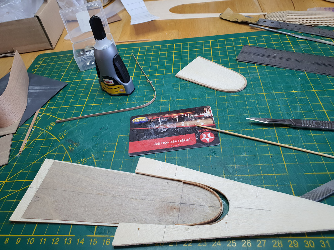

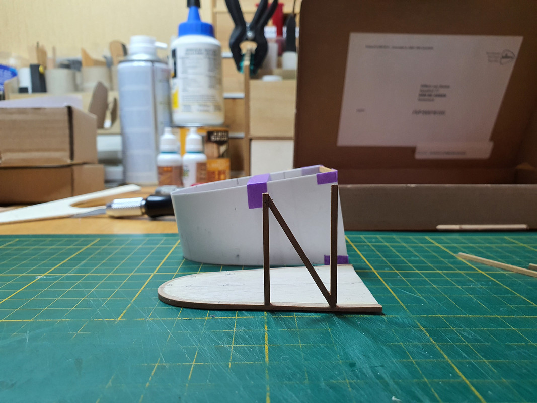

I tried to bend a 4x4 mm strip of wood into a rim, but after the sixth failed attempt I decided to make it from laminated strips of wood. That turned out very well.  I glued it to a piece of ply that represents the forward section of the cockpit floor to have a base to start with the vertical struts.
The first mistake and proof that making a mockup first was a good idea…
The vertical struts should be at a 90 degree angle with the top of the cockpit, not the floor.
To get the cockpit sides into the right shape, I used an electric plank bender. I’m not sure this will work, because it is now in one piece, instead of two halves, it makes detailing the interior harder. On the other hand, I now have a nicely rounded nose that doesn’t need any fixing. We’ll see.
In the background is the first failed attempt. I used boiling water and a glass jar to shape it, but that didn’t work. In the foreground is a spare one. You just never know.
The white styrene is the template. The markings are the positions for the vertical struts.
