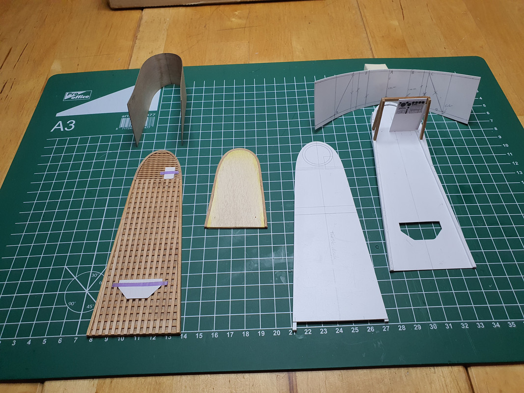

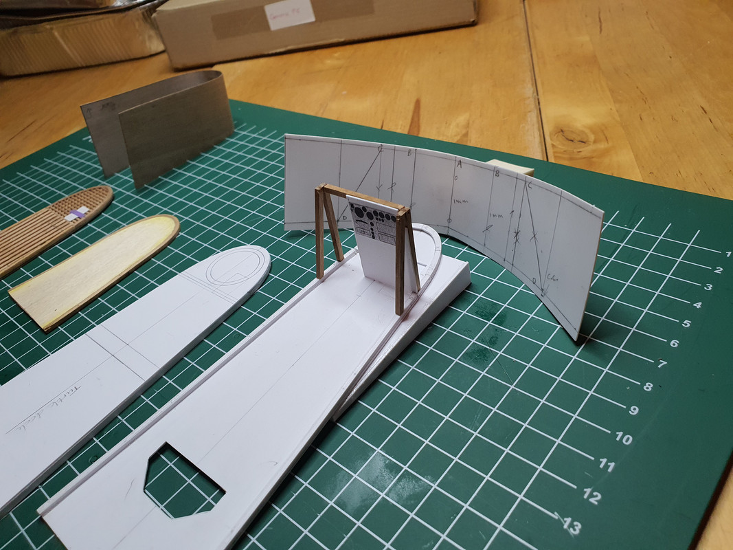

Cockpit and forward gunners position
This is a complicated section. I have looked at the instruction for the WNW HP O/100, the windsock data file plans and the factory drawings and then made my own working drawings.
Figuring out the positions of all the different components was time consuming, and I made a styrene mockup to work from. I don’t want to use the wooden floor I made because I’m a afraid I’ll ruin it.
More later.
« Last Edit: November 17, 2023, 04:26:55 AM by Rookie »

Thanks Dave. Making the control column took a lot longer than I expected. I ended up replacing the styrene parts, because they would melt with the other soldering work. I CA-ed the pedals to the rods to avoid them ending up as just unrecognizable blobs of solder. It still looks a little crude, but once it is cleaned up and painted it will look a lot better.
Excellent progress Willem and I like the mock-up idea. Nice work and thanks for sharing your progress!
Thank your for the kind comment Zac,
The mock-up gives me room to experiment with the location of all the stuff that needs to go in the cockpit and the gunners position. Only when I am certain that a certain section is right, I'll duplicate it to the wooden floor.

It may be a long distance project Willem, but it is certainly worthwhile. The cockpit floor is a work of art in itself, but with the controls it will be even better.
Using mock-up parts is the only way to get things right. They do take time but they save a lot of tears!

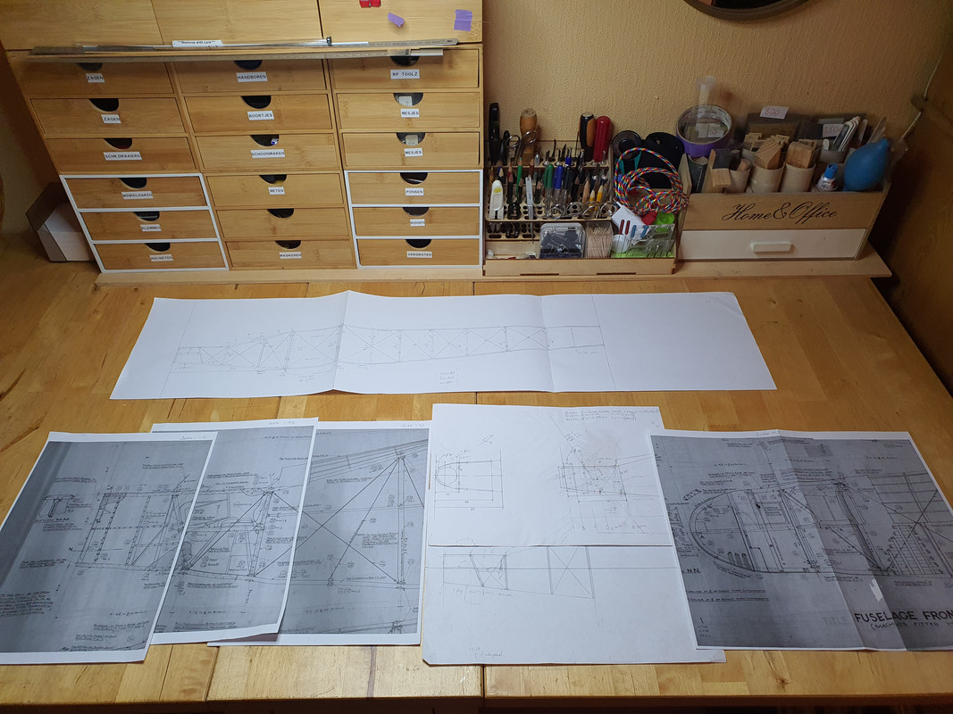

Again, some great documents on the HP O/400 and HP V/1500 have surfaced.
A fellow modeler, active on Britmodeller found these at the Udvar-Hazy Center in Chantilly, Virginia in the United States.
Thank you Joshua!
This is primarily a promotional document, advertising the Handley Page  O/400 and V/1500 in English, French and Spanish:
Then there is this document with the easy-gong name “GUIDE TO THE ASSMBLY AND ERECTION OF THE HANDLEY PAGE TWIN TRACTOR BIPLANE, TYPE O/400":
And last but not least a folder with miscellaneous report on engine tests with Rolls-Royce, Liberty, and Hispano Souza engines, technical data of the electrical installations and armament (confirming a ventral gun position), and reports on the visits to the William Beardmore facilities in Glasgow and “trips” made in Handley-Page V-1500 serial 4305 from Harland & Wollf, Belfast (some cut short because of weather conditions and minor engine trouble):
Some of the documents were typed on stationary marked:
Headquarters Base Section 3. Line of Communications, A.E.F.
Office Aviation Officer,
35, Eaton Place
London S.W.1.
All the document in this folder were compiled by Howard C. Marmon  Lt. Col. A.S., A.P.  for Lt. Klemin, stationed at McCook Airfield in Ohio. They are dated 1918-1919 and were not declassified until December 1957.
I realize these documents contribute little (if at all) to building the model, but to me they are gold!
« Last Edit: December 17, 2023, 07:45:52 PM by Rookie »

Yes this is indeed a great find. I just got word from my friend that has taken over 600 photographs of docs on the HP O/400, which he will share with me too.
He intends to scratch build a 1/48 skeleton model of the O/400, and in his research he's struck gold.
It surprises me that so many documents on these HP bombers are found on US soil, although we know that a number of the were build there by Standard Aircraft Corporation.
But as far as we know, no complete set of plans was ever sent.
