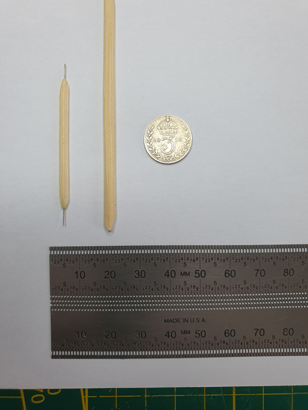

The struts are made from bamboo snack sticks.

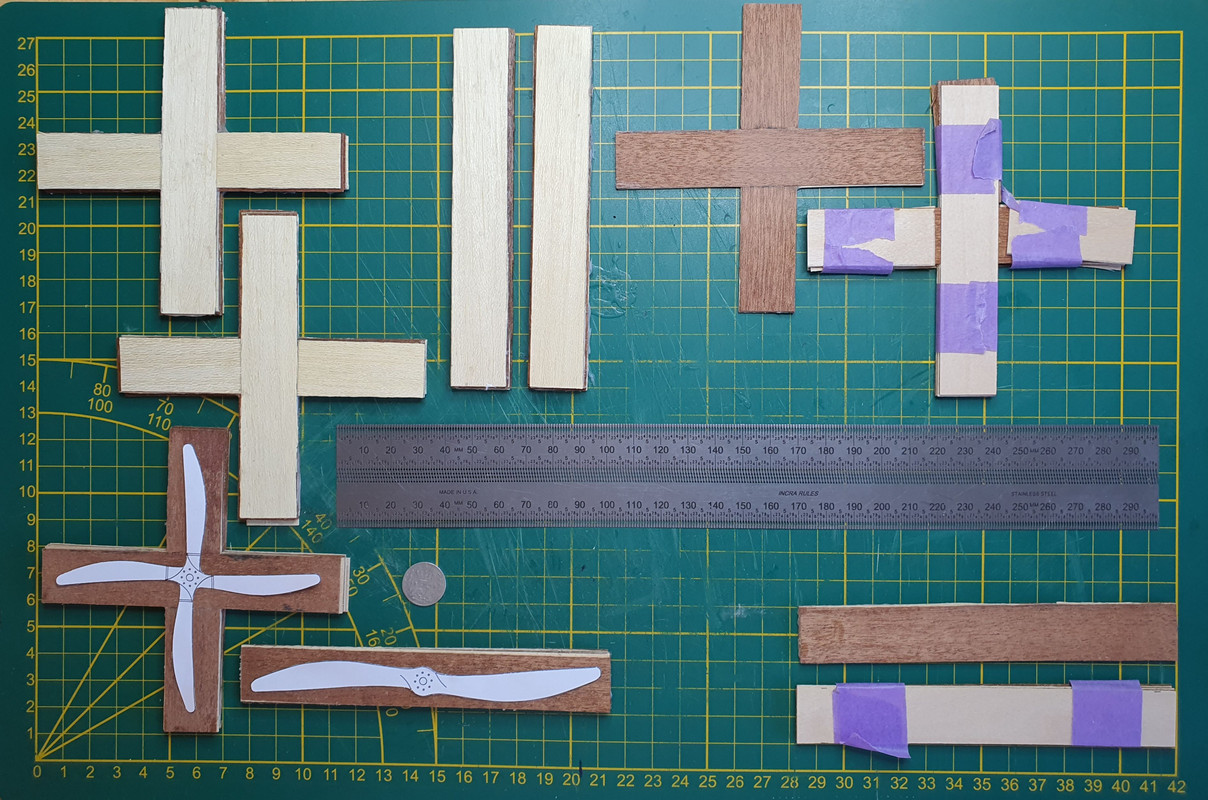

Two member of this forum kindly donated unused propellers from WNW kits to make the 4 bladed variant, but ultimately I decides to give it a go with wood veneer I made two sets of the four propellers, because I know I will mess them up at some point. I have some serious carving to do now.

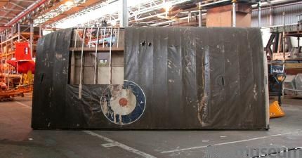

Yes, i know these, but I would need a hell of a lot of them. Meanwhile, I'm still not sure what the ribstitches precisely looked like. The RAF museum holds part of the upper wing of a O/400 and of the tailplane of a V/1500, but the photographs are too grainy to discern what tape or stitches were used. And so far I have been unable to find any old photographs on which the rib stitching can be seen clearly.
Section of the upper wing of a HP O/400 (RAF museum)
(Note how small the roundel is compared to the size of the wing section)

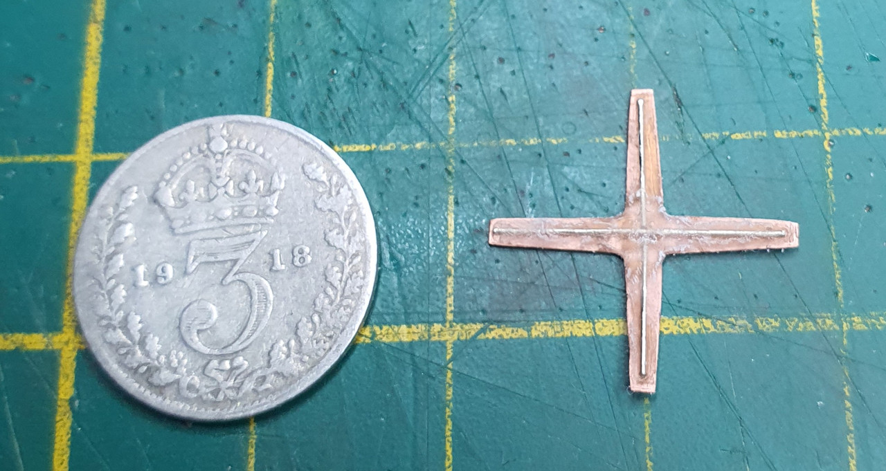

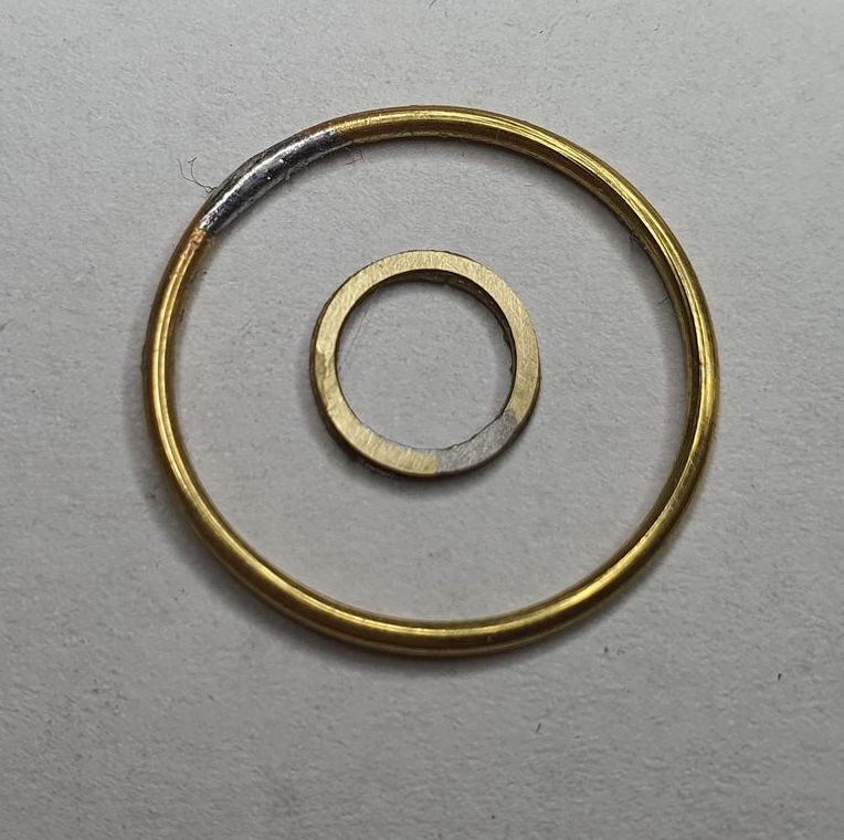

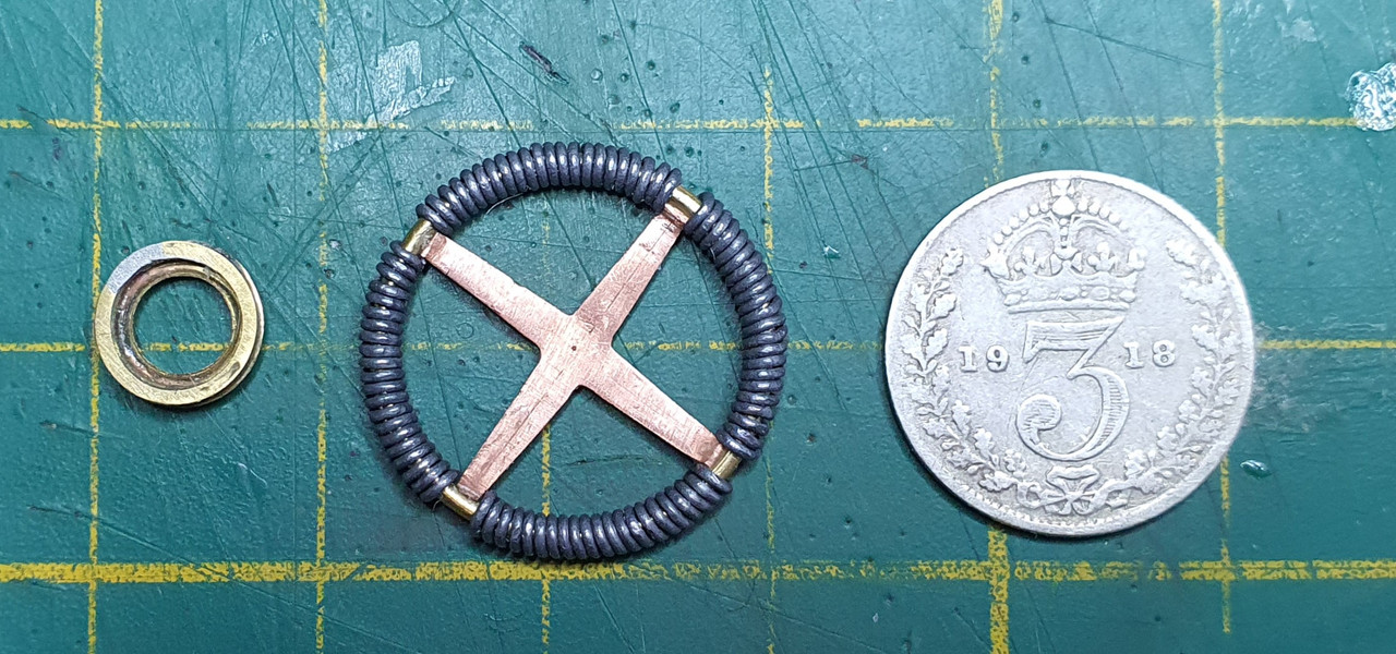

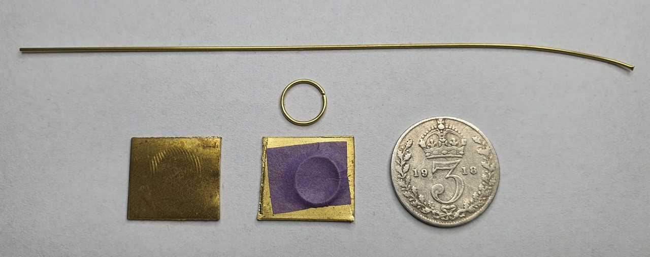

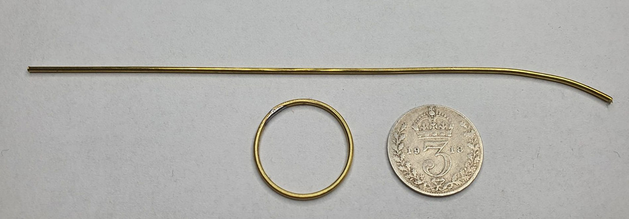

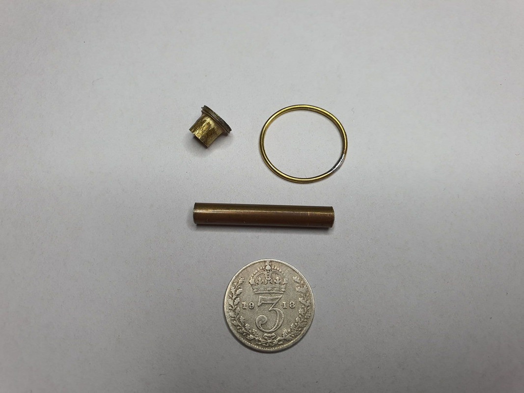

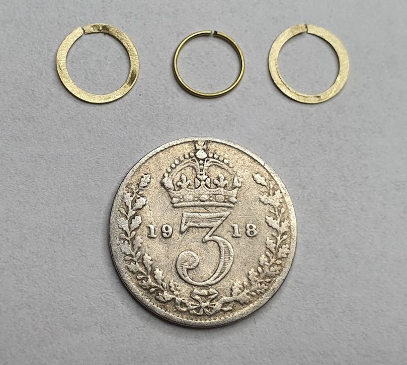

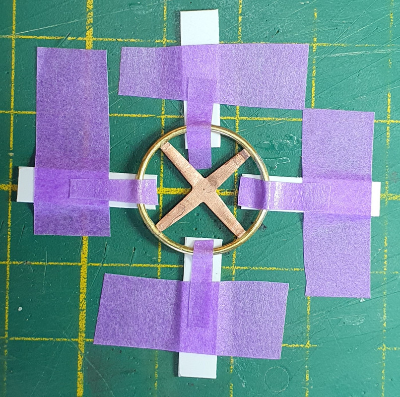

My pace is slow, but I'm making progress. I am working for days a week now, (two days from home and two days from the office) instead of five, which means I have a four-day weekend every two weeks.

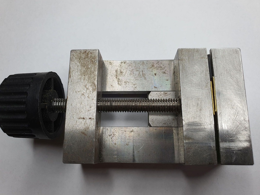

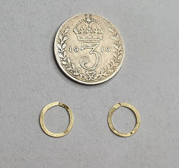

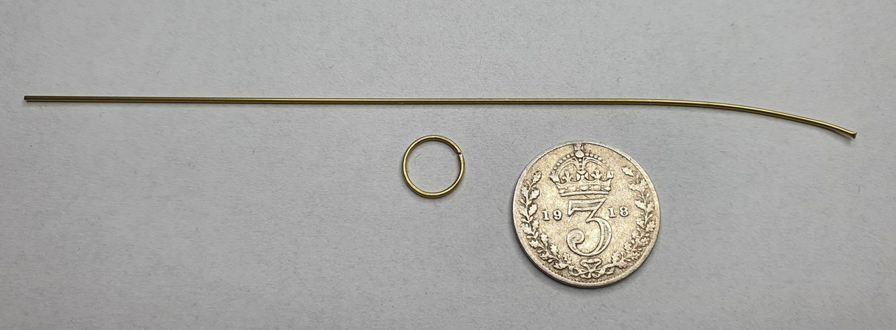

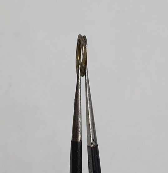

The steering wheel is 24” in diameter (same as a bicycle wheel!) and in the center there is a pulley for the ailerons. The  wheel is made from 1mm brass tube, formed around a drill bit. The pulley consists of three parts: two 0.3mm brass tube rings, also formed around a drill bit and then flattened in the vice. In between these flattened rings is a third ring, also of 0.3 mm brass tube. I superglued these together, because they are too fragile to solder. Also I made the hub that fits in the pulley.
The spokes are made from copper⁹ sheet, which is also glued to the brass. They are not as sleek as the spokes in the original, but after six attempts and five fails, I decided to keep this one.
The windings are made from 0.5 mm Plusmodel lead wire. I was afraid that it would break or disform easily because the lead is so soft, but it worked out well, no problems there.

Re: Handley Page V/1500 scratch build (slowgress report)
« Reply #177 on: November 21, 2022, 02:31:59 AM »
Ah Willem, that is brilliantly clever, the pulley wheel especially. I'm definitely taking notes of that method!
The wheel spokes look perfectly good to me, and winding the lead wire round wheel is another nice touch carried out with immaculate precision. It doesn't matter how slow the progress, it looks like you are enjoying the project and every piece you have made so far is another perfect step towards the finished model. This is such an enjoyable build to follow!

« Reply #178 on: November 21, 2022, 05:35:44 AM »
What is there to criticise about the wheel? That is extraordinarily good, especially as the inner wheel is so small. The spokes look very good indeed - in fact I think that is much better than you would have found in a kit.
