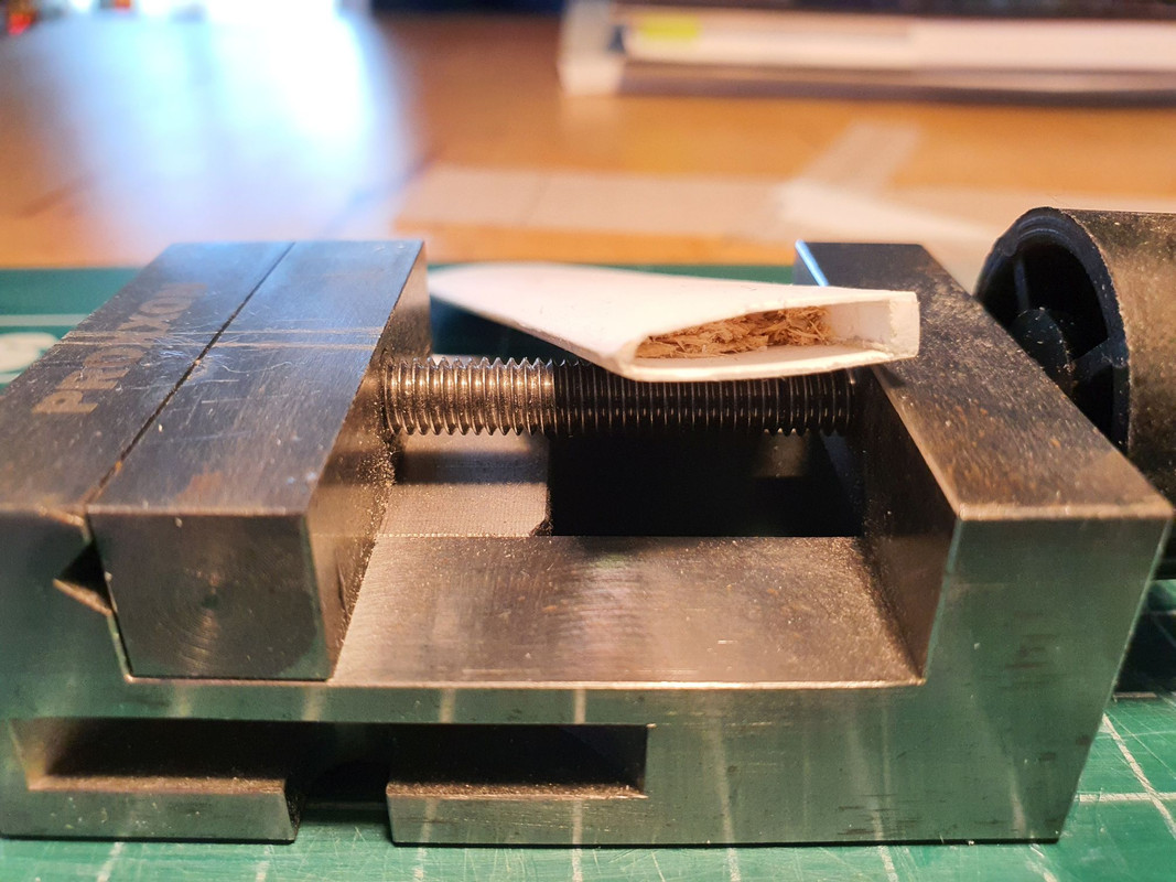

So I gave it a try. I had some 1.5 mm balsa lying around. I glued to strips together using ordinary wood glue and shaped the core of an elevator and then two strips of 0.5 mm styrene around it. The styrene strips are a little wider than they show on the Digmayer plans to allow the the bending of the trailing edge.
I must admit, it was much easier than I expected and I am happy with the result. I am going to make the wingtip the way Ron did for his Caproni. This was just a trial but I think it worked out fine.
