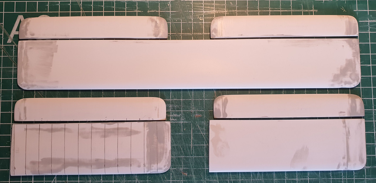

Stabilizers and elevators ready for rib-strips to be applied and to be given a (first) layer of primer. Next things to make are the hinges, the control horns and the slots in the stabilizers for the control cables.

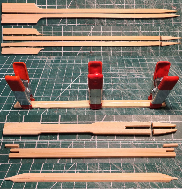

Also been doodling with a concept for a strut. Built up from bamboo snack sticks.

The tail feathers are looking great! The struts should be very sturdy. I am finding bamboo is fairly easy to carve and sand so I am sure you will do fine!

@ Ritchie: I found it hard to get the radius and arc of the wingtips right while maintaining a perfectly perpendicular leading edge. It took me a while to get them the way I wanted. Eventually I got them right with some filling (Revell Plasto), priming (Mr. Surfacer 500) and polishing with a 6000 grit pad.
@ Rick: Working with bamboo was not as hard as I expected, just as long as I use sharp tools.

In the meantime I started  applying the rib tape from Mr. von Buckles. More later and thanks for looking in.

Things go slow, but I AM making progress. I already said that I’m in the process of applying the rib-tape (Bob’s Buckles). He custom made the for me and they are 1 mm wide. That may not seem much, but when they are clear-coated, primed and sprayed in the right color, the will have the desired effect.
However, when a started to stick them on, I found that the control surfaces were far from perfect. The angles were rounded and there were lots of dents and bumps, all the result of sloppy initial work. So, I correct these mistakes as I go along. When that’s done, the tape goes on and will be sealed with a couple of layers of clear coat.
Needless to say, the rudders that Ron Kootje casted for me are perfect. Only the leading edges need to rounded once I have separated the rudders from the guides.
I chose to glue the four elevators to the control surfaces and then spray them. I’m afraid they are too delicate to handle once painted. The hinges (three on each elevator) are strips of 0,5 mm copper sheet, 4 mm wide and 8 mm long.
