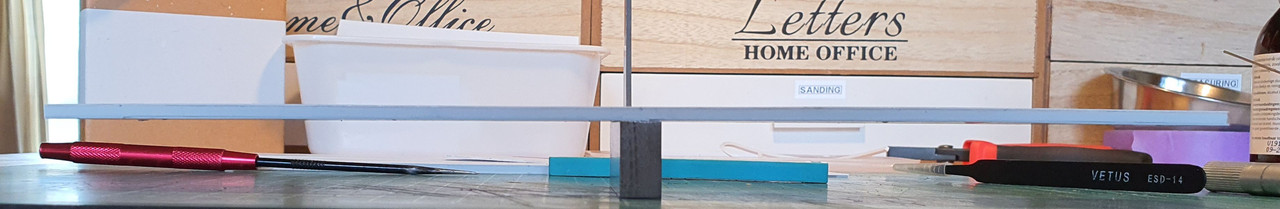

I'm calling it a day. I have everything glued. The top tailplane is surprisingly light and sturdy.
No sagging so far.
Tomorrow will be a day of tedious work. Filling and sanding everything down to the right shape.

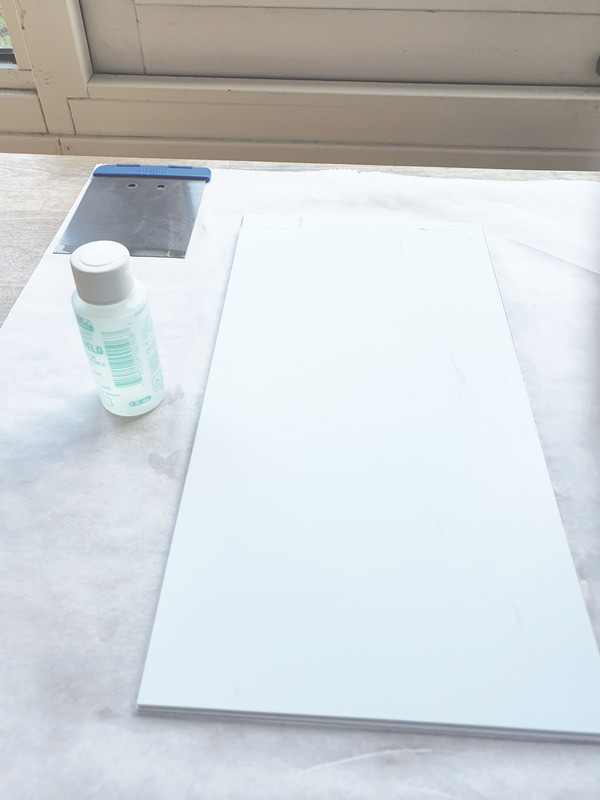

I have abandoned the silicon mould project. The layer being this thick, it takes about three light years to dry. So I freed the rudder from the silicon-slush and made a mess of the kitchen counter top while doing it and spreading a vinegar odor throughout the house. When it is fully dried I hope I can peel the silicon rubbish off and try method number 2 with the Blue Stuff/Oyumaru. Less messy and reusable.
Making a new start with the tailplane too. The parts I did yesterday will be re-used at some point of course. On scale everything is 3 mm thick. So I glued a 1.5 + 1.0 + 0.5 Evergreen sheet together with Micro Weld. My wife didn't really like the combination of the two smells of silicon and glue, but we're still on speaking terms.
