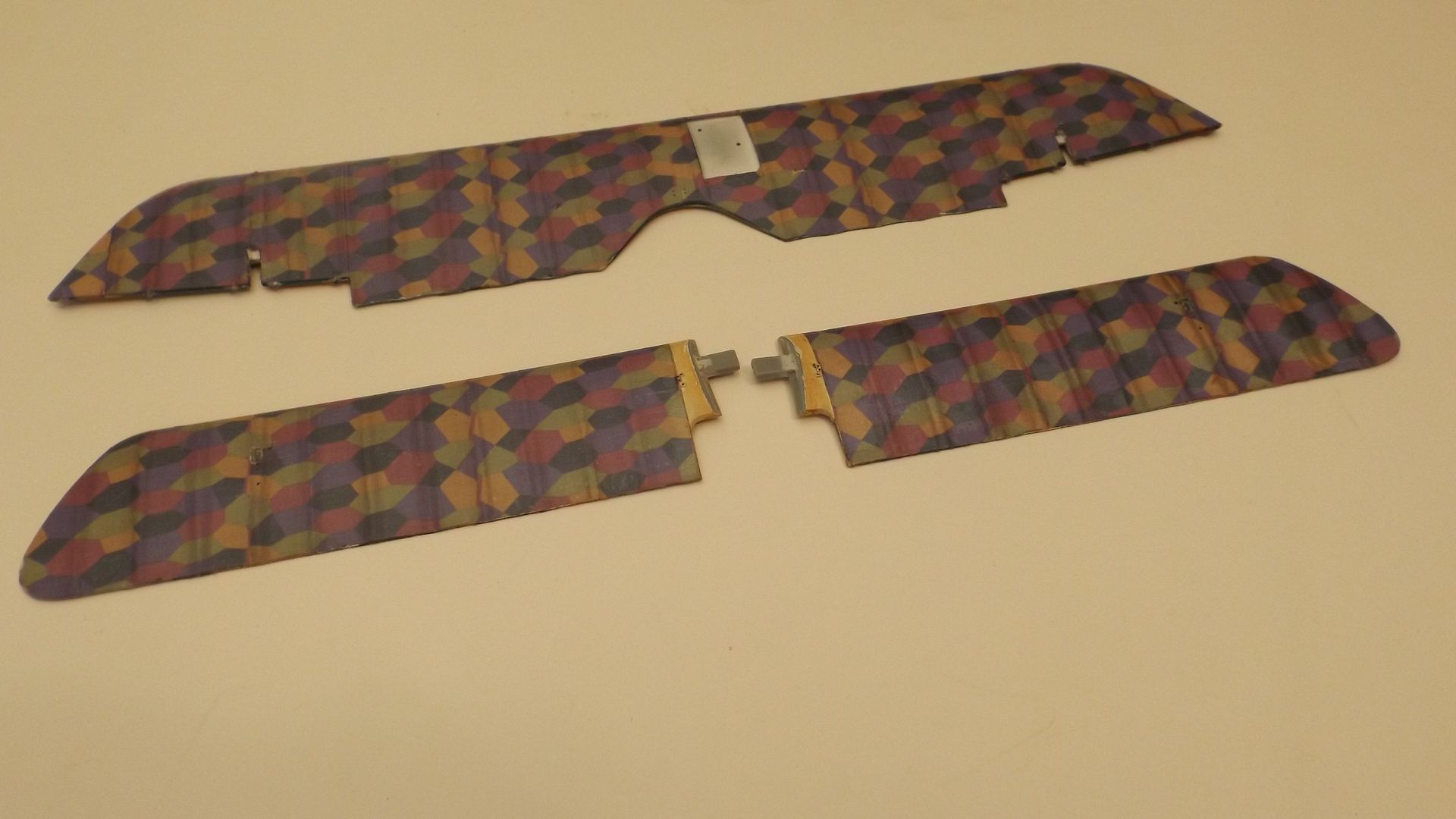

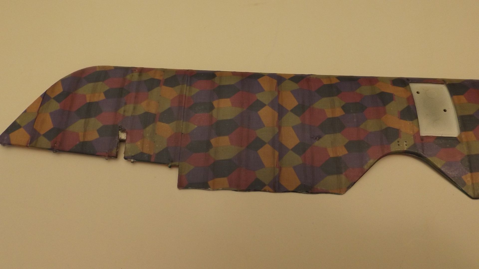

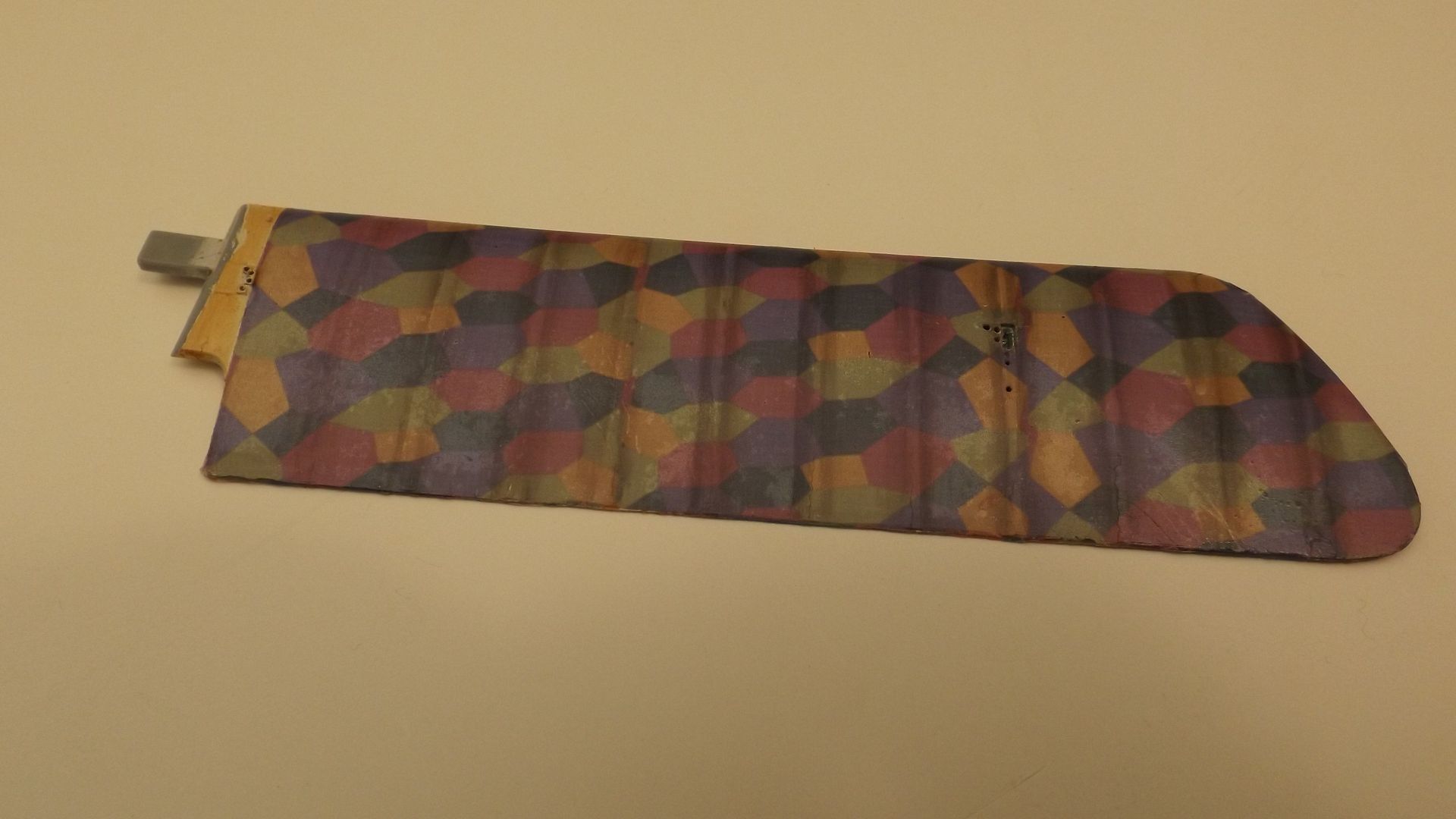

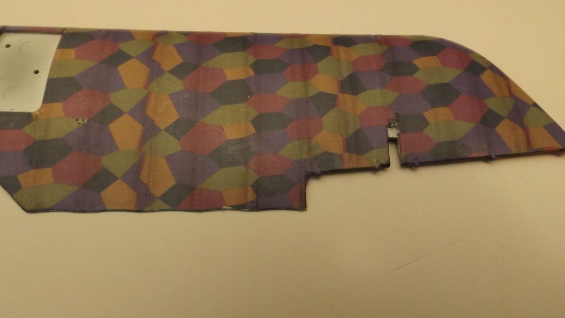

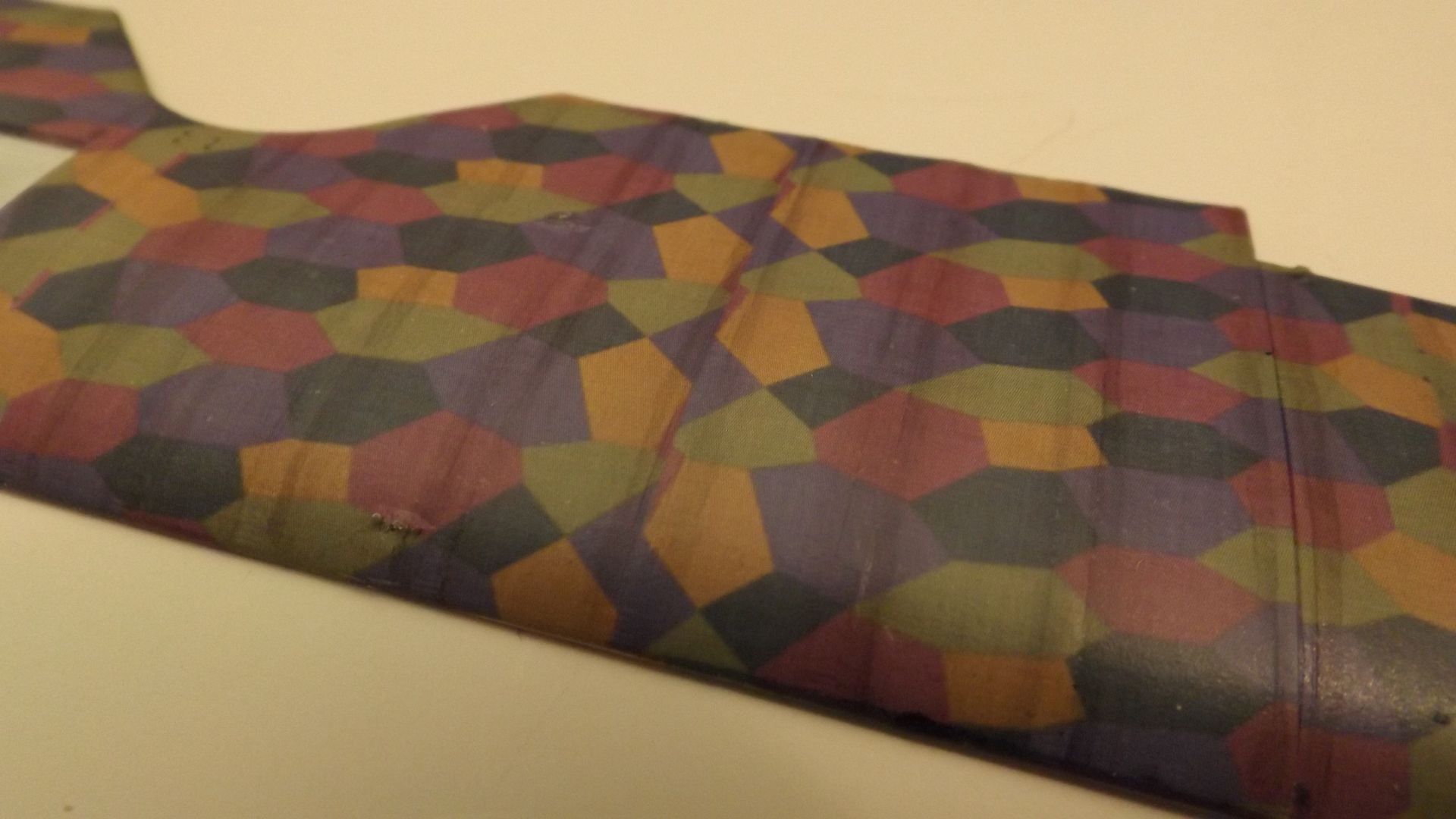

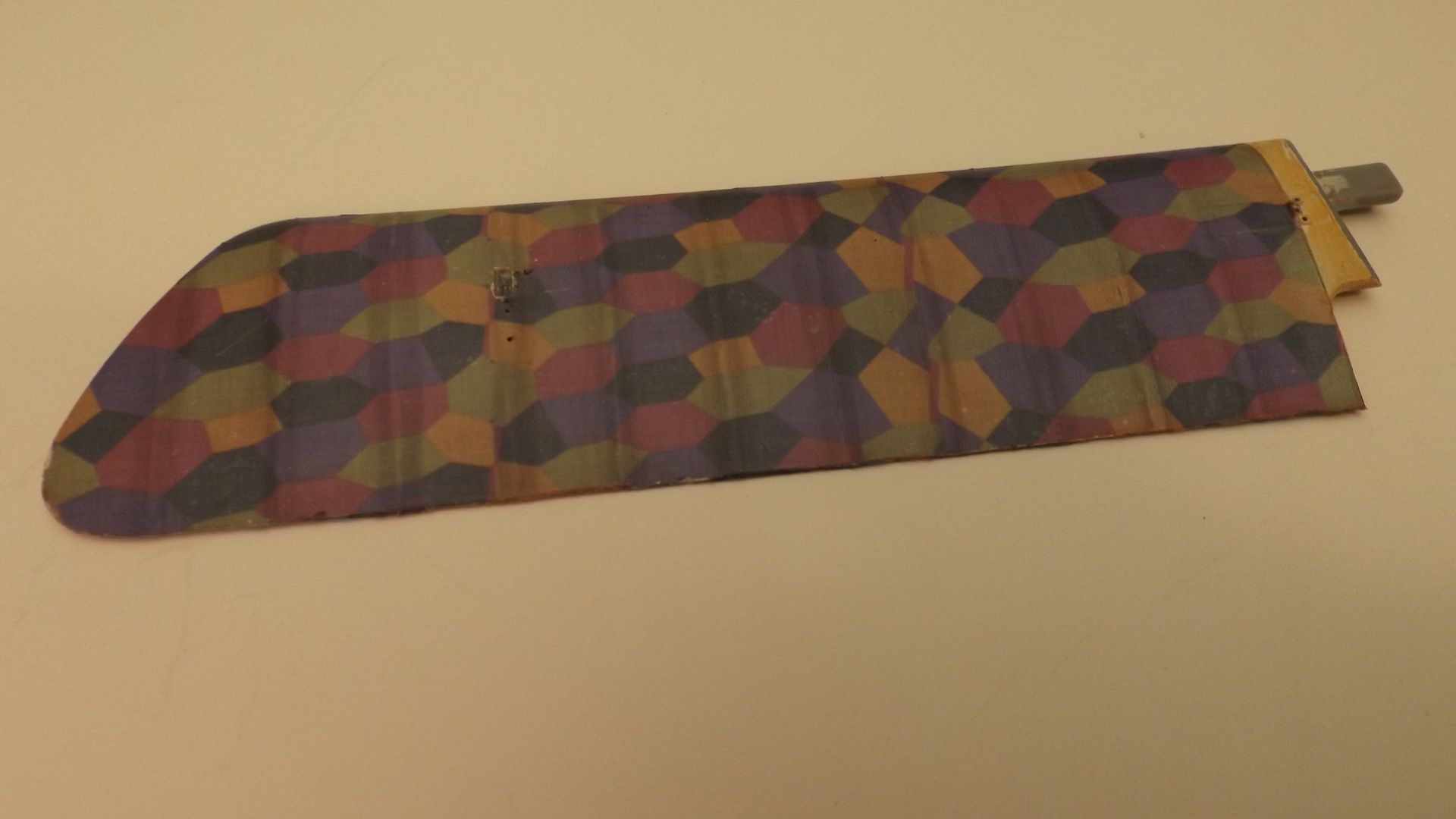

Thanks for the kind comments! I have now put the Lozenge on the uppers. There are a few glitches on the edges but fortunately the tapes will cover any sins. I do have one difficulty which I am sure is self created. When trying to trim off the overlap the elasticity of the film doesn't allow a clean cut. The film seems to stretch instead of slicing off. I know of no one else having this difficulty so what am I doing wrong?
Here are the pictures:

   You are not alone on the difficulty trimming this stuff. By coincidence I have spent the better part of the past two days applying Aviattic's Lozenge to the flying surfaces of the Fokker DVII (OAW) I'm working on. I'm amazed at how tough and thick this stuff is, and yet it still snuggles down over detail as well as any Decal I've ever used. I'm using brand new #11 Blades to trim the stuff however, discovering the "elastic" qualities of it with the very first piece, I'm now trimming and cutting to an "anal" degree before applying it to avoid the challenges. I've tried files and sand paper, no go!
  I'd say work ahead on the trimming in the dry fit stage to reduce the trimming requirement post application. This product is definitely new to me, and I'm surprised there haven't been previous remarks on this topic.

Rick, the wings look fantastic!  To keep the decal from pulling, replace the blade the very instant it begins to pull, Amigo.
« Reply #131 on: April 16, 2014, 03:18:32 PM »
The wings are looking fantastic Rick. Have you tried trimming the decals with a brand new No.11 scalpel blade, these are a lot sharper than the No11 exacto blades, just a thought.

Thanks for the input and comments Lance! I think you have hit on the solution. Measure TWICE and Trim NOT  8) As long as the bird you are doing has tape on the trailing edge it wouldn't matter if you left a thin uncovered line at the rear of the wing or the very thin edge uncovered!
