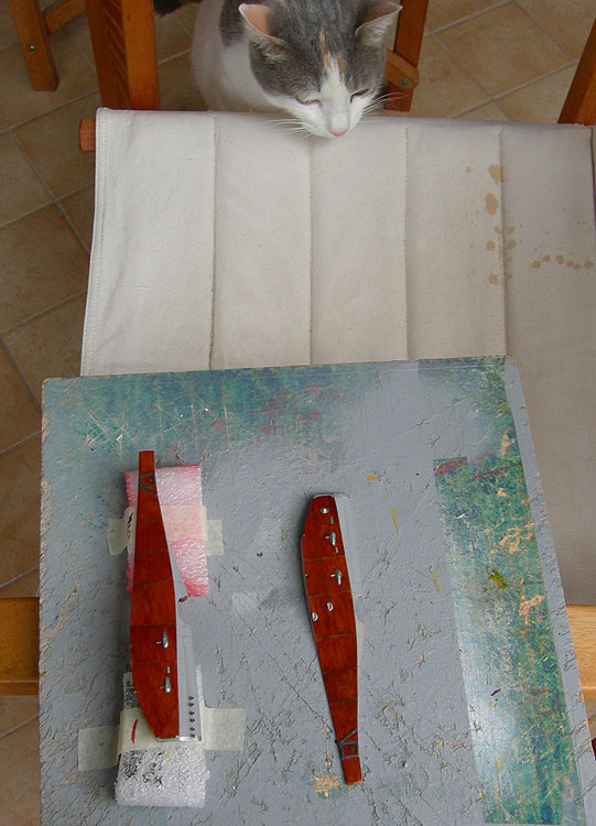

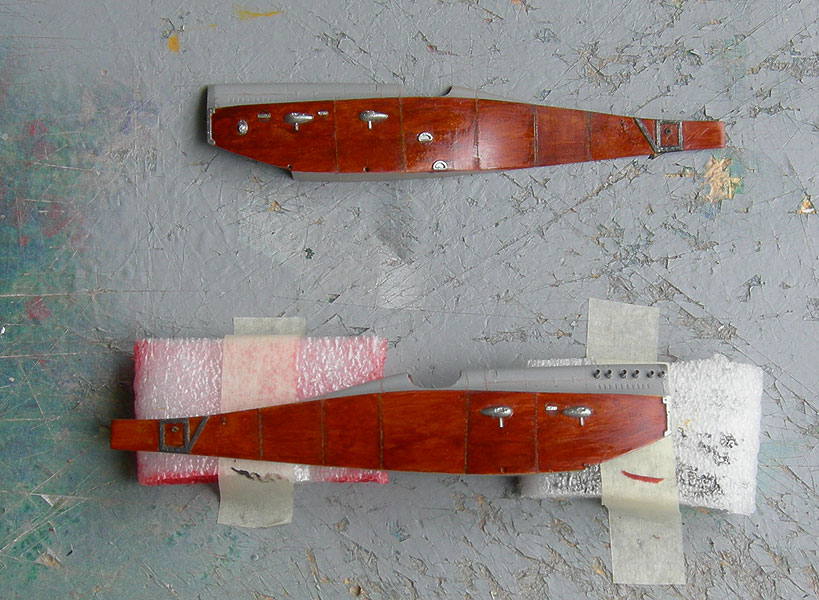

Woodgrain painted on the vertical panels of the fuselage.
...oops an unexpected visitor wanted to check...
 ^_^

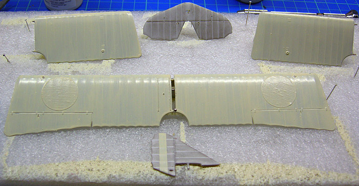

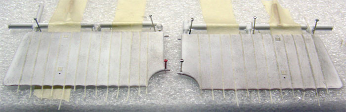

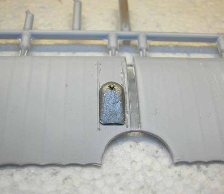

I fixed 2 thin plasticard rods on top of the top wing to make the guides holding in place the gravity tank.
The tank in the photo is just laid on the wing to check the distance between rails.

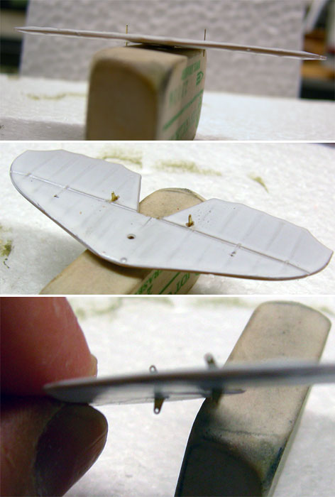

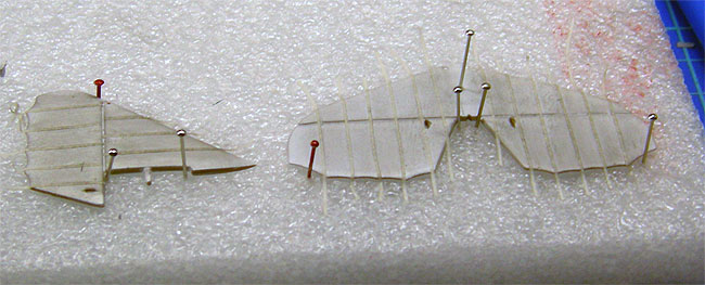

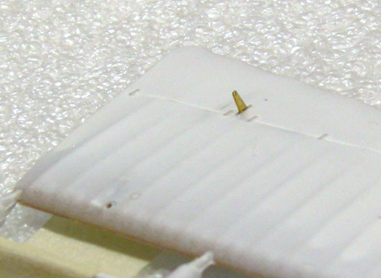

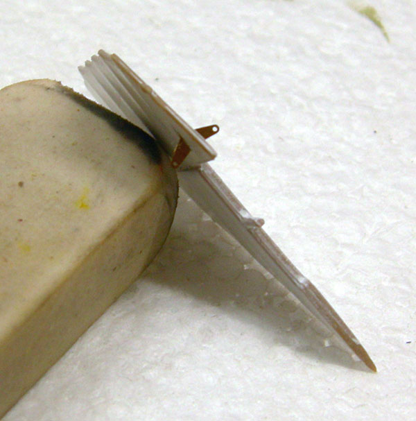

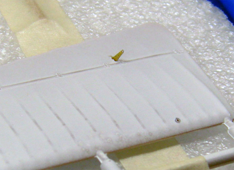

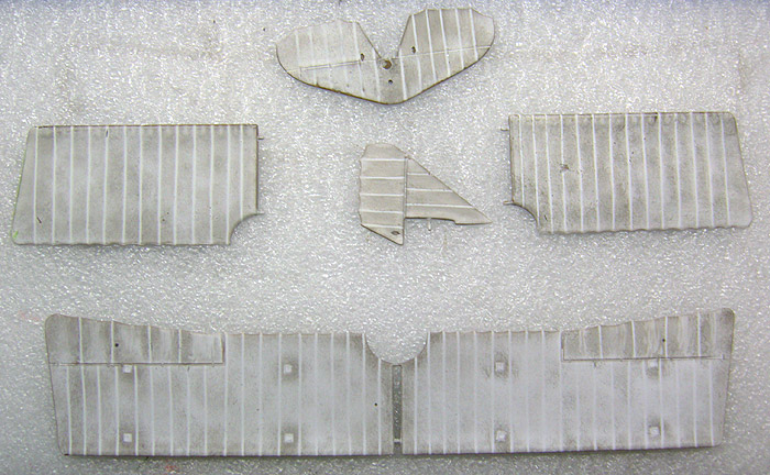

Some work is shown below: I needed to drill the pieces where control horns will go (I took them from a generic "PARTS" ww1 elements photoetched fret)
Rudder
Horizontal tail planes
Top wing
Left aileron
Right aileron

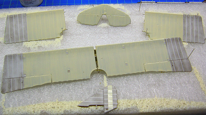

Yesterday night I started preshading the wing to enhance the ribs (using my usual India ink technique) before laying the CDL colour
That's all for now, things proceed smoothly enough so far.

I like the woodwork very much Antonio. Great work. I like the cat too!

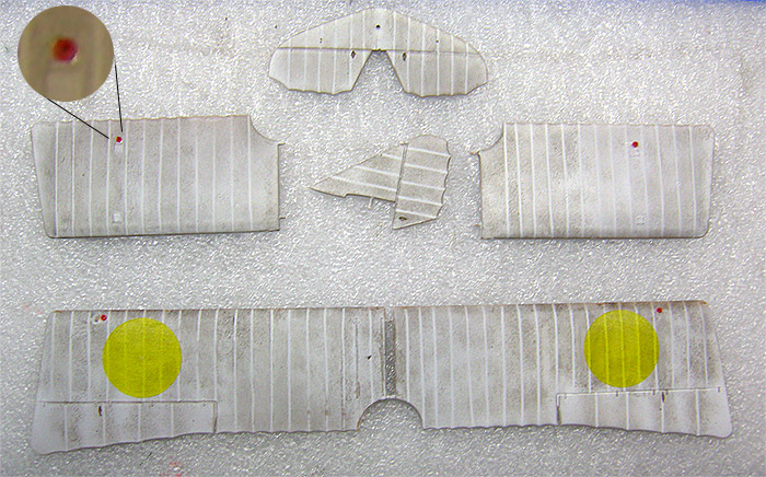

I shaded the wings and the tail planes and removed the masking tape.
The red dots are tiny slices of electric wire coating (see zoom top left) I cut and glued to the wing to simulate the rim of the hole where the control cables come out
In yellow the masking tape for the roundels on the upper wing: I decided to apply the decals over the shading so that the shading itself will be visible from below. If I had painted the roundel place with CDL it would have dimmed the effect.
On the port lower wing (appearing on the right in the picture) there was one rib more (13) than on the starboard side (12)!  When I realized that I had nearly completed the work so I decided to leave it as it is...
Here are the lower surfaces. I left blank the reference points for the struts.
Here the CDL work is complete on the top surfaces...
and on the bottom ones
I left blank the surfaces where the tricolore (red / green) will be painted for the same reason I masked the decal places: the color has to show the shading.

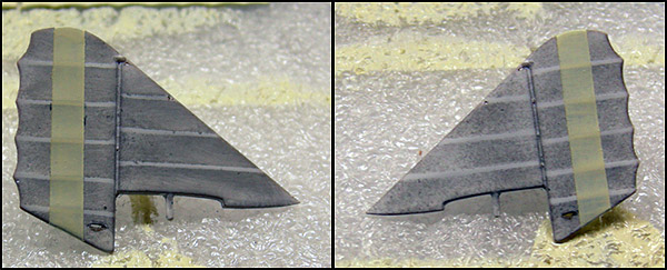

This is a detail on the fin/rudder: same idea of leaving blank the parts where the fabric was overpainted with the tricolore.
The "white" stripe between red and green was not painted white but left in the raw fabric colour.
Next step is painting the red / green areas then print the decals and apply them to wings tail and fuselage.
