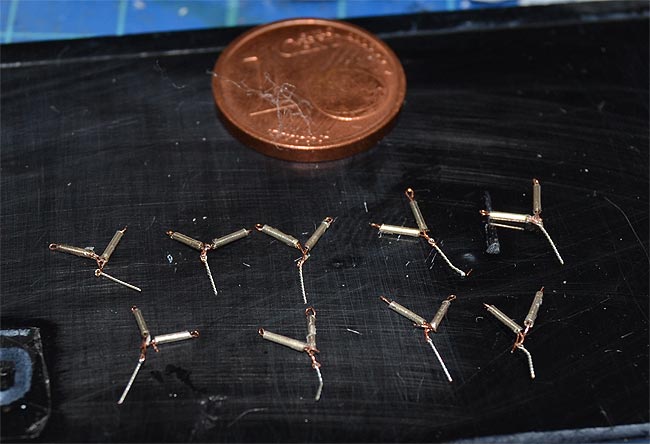

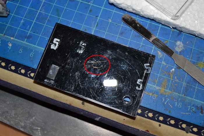

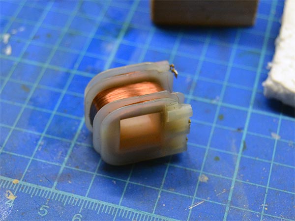

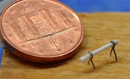

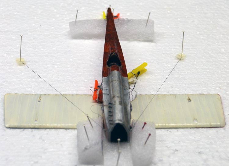

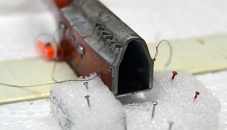

Thanks Zabu, here are some new progresses:
some time ago I took a coil out of an old phone, now it's time to use it.

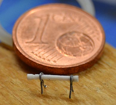

The wire is as thin as a hair and I decided to use it for the eyelets of the turnbuckles I posted the drawings some days ago.
They're so small that it was difficult to photograph even using the "Macro" program of my camera. The tube chunks are 3 mm long. You see them better in this magnification pic. On one end is the eyelet done with the "electric hair", on the other end the same wire comes out of the tube and is glued to a Bob Buckle's eyelet that will be fixed to the model

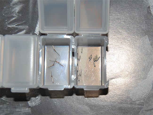

Here you can see 4 of the 6 turnbuckles done this evening in the left box and the remainder of the tube chunks in the right one.
I need 8 of them and I just made 6 today. To make the first one it took me over 1 hour to understand where to put the drop of CA glue, much less time was spent on the other 4.

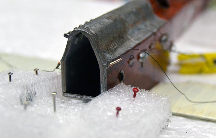

To check if this hair-sized wire would bring the strength of the stretched rigging I glued two turnbuckles on the plane's "cheeks" and stretched the EZ wire...
It seemed to work
Detail views here

I completed the set of "single" turnbuckles (now I have 9 - I need 8)
and started making the "twin" turnbuckles (instead of doing two holes I thought that where it is possible having only one is better...)
Here they are (I have 9 - and I need 8)
