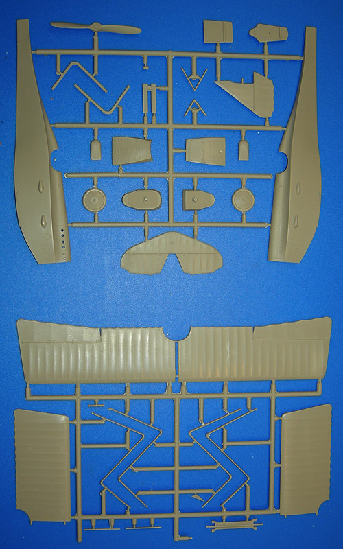

Hallo everybody,
I decided my next work: I received this from a French friend as a "Christmas Exchange GB", in exchange I sent him a Resin Ardpol Pomilio in 72.
The SVA5 was the plane with which I started my new modeling life but the kit was a dreadful SMER, this is a FLY and appears to be much better.
Usual preliminary pics:

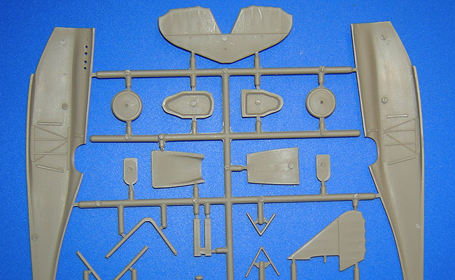

The decals look good, the print is neat and in good register. The colours according to my opinion are too bright.
The detail of the plastic pieces is fair enough, although the panel lines are not enough visible (they don't even appear in the picture).
I was also thinking about "riveting" the joint lines... but so far I don't remember any picture in which the rivets (or nails, better) are visible
The cockpit structure is molded on the inner side of the fuselage, I don't like it very much but I will check whether to leave it as it is or not.

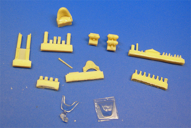

Resin pieces appear good enough, except the Vickers MGs. I will use photoetched parts.
Anyone can suggest "ready made" Vickers MG of good quality in 48th?
The belts are molded on the seat cushion, but appear to have a good detail definition. Although I was thinking about a scratch built seat or a PE one, will see what to do looking at it after spraying some primer.

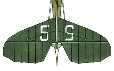

The 3rd picture shows the no.5, closing up the fin: the colour shade is darker than the green band of the rudder so I will choose a darker shade of green.
Although this was not his personal plane he flew that plane over Vienna in the legendary raid led by the Italian nationalist poet Gabriele D'Annunzio in August 1918
Here is the correct profile:

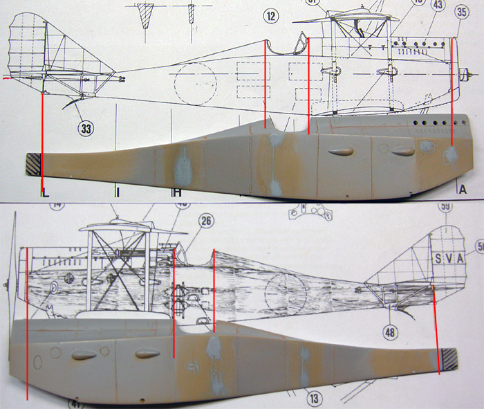

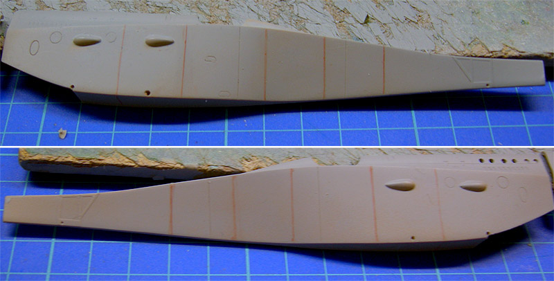

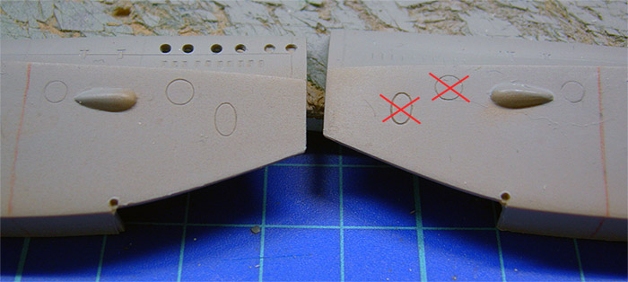

Hallo gents, I finally weighed anchor on thursday, national holiday here in Italy (as well as in AU & NZ) and, after spraying primer on all the pieces (white on wings and tail surfaces, gray on the rest of the pieces) I essentially worked on the fuselage external parts:
First of all the panel lines were totally wrong and I traced the correct lines with a brown pencil...
The inspection panels in the kit appear equals on both the fuselage sides while on the port side no photo I have in my documentation shows all of them, just the small one.
The vertical oval panel is just a sort of basis for an air intake which was only on the starboarrd side. It was removed on later SVA5 versions.

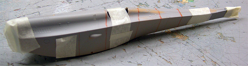

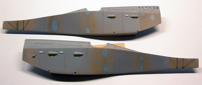

Checking the pieces on some drawings I found on the web (in 48th) I noticed that taking the cockpit opening as a pivot, the fuselage is longer than it should be.
I decided just to work on the tail because to work on the nose it would be such an heavy work... I should change too many things, to me is nearly impossible...

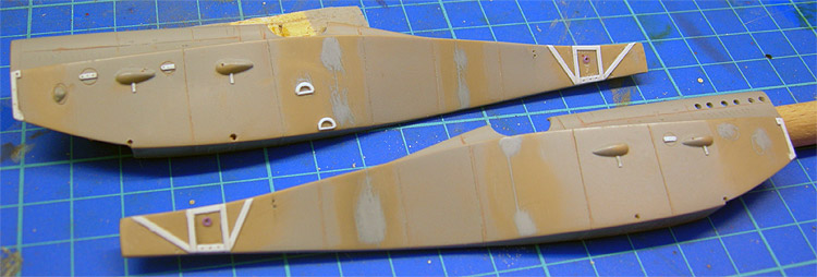

Here is the fuselage at an intermediate stage, you can see I re-traced the metal framework the SVA series had on the rearmost part of the fuselage (of course this was due to the heavy shortening of the fuselage itself)
The new panel lines here are traced with a scriber and the old ones were filled with putty as well as the wrong inspection openings on the port side.

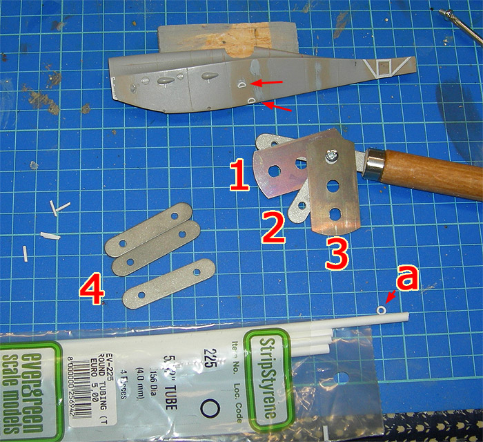

I had to build the steps giving access to the cockpit because those on the kit were carved while in the real plane they were a sort of metal rimming to the step opening...
I used evergreen styrene tube (4 mm  O.D.) cut in thin rings (a) with a JLC combo saw with a 0.5 mm extender (2) and two parallel blades (1 & 3) .
I bought from UMM their 15 "Years Anniversary Saw Pack" which comes with 3 spare blades and a set of different extenders (0.5 - 1.5 - 2.5 and 2x1.0 mm). This was the first time I use it and I found it very useful and easy to use...
Here is how the two fuselage halves look just now. I have drilled holes for the rigging.
I also used 2 slices of the rubber coat of an electric wire to rim the holes in the rear part (exit point for wires commanding the rudder).
