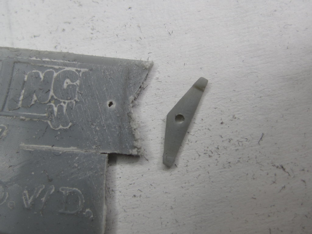

Of course, two rudder horns were also needed.
I again used Wingnut Wings scrap plastic to carve the rudder horns.
A nice detail on the side:
In the German forum, Frank (You all know him as @Bughunter) commented that he would be very afraid to use plastic at this point.
He would advise me to use metal in this case.
I know Frank's build reports, he is the uncrowned master of soldering and finest metal work on his models.
I told him, soldering is not necessarily my world, I do better with plastic.
Well the truth is, I lack the tools, the skill and probably the patience to achieve such an excellent result as Frank, the boss of miniature soldering.
 ........ well, unfortunately he should be right - one of the hinges broke a few weeks later when I was working a bit carelessly on another part of the model.

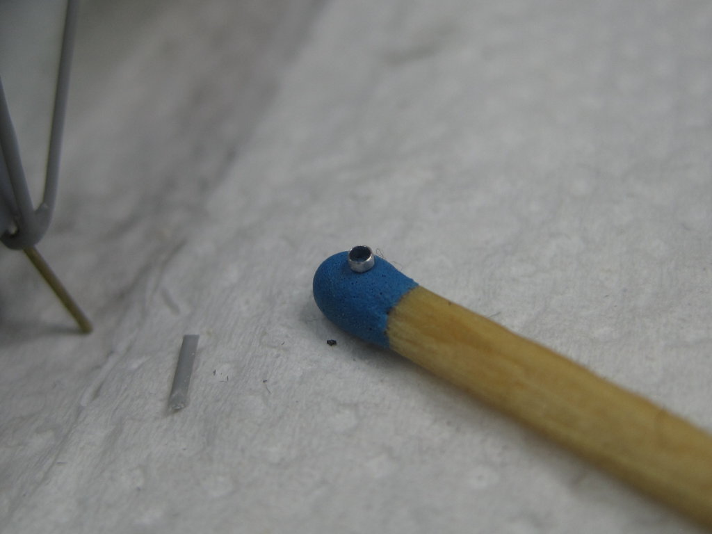

The elevator was now mounted movable, it could be moved from top to bottom and back without problems.
Now only the lateral play had to be eliminated, then it would fit perfectly.
Here I helped myself with custom made bushings, which were made from a thin aluminum tube.
These bushings are not glued to the finished model, it is sufficient if they are simply pushed over the brass tube as spacers.
