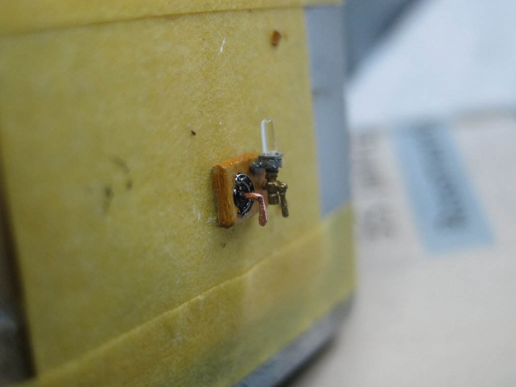

The next instrument in the cockpit is a pulsometer.
This small and very finely rendered instrument is from Taurus.
A bit of paint, a fuel line made of painted copper wire, a selfmade wooden board, plus a shut-off valve for the air pump.
Nothing more is needed.
Servus
Bertl
Offline Umlaufmotor
  • Posts: 1268
Re: Morane-Saulnier Type "N", Special Hobby 1/32
« Reply #156 on: May 22, 2022, 06:09:48 AM »
The pulsometer-board is mounted on the left side of the cockpit, above the air pump.
Servus
Bertl

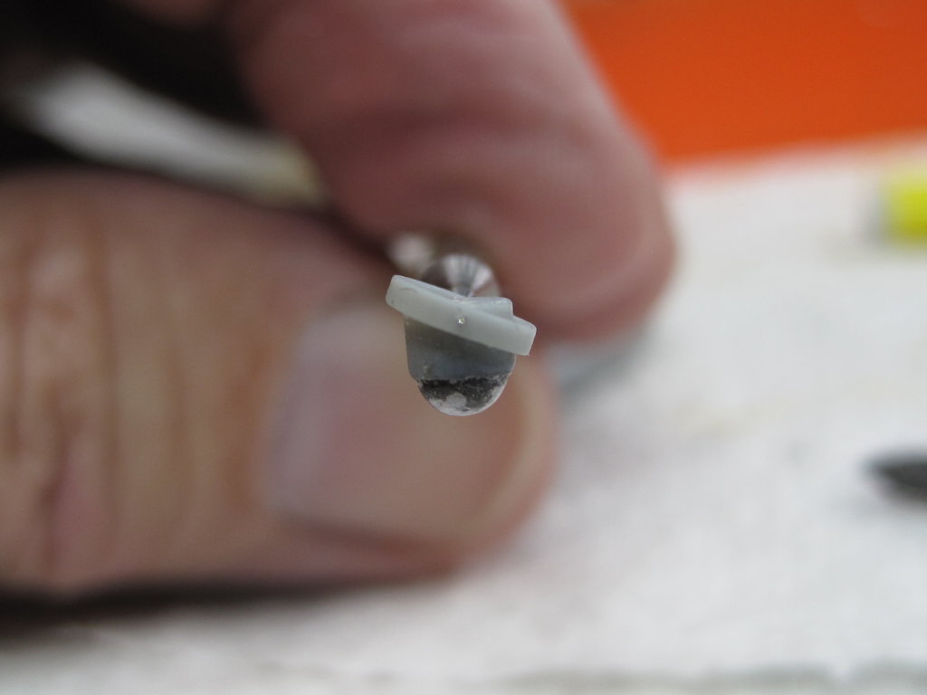

The future housing was provided with a 0.4mm hole on the side
I inserted a 0.4mm brass tube into this cross hole as a bearing....
Later a wire will be glued into the tube, therefore the tube must be re-drilled again with a 0.2mm drill.
Now the lead ball is glued in place.
The housing is almost finished ... almost.
Servus
Bertl

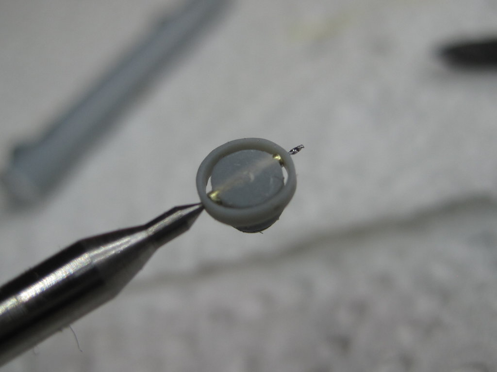

The compass housing is now inserted into a ring in which it is movably mounted.
The material for this ring - of course, again waste plastic.
The steps are almost the same as for the housing.
Servus

The principle can be seen in the following pictures.
A CNC drill inserted through the brass tube serves as the bearing shaft at the moment.
Servus
