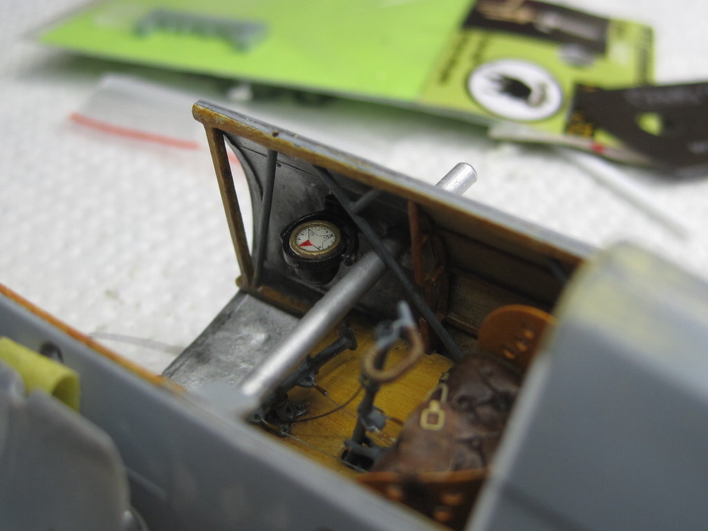

This is the place in the cockpit where the compass will be mounted later.
The mounting is done quite at the end before the fuel and oil tank are fixed.
Damaging the compass otherwise seemed very high to me.  :-\
So, I think that's enough with the compass for today.

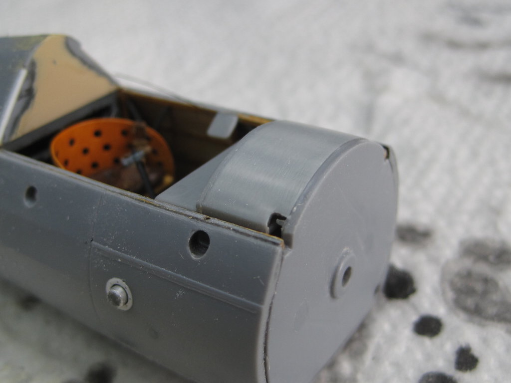

The tank is fixed in the cockpit at the later installation position with Tamiya tape.
After that, the fairing is put on.
The opening of the filler neck can be seen on the fairing.
There, the position on the tank is marked with a drill to be able to install the front wall of the fuel tank at the correct position.

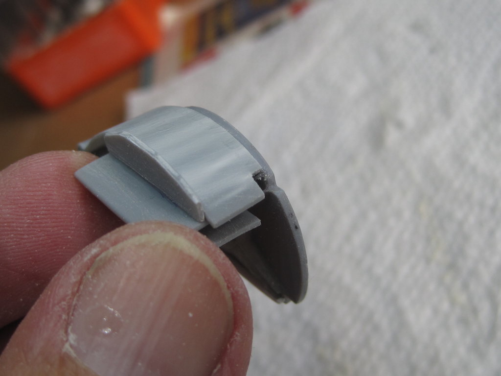

The front wall of the tank is glued on.
After a position check, the top side of the tank is adjusted to the inner contour of the fairing.

The glued seams are sanded with a file and sandpaper.

To make the gas tank look as real as possible, small rivets were depicted.
The oil filler neck is also in place.
In these pictures you can see very well how thin the upper sheet metal covering was sanded.
