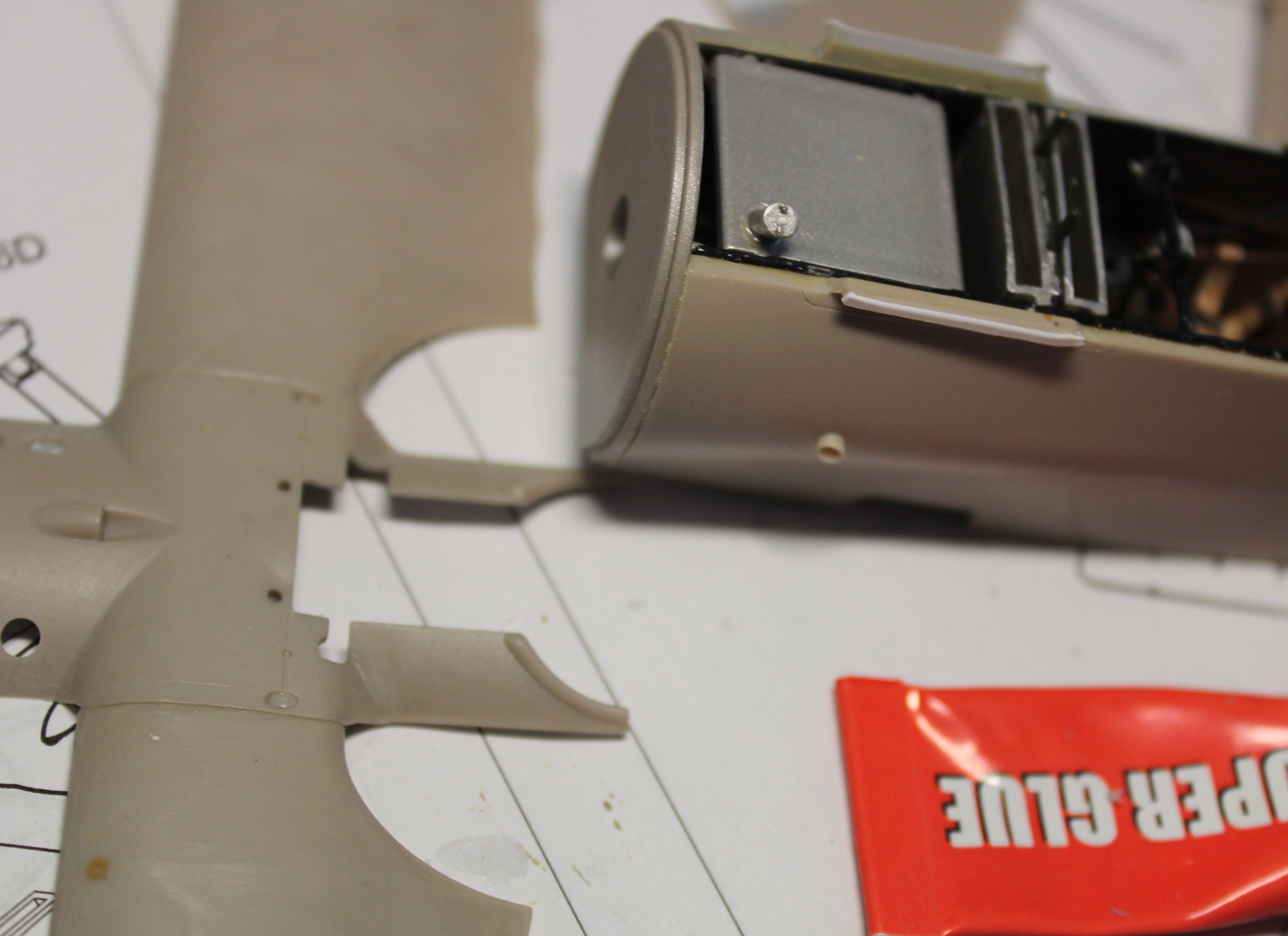

So, some progress... I decided to mate the wings up to the fuselage, just dry-fitted, to check all the alignment and make sure it looked like a Dr.1... and here I had a few surprises.. suddenly the wings weren't exactly parallel when viewed from above. and it seemed to be the lower wing that was throwing everything out via the  wing struts... there was also a small gap where the middle wing under-surface met the fuselage...
The tailplane is dry-fitted and the fuselage seam needs attention. No one has really commented on the different plastic colour of the two fuselage halves.. well, I lost a fuselage half (put it in another kit box) and thought the kit was history... then another kit came up for sale really cheaply here in SA so I nailed it... and was surprised to find the plastic colour completely different! I subsequently found the other fuselage half, so there will be another Triplane! So on with the build! The best wing fit was the middle wing but I needed to fill those gaps on the lower surface - so I cut strips of 10 thou plastic card and glued them to the fuselage stubs, seen here in the photograph as white strips...

Thank you Rick, Terri, Giuseppe and Frank for checking in! Your encouragement is so appreciated! And after a lot of dry-fitting and fiddling I worked out that the lower wing fitting was indeed the problem... it sat too high up in the fuselage and put stress on the struts and threw the alignment out too... I added a 10 thou piece of plasticard on the upper surface of the cross strut and suddenly everything seemed to fit so much better... seen here...
... and I could instantly glue the lower wing in place with little problems and the interplane struts now fitted perfectly... Here the upper wing is dry-fitted and I'm happy so far.. I only need to glue those struts in very lightly as the fit is now so good... You can also see lots of putty and ongoing gaps on the lower surface, with Rick's invaluable help a plate will be added over the lower wing spar and a hatch underneath the forward fuselage... I feel things are taking shape...
