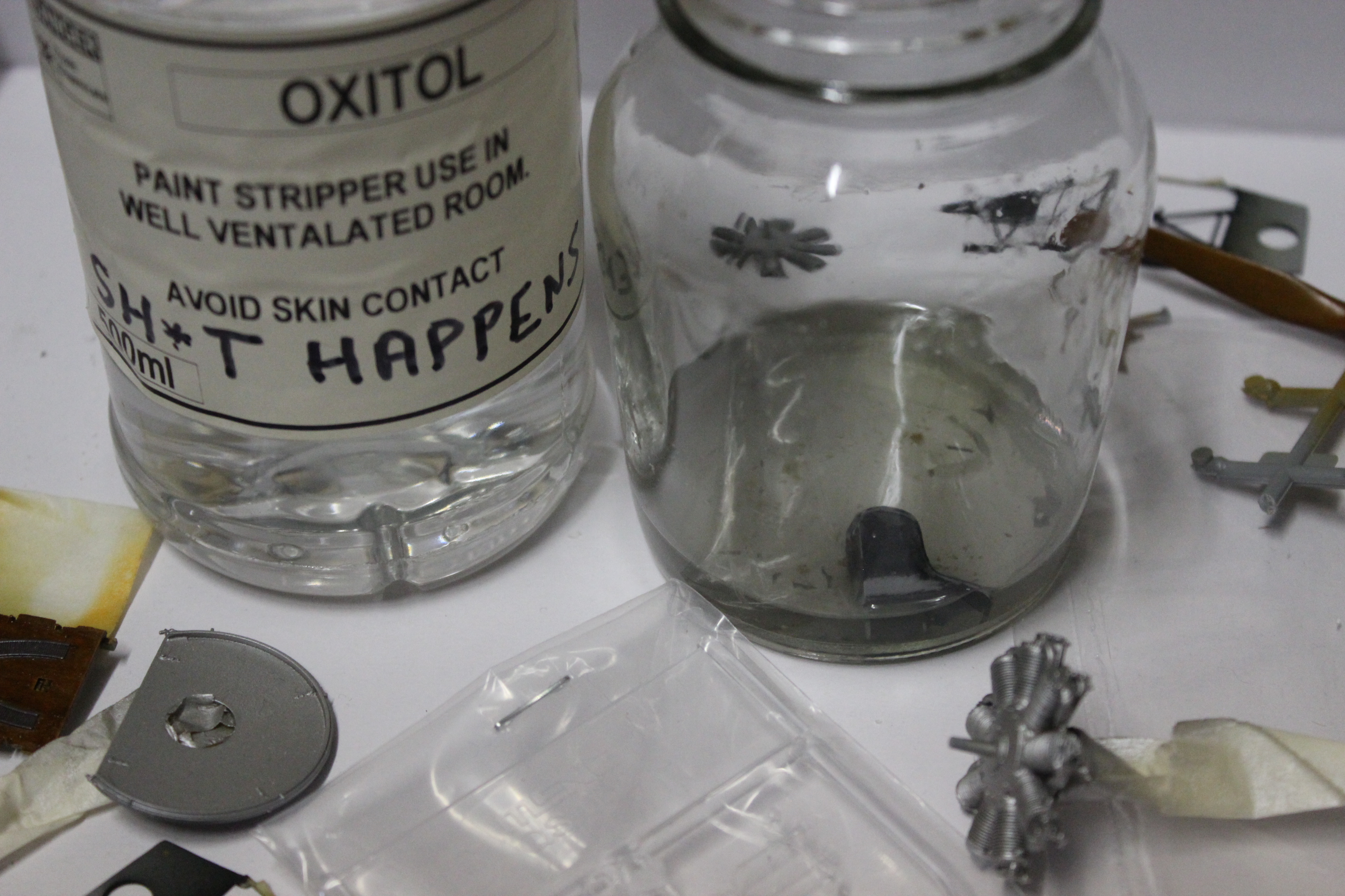

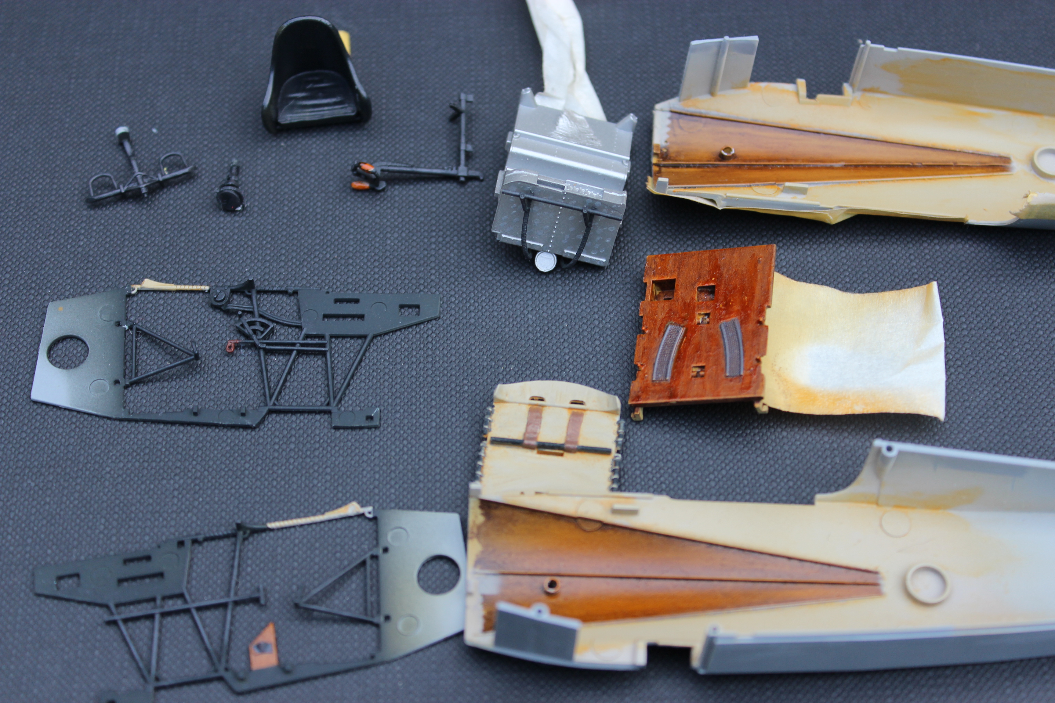

Thank You everyone for your replies - this time so many comments! I am very grateful and find the interest and advice really helps... Today I had some time and worked on the Meng Triplane instead, no real reason, it just took my fancy! I did a lot of interior painting, I know the triangular side fairings should be red-brown, but wood tones are close and look pretty... The control column could be better thought out and a better moulding but I suppose will do. The wooden floor I distressed a bit... but the black leather on the seat was a total foul up and out comes the paint stripper and repeat! The visible ejection pin markings on the fuselage halves won't show... I checked... But I did have some good times, and it is a really fun kit to get together... (I got a second one... don't tell on me...)

Well, the seat from the Meng kit was so badly painted it took a bath in paint stripper, this one is a commercial one, quite toxic I'm sure, but I discard it appropriately after use and take care... it works quickly and thoroughly on any type of paint and doesn't harm the plastic...

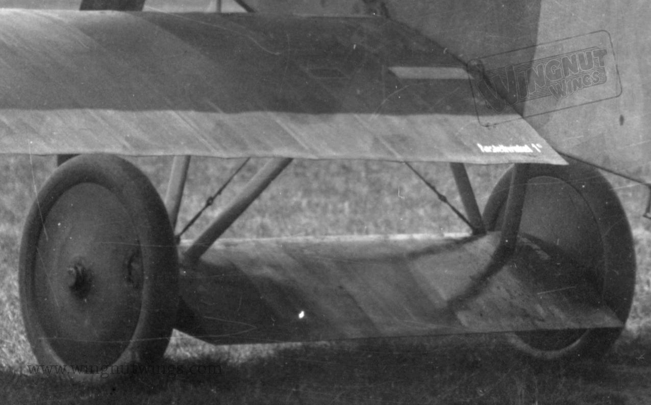

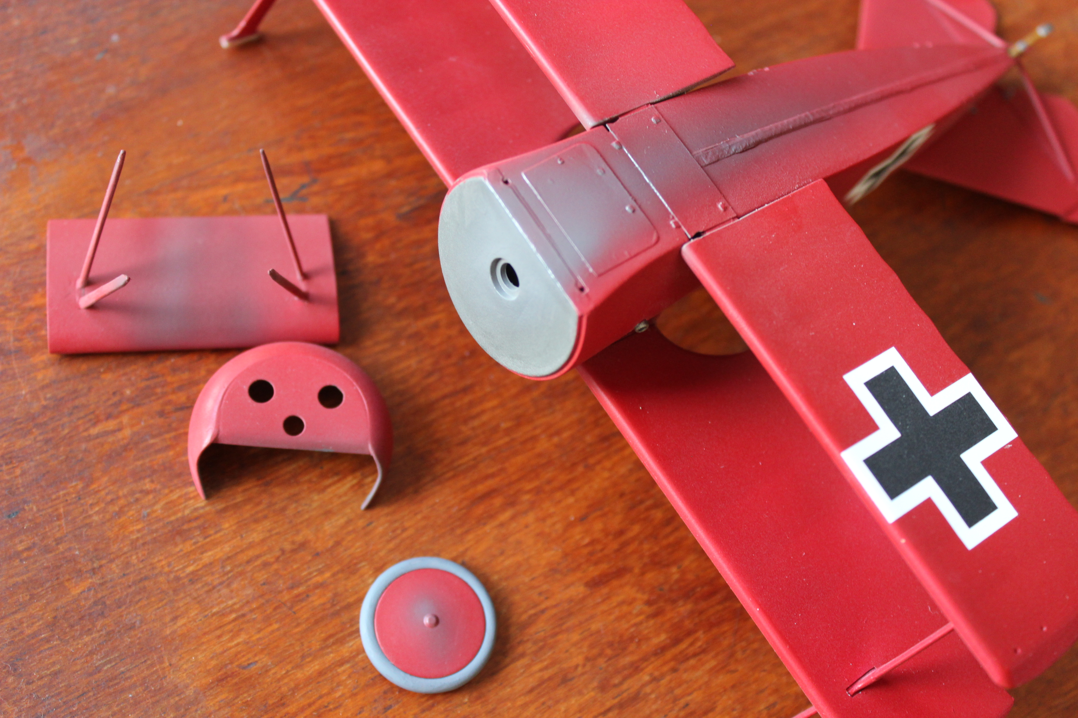

So with this minor hiccup, back to the Roden kit. I did some typical rotary engine-type weathering before putting things together, the under-surface of the fuselage needs some and I steer clear of black or very dark colours, the total loss oil lubricating system sends a fine spray out, more light grey or light brown. Also the upper surface of the undercarriage wing gets a lot - worth while adding some here and very visible in photographs.
This photo from WNW (research purposes only) show this effect well, I saw one modeller use this photo to surmise this wing was fabric covered with rib detail! It's just dirt...

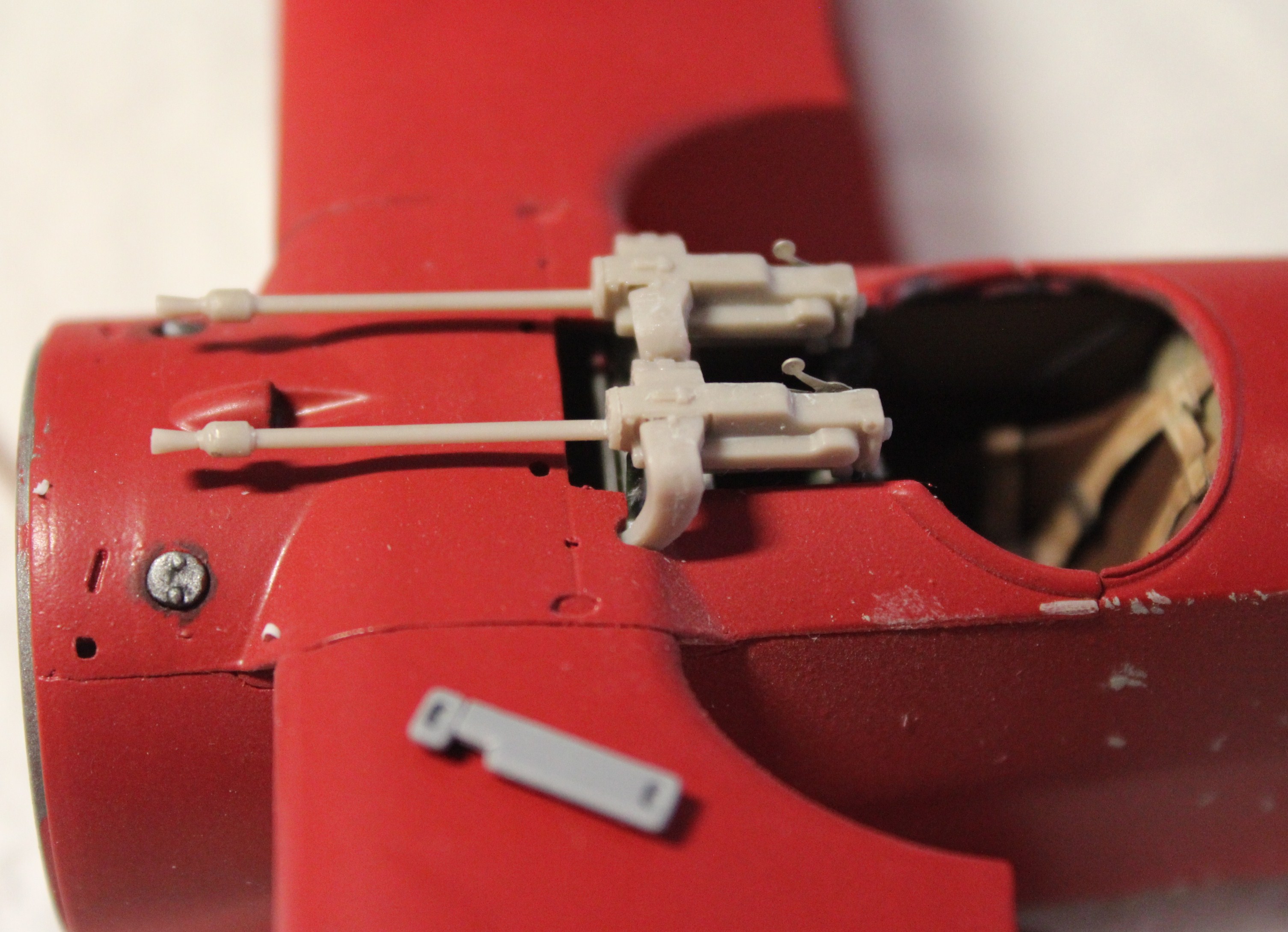

And I'm making some progress on the Spandau's... I decided the add the ammo shutes and shell ejection chutes first and then try them for fit first, I'm so glad I did this as quite a lot of trimming and sanding was needed to get them in place, and then I saw they touched in the middle so I just glued them together and lined them up parallel and here they are drying - next I'll add the butt pad that will firm up this assembly - instant gun-pack! Only after all this fiddling and filing will I add the PE jackets to lessen the chance of squidging them...

Nice work on the guns and chutes Marc! You have acheived a better fit than I did on some of My Triplanes! I also like the chipping effect on the left fuselage. Looking great.
