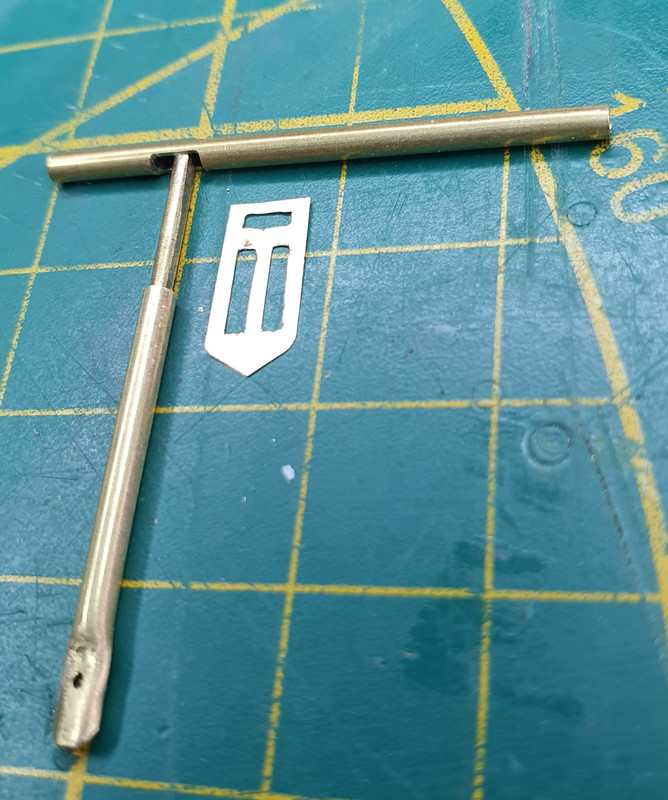

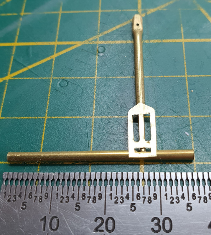

As I said, I haven't had much bench time, and although the control column is nowhere near completion, I wanted to show the little progress I have made. it’s  mainly replacing styrene parts with brass. It's a lot of work, but it looks better and it's sturdier.

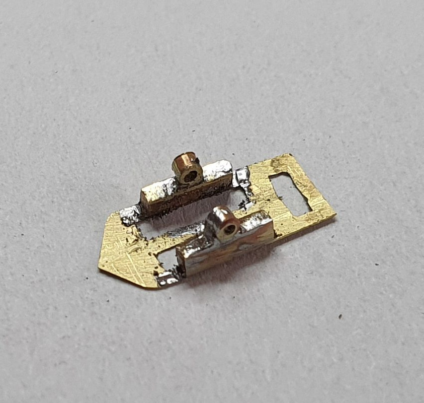

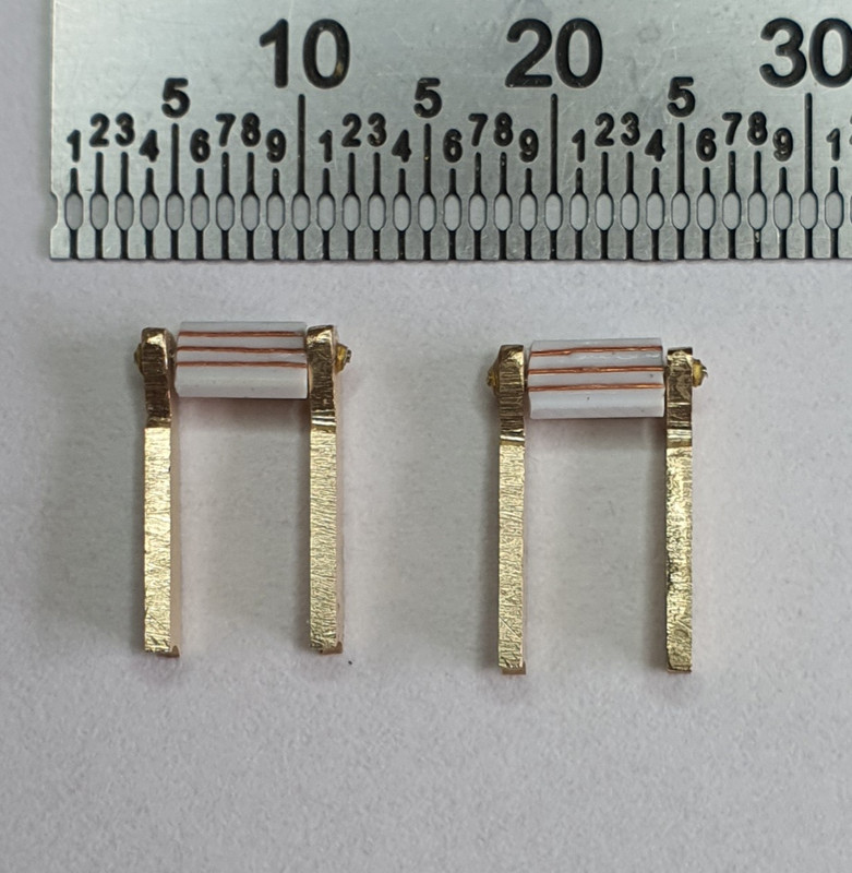

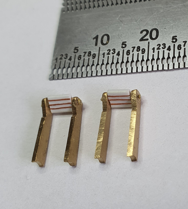

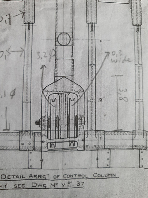

This is the frame that holds the pulleys for the rudder control cables. I am an absolute beginner when it comes to soldering, so it needs some cleaning up. In my defense: these parts are very small, even in 1/32. I made a template in styrene and copied the slots on 0,5 brass sheet:
The column itself is now of brass rod and tube. I found it easier to make from brass than styrene, because it is stronger and I can add more details.
I also re-did the pedals for the same reasons:

Working in brass is more difficult than styrene but from experience I know that it gives much stronger results. For the first attempt those pullueys are remarkable - very well done indeed. Do remember that solder can be easily filed away if necessary and onlookers do not need to know how you cleaned the parts.... It is the finished item that they will look at.

Thank you (again) for you kind words Stephen. I have a nice set of very fine needle files and sanding /polishing paper from grit 80 to 10,000, so that won’t be a problem. I just have to careful, because the parts are very delicate
@Dave:
I use a temperature controlled soldering station with the temp set to 375°. I clean up the surfaces with 1500 grit polishing paper and clean it up with 97% alcohol on a tissue. Before I start soldering, I dab al little flux with a fine brush on both surfaces.

But I enjoy every second working on it, planning ahead, trying out different techniques and materials, studying old documents and drawings.
