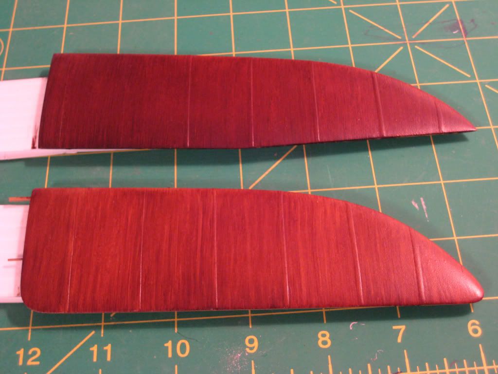

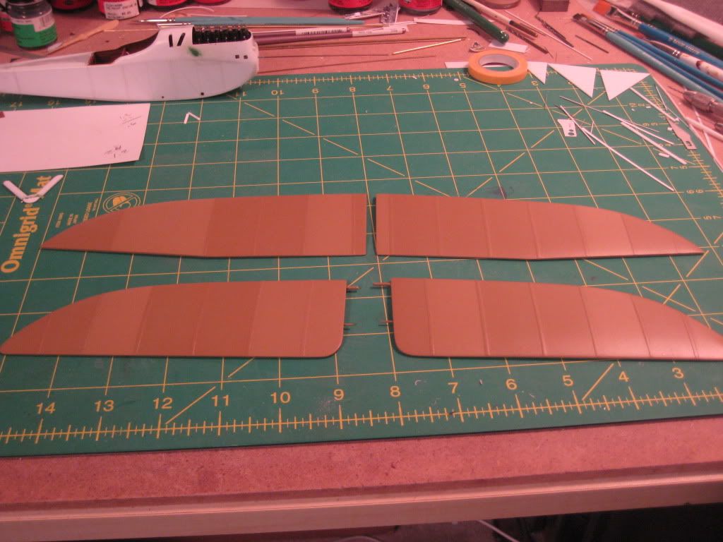

Time for another mini-update.  Here are the wings, painted and Futured, ready for oils:
The lighting makes the color appear more reddish, when, in fact, it is Tamiya Desert Yellow, and looks such in natural light.  As I write this, the oils were applied last night per the Eric Larson tutorial in Hints & Tips here, and the wings immediatey ensconced in a dust-free container to dry foe a few days.  I think they look pretty goods, but no pix until they dry! ;)  Then, I seal the tops and flip them over to do the bottoms. :)

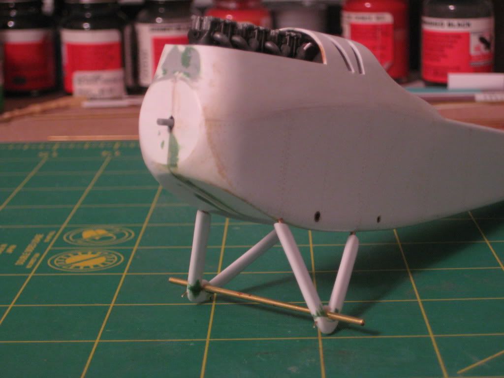

Slow but steady progress.  Here is a test fit of the landing gear.  I am pleased, but final positioning will require an assembly jig to be fabricated soon.

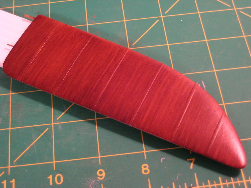

Here are the wing tops with dried oils.  I have not yet sealed them with Future and clear orange.
They appear a bit dark compared to other natural wood, but this is mahogany, which is generally darker than the pine or birch often seen on other aircraft.  They are not really as reddish as the pics appear due to the incandescent lighting.  I think it will be fine.  Now, after sealing, I flip them and do the other side.  While that's drying, I will build jigs, work on struts, etc.  Time to paint the fuselage too!

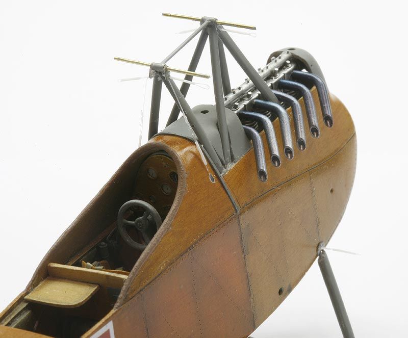

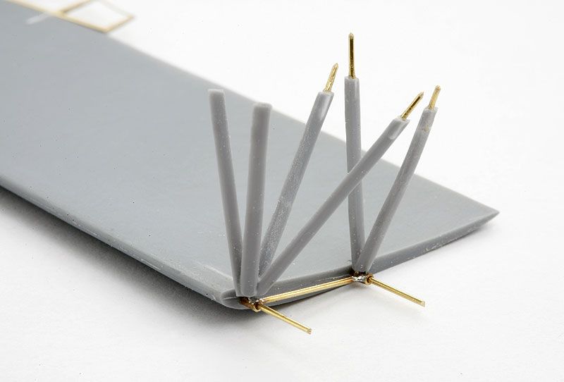

The next steps will challenge me.  I need to solder brass tube/rod for the cabane wing mounting bracket, this guy here:
These superb examples are from Wojtek Fajga's stunning 1/48 Special Hobbies Lloyd.  I've got my work cut out for me! ;)

« Reply #147 on: March 14, 2013, 02:06:33 PM »
I hear you Ken. ;)  I ended up experimenting with brass tube for the landing struts, but  couldn't get it into a proper areodynamic shape, so I settled on rectangular styrene strip sanded to an elliptical cross section and connected with brass pins.  It seemed like the easist way to get the combination of ellipical cross-section and "V" shape, and appears to be  sufficiently sturdy.  Brass tubing would have worked fine for round cross-section struts.  The axle is brass tube and will have a styrene fairing formed around it eventually.
