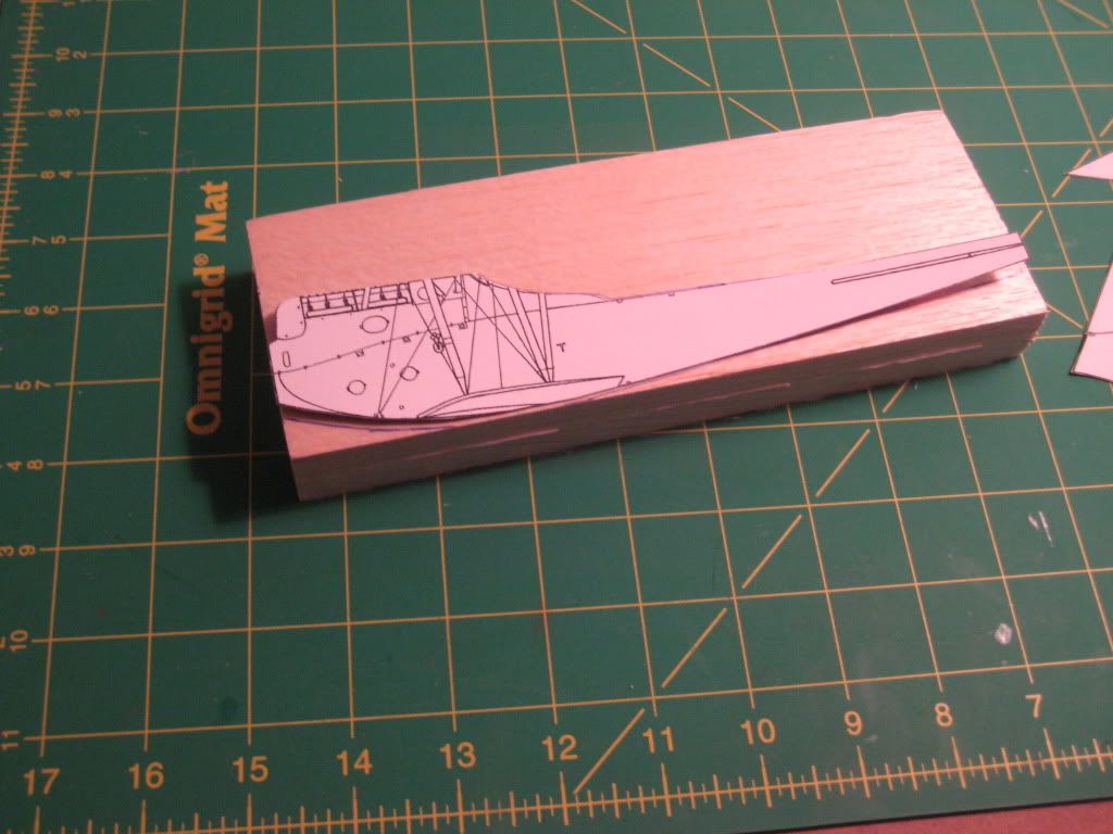

Still working on the posting of images.  The last shot is a completed 1/48 Special Hobby kit from the web.  I really like the elegant avian design of this aircraft, and it's beautiful mahogany wood sheathing on all surfaces.  Here are my plans from the Peter Grosz book, along with templates made from the plans enlarged to 1/32, and the balsa block from which the fuselage pattern will be produced for vacuforming, per Doug Bauman's Aviatik Berg scratchbuild.
I am plannng to fabricate the wings using Des's technique for forming an airfoil shape from sheet styrene, in this case 3.2 mm (.125") Evergreen Styrene.  I will likely build a license-built WKF version, Series 82.17-48, with a 220 hp Benz Bz.IV engine.  I hope to be able to get an extra sprue from WNW, but if not, I will build it myself.
Here is the fuselage profile laid out on the balsa block, which is actually two 1/2 inch wide pieces glued together with paper strips between to help splitting the pattern after carving for vacuforming:
The rough cut fuselage pattern in profile:

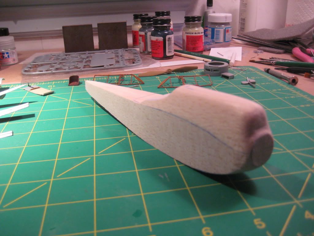

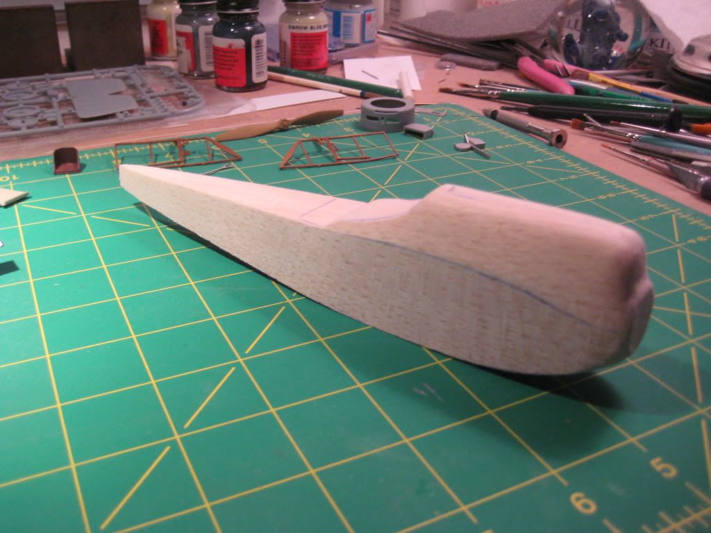

Okay, another couple of sessions of progress carving and sanding the master fuselage for the vacuform:
Next step is to spray with shellac and fine sand between coats to seal the balsa.  After that I'll coat with primer and sand smooth again.  The sanding to shape was a bit challenging, as you don't want to take too much.  I referred to my plans and photos of the protoype and the beautiful build photos of Wojtek Fajga's 1/48 Special Hobbies Lloyd C.V at The Aerodrome.  If you are a Lloyd fan and have not seen this build, you have to check it out.  Amazing!
http://www.google.com/imgres?imgurl=http://www.fajga.pl/modele/lloyd_sh_45.jpg&imgrefurl=http://www.theaerodrome.com/forum/models/37040-lloyd-c-v-s-46-%257C-special-hobby-%257C-1-48-a-2.html&usg=__VTod0E3aZkjJi7prWLvKe6qoIsE=&h=667&w=800&sz=52&hl=en&start=20&zoom=1&tbnid=gay3VcreWlqnfM:&tbnh=119&tbnw=143&ei=SzObUOTzA5Kv0AG2poDwAQ&prev=/search%3Fq%3Dlloyd%2Bc.v%26hl%3Den%26gbv%3D2%26tbm%3Disch&itbs=1
I will visit a friend with a tablesaw this weekend and cut the wood to assemble my vacuform box.  I also need to get the materials for the wing airfoil jig and assemble that.  It will be like the one Des has used for his Voisin and Taube.  I already have the 3.2 mm sheet styrene.  I'm still planning out the rest of the steps.
