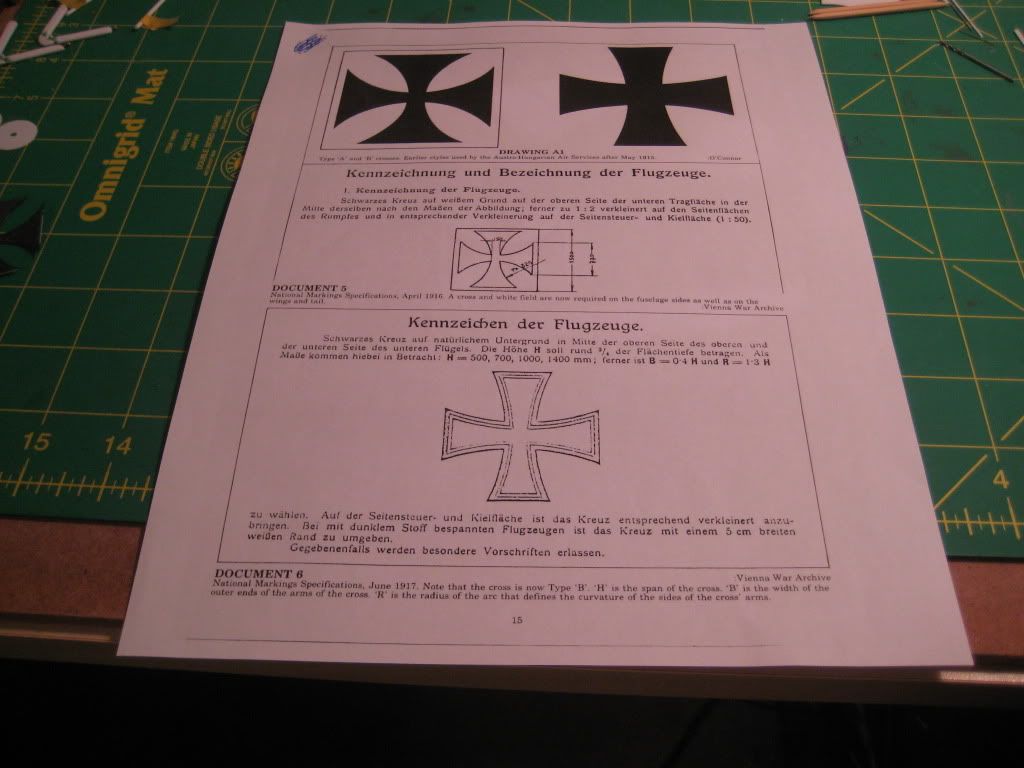

To paint the markings I first located a good pattern for the pre-1918 maltese cross used by the A-H air service.  I had an article from Dr. Martin O'Conner in Cross & Cockade which included a copy of the original 1917 A-H spec sheet for aircraft insgnia, as shown below:

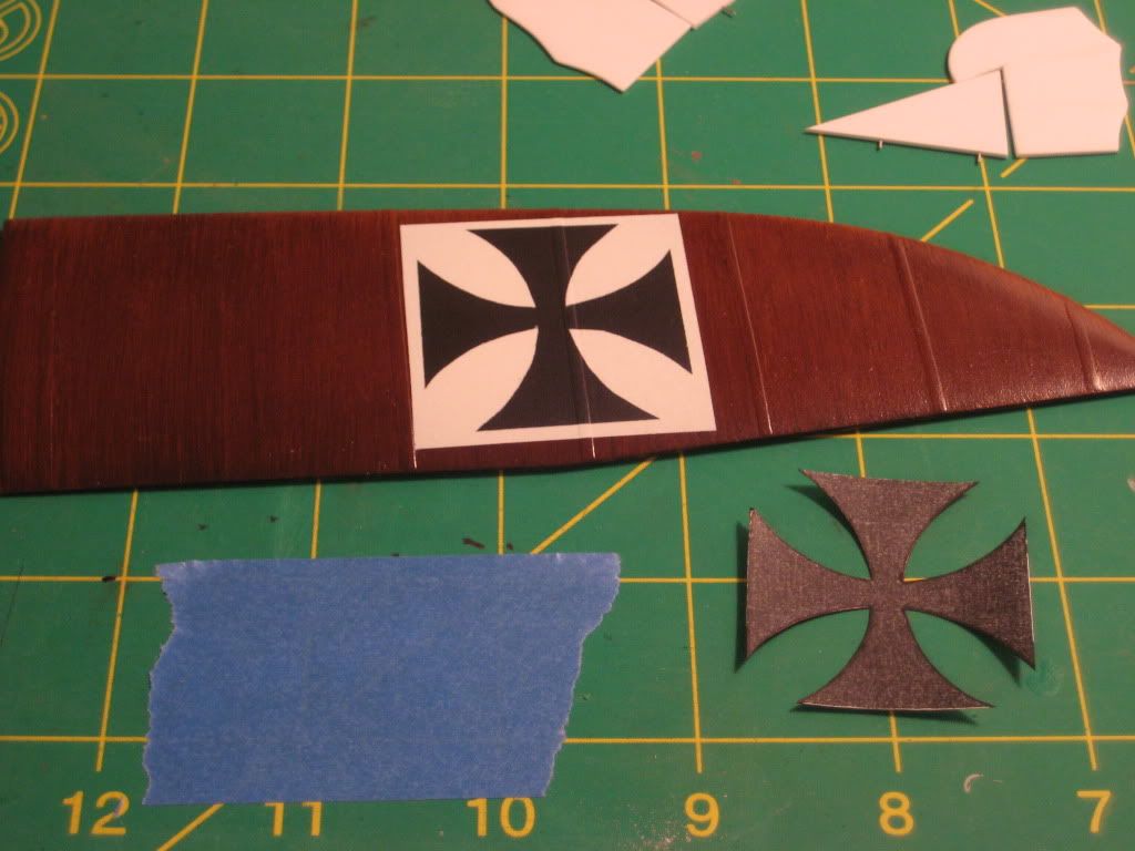

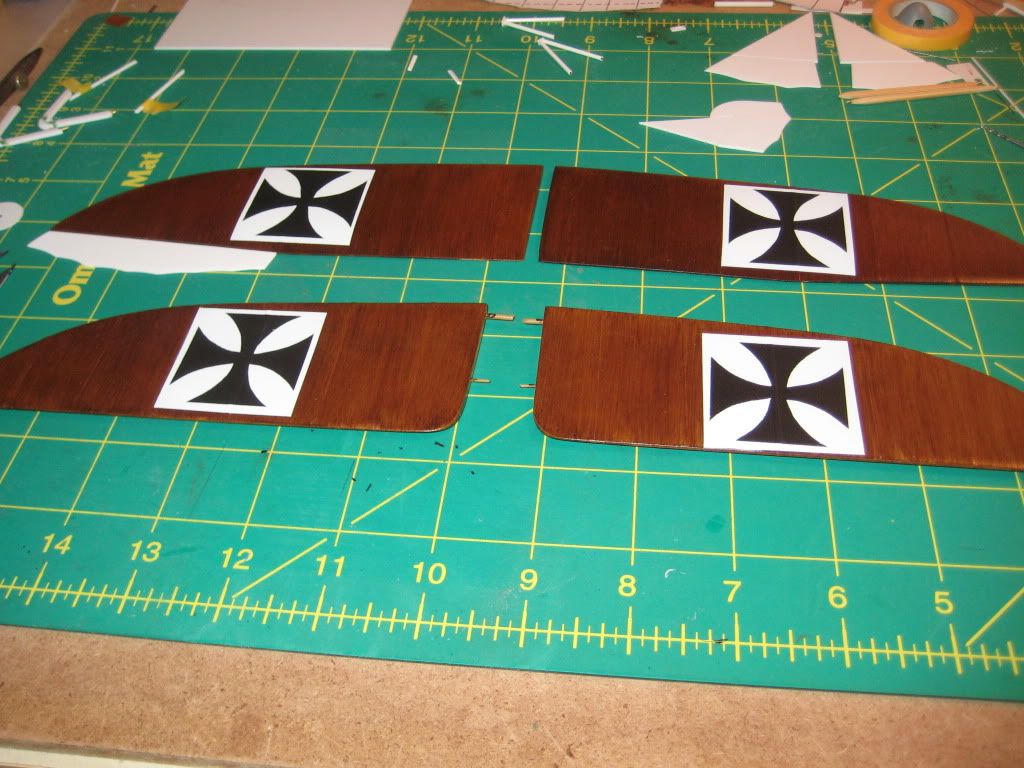

I used the reduce/enlarge function on my office copier to size the crosses appropriately for the 1/32 wings, fuselage and rudder, and made several copies of each size.  I then cut out the cross for the wings and used it as a pattern to outline the cross on blue painter's masking tape, and then cut out the cross masks.  The pattern and tape are shown below with the finshed wing:

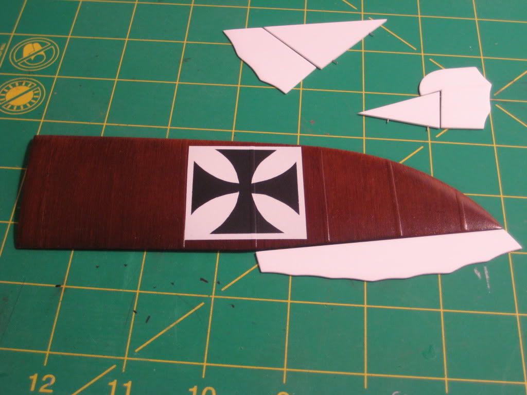

The outline of the white field was masked on each wing, and then painted black. A light coat of Future was applied over than to help the cross masks both adhere well and peel off without pullng up any paint.  The masking tape crosses were the carefully positioned within the "black" fields and smoothed down well.  Pollyscale Reefer White was then airbrushed over the fields in several light coats until full coverage was achieved.  After drying, the masks were carefully removed to reveal these results:
This photo also shows the cut out but incomplete aileron, along with the tail/rudder and horizontal stabilizer/elevator.  These are still in need of further sanding and painting.
That's it for now--still waiting for the fuselage wood grain oils to dry completely.  It will soon be time to get serious about assembly jigs, although there are still several details to fabricate such as the axle fairing, the top wing mounting bracket, the wing struts, the radiator, the exhaust pipes and the observer's railing.  A little more each day.

Very, very sharp work!! The white over black certainly covered well. Im always concerned about paint build up in that situation-light over dark.

Thanks Steve, Bo and Bud! ;D  I'm excited about this stage,as the addition of the crosses make things begin to look like the final product!  The white over black technique was borrowed from someone here, I think it was Dan or Bud.  I would not have tried light over dark on my own.  The theory is that it is easier to position the cross mask within the field than to position and outline mask, and that part seemed true.  I agree Steve, it's sort of counterintuitive with the white over black, and I was a little skeptical, but the Pollyscale covers well with a layering of thin coats.  The technique really worked like a charm.  Although you can't really tell from the photos, the white fields blend right in to the "wood" wing surface without and visible vertical edge, only the crisp and sharp demarcation between dark wood and white paint.  I am thrilled with how well this worked!

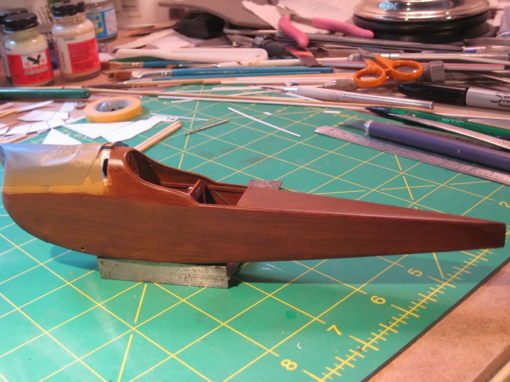

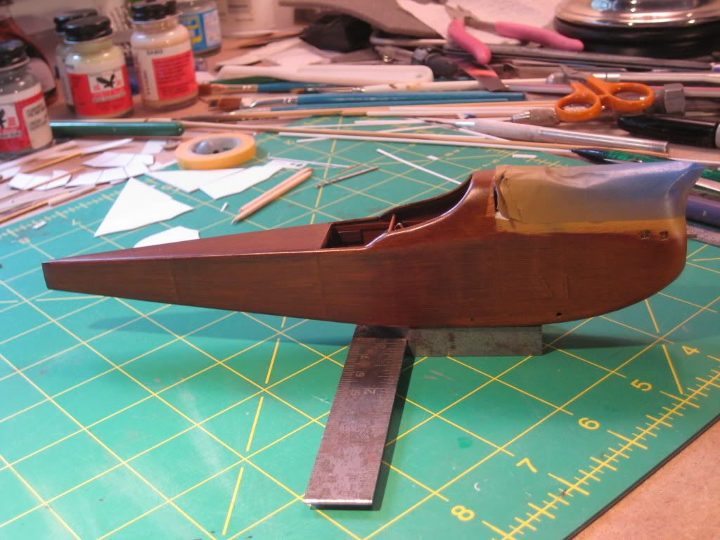

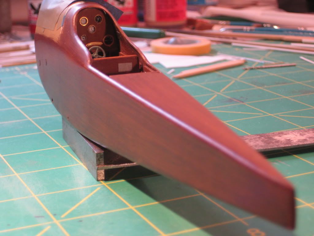

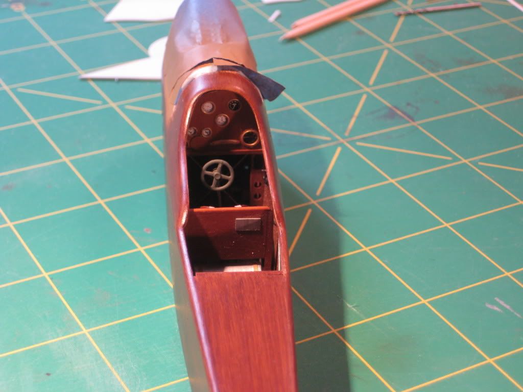

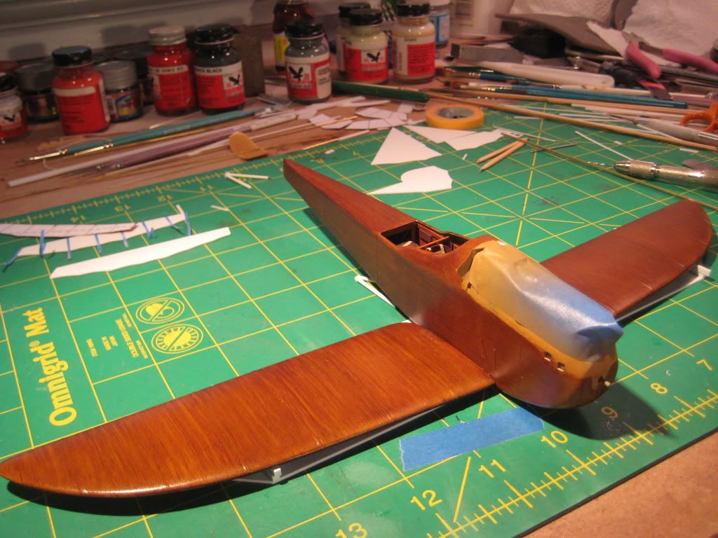

Okay Steve, since you asked. :D  I checked and the fuselage is dry.  Here are some shots of it as is, without clear orange overcoat or highlighting of nailheads and seams:
I couldn't resist dry-fitting the bottom wings: ;)
Now, back to the gritty work of fabricating details. ;)
« Reply #160 on: March 18, 2013, 01:13:32 PM »
Oh, BTW, the color of the fuselage does match the top wings.  They just look different due to different lighting.  Not to worry. :)
« Reply #161 on: March 18, 2013, 06:40:06 PM »
Brilliant!!! Thank you for the advance look and putting it together temporarily.

This project is really coming along, Bob.  Stellar work on your scratchbuilt Lloyd and I love that dark, rich wooden finish- it reminds me of a classic Chris Craft motor boat. This is one amazing build.

That does look like veneer to me, Bob.  It should make for an attractive model I think.
« Reply #164 on: March 19, 2013, 12:15:08 AM »
Thanks so much guys!  You're right Vickers---the wood color and graining does look like a ChrisCraft, and that's a good thing in this case! ;)
