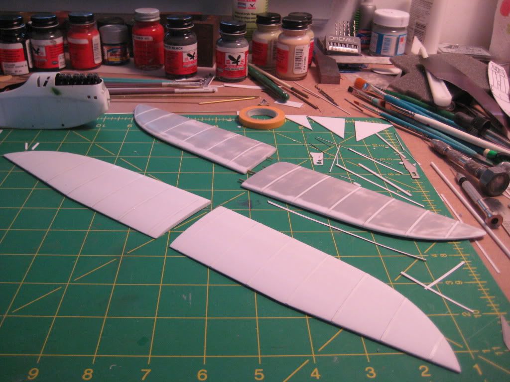

Weekly update time folks.  I have made some progress, although it may not be readily apparent.  The top wings took a good deal of sanding, and adding the battans was a slow process.  The airfoil shape may not be perfect, as there appears to be a somehat flat portion in the center, but they look similar enough to photos of 1/48  Lloyds that I am satisfied with them.  As soon as the battans are finished and sanded this weekend, I will prime and paint the wings in prep for the oil wood grain finsh.  Here are the wings on the workbench:
The horizontal stabilizer and fin are in the background, simple triangles.  I still need to cut out and shape the scalloped rudder, elevators and ailerons, which will all be CDL.
I've also reached the point where I need to think things through carefully regarding fabrication of remaining components and planning jigs for same and for final assembly.  I'm also working on certain details such as landing gear and the cabane strut assembly.  Much of this invovles noodle work, sketching and making notes, with some trial and error experimentation with various materials I think might work for a certain components.

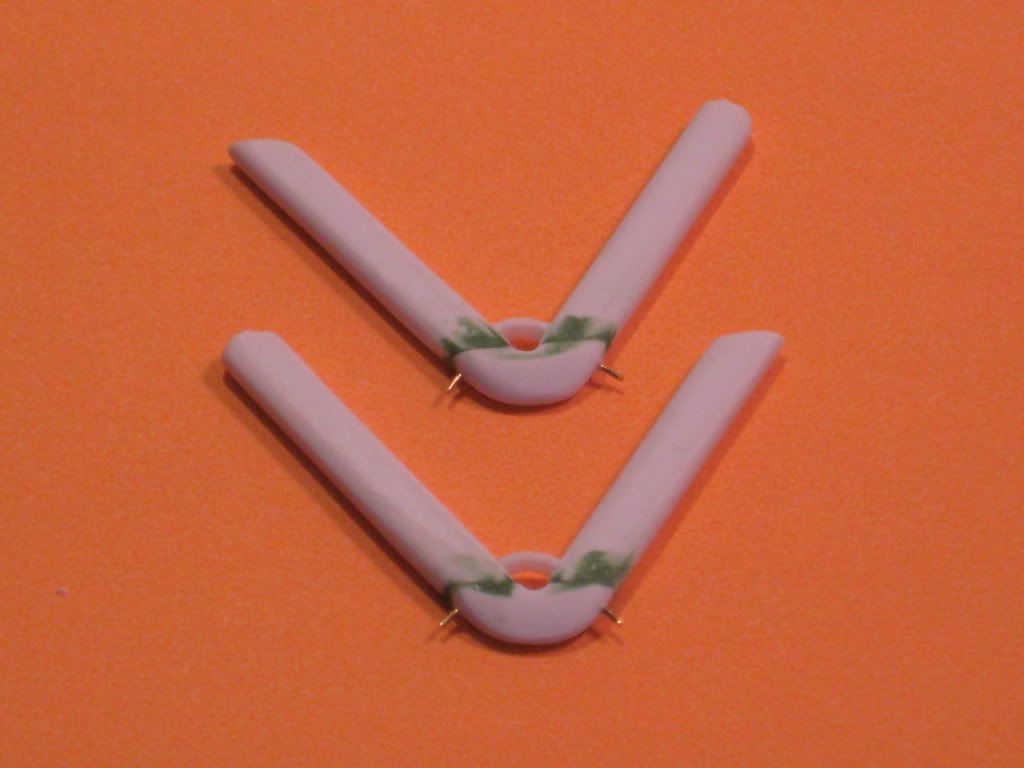

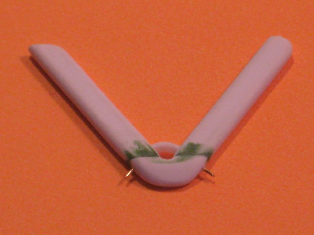

I have come fairly far with the landing gear.  The struts are finished, except for insertion of 1.2 mm brass pins to connect to the fuselage, and a brass wire step on the front port strut that I still need to add.  The axel will be a length of 1.5 mm brass tube, bungee lashed to the struts, and wheels will be a spare set from a Roden Albatros kit that match the size and appearance from my plans.  I will need to fabricate a fairing around the axel as well.
