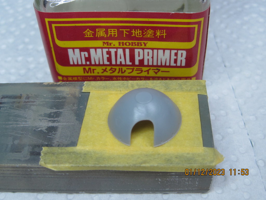

funnily enough and in line with your question, I am currently working on the spinner.
The metallic effect was created with Mr. Metal Color polishing paints and is actually quite easy and quick to achieve.
Here are the pictures in the order in which I worked.
First I put a few dents, bumps and small damages on the spinner, this was done with a small file and sandpaper.
Then I primed the spinner with Mr. Metalprimer.
Next, several thin layers of Mr. Metalcolor "Aluminum" were painted with the airbrush.

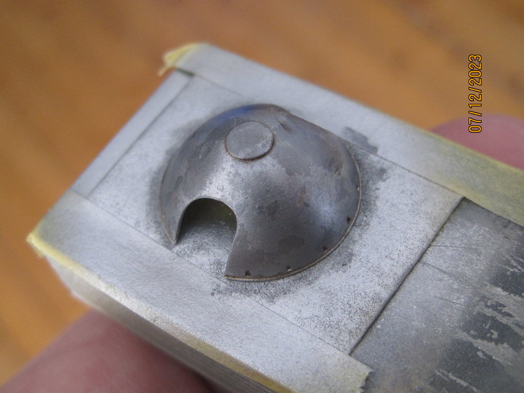

The spinner was treated with dark, highly diluted oil paint and then sealed again with diluted Tamiya "Smog".
However, it is not yet finished at this stage.
The propeller hub-plate has now also been fitted.
The propeller itself is now completely finished.
