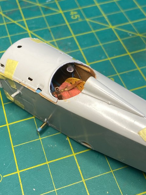

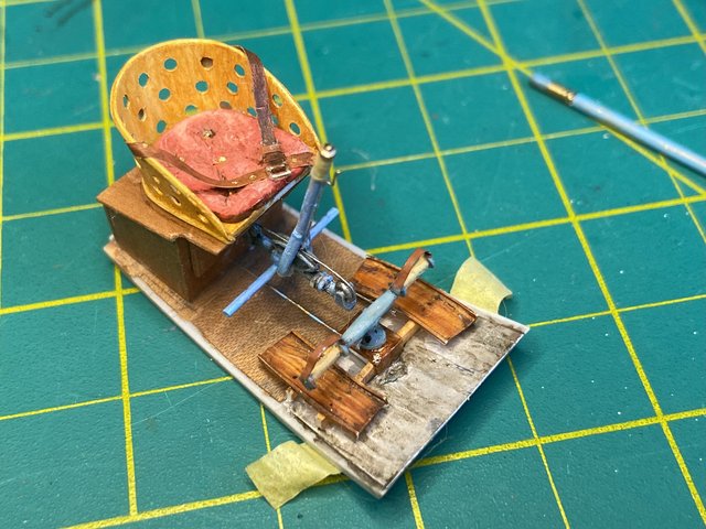

Some significant progress, at last; I finished the cockpit (more or less) and closed up the fuselage. After trying and failing to get a definitive answer to the seat-belt configuration I decided to go with the simple heavy leather belt illustrated in the Nieuport-Macchi parts "catalog", scratched from thin masking tape and a buckle made of miniscule bits of brass wire. The tach is the kit part, unmodified except for a cable made of fine solder, and embellished with an instrument face off a fragment of an Aviattic D.VII sheet included as a bonus on another order. Still to add is the curved bar under the coaming, and a watch (?) that's clearly visible on the port side in photos of Sgt Barnay's a/c:
And yes, that is indeed a large ginger cat on my lap, he's the Inspector of Quality Control, among other things. Thanks for taking a look!

Andreas, the wood tones are mostly actual wood, the seat "box" is Swiss pear, and the cockpit floor & sidewalls are ultra-thin cedar veneer that came as the wrapper on a fancy cigar.
And Nigel, having just started building again after a long hiatus, I'm still working out of a collection of cardboard boxes in the dining room, conveniently close to the bay window where the cats usually lounge. But despite my fears that the Nieuport might end up as the world's most elaborate cat-toy, neither he nor his sister have ever bothered it (or me while I'm working on it, for that matter :-)

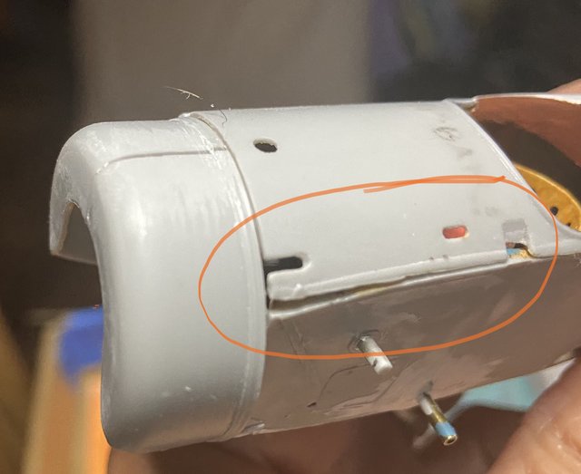

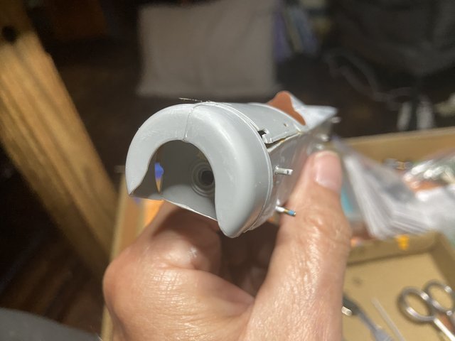

Having gotten the fuselage together at long last, it's time to deal with the awful fit issues in the nose/cowl area. I'm trying to imagine a first-time builder taking a stab at this kit, and have to say that it would be an almost insurmountable challenge... I can only imagine that the poor engineering, obscure instructions, shallow dimples for mounting points (if they're there at all) and a host of other issues would doom it to being thrown out the window in frustration in short order. Heck, I've built  hundreds of models, and it's still proving to be a marathon test of my patience and skills.
That's the best fit I've been able to achieve, and that's after a fair amount of refining the parts; I had to splay out the rear of the two-part cowling almost 0.31"/0.7mm in order to get it to fit on the firewall. Trying to get the "cheeks" to match up on both sides is going to be yet another part of the nightmare challenge :P

Uh, that‘s what I‘d call a bad fit  >:(
The question is: is the fuselage side part too curvy or the upper decking too straight? It’s the later, I‘d say judging from the photo. I think I‘d glue in a plastic wedge ans sand it all smooth. Reconstructing the lost stitching detail looks manageable.
Good luck!

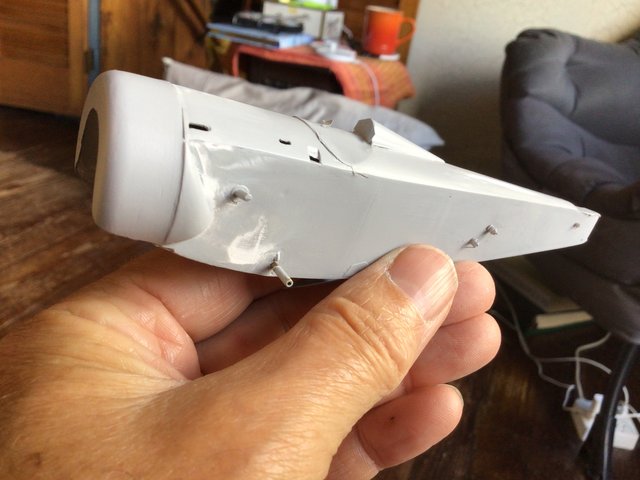

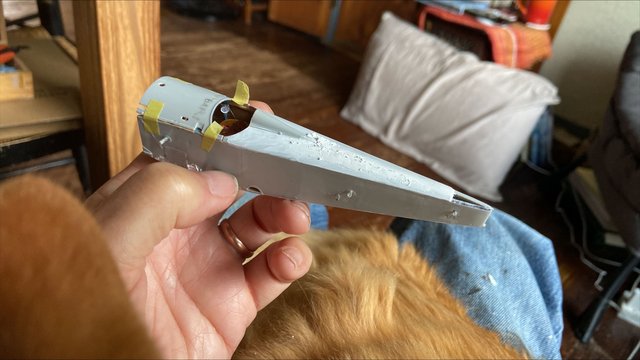

« Reply #161 on: October 25, 2023, 01:56:01 AM »
Thanks, Andreas, I basically did just that last night, although there's still some fine-tuning of the upper decking to do:
Replacing the stitching won't be a problem, because there wasn't any to begin with, just these featureless lips:
How I'm going to replicate the lacing is a problem I'm working on now.
I've sanded off what fuselage detail there was, since it was all rudimentary to begin with. The brass tube will get cut flush and serve as a socket for a brass rod embedded in the sesquiplanes for strength, and I'll replace the crude kit air intake nubs with Albion Alloys aluminum tubing when I get everything else squared away.
