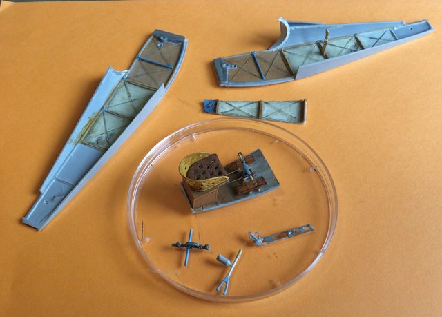

I've spent a lot of time working on the rear of the fuselage, knowing full well that practically none of it will be visible after things are buttoned up... but it's allowed me to get comfortable and explore methods of rigging and weathering and so forth:

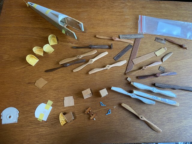

I've been making slow progress on the interior of the N.16, but things have been greatly helped along by my purchase of the tiny Acalox 201 rotary tool (as recommended by Sandy/macsporran some weeks back) and a set of proper mini-drill bits from Drill Bits Unlimited—and I saw your post earlier, it's too bad that shipping to the Netherlands is so high as they're wonderful tools.
I'm hoping to actually get the cockpit area finished to the point where I can glue the fuselage halves together this weekend. Here's the major components, in varying stages of completion.

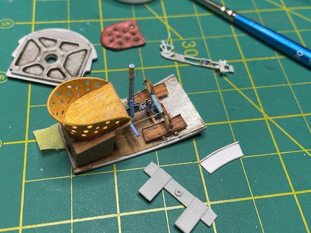

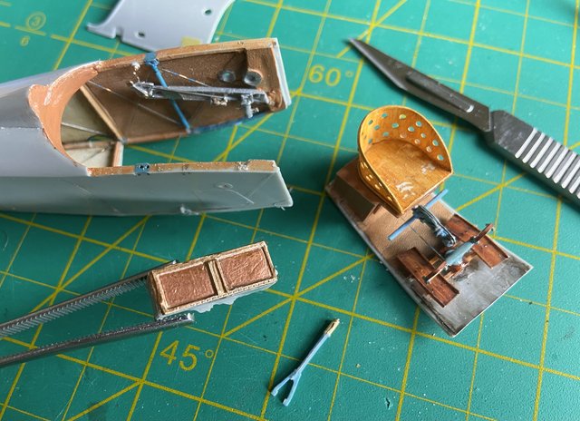

The fuselage didn't get buttoned up like I'd hoped this weekend, but I made progress, and had a wonderful time doing so; I'm particularly happy with the gun trigger and Bowden cable on the control column (which you can barely see in the photo below) made from a length of fuse wire with one end flattened in a pair of round-nosed pliers:
The piece in grey in the foreground is the kit foot-races, alongside one of my prototype scratchbuilt replacements.
Still needs belts and instruments—or at least a tachometer and a clock—but after nearly three months I think I'm ready to climb out of the cockpit and start working on the outside of Sgt Barnay's a/c.
