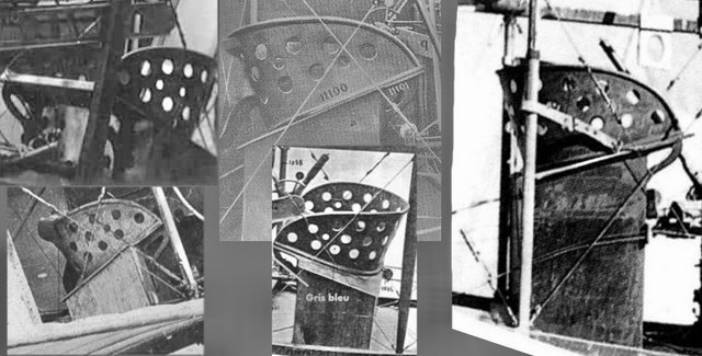

I am glad I was able to help. I remembered the photo because there was a discussion long ago about how the seat was mounted. Much easier than scratch building that Nie. 17 seat mount  8)

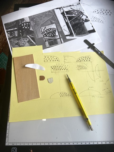

Back to the drawing board—or light table, as the case may be—RE: the "short seat". I collected all the pics I could last night and started redrawing a template at a little less than twice the final size. It took me a bit to figure out a logical arrangement for the holes, which, as is the case with the "tall seat", are arranged in diagonally staggered rows spaced to accomodate the radius of the seat back. I wish I could locate a contemporary picture taken from the front that clearly showed the pattern, but lacking that I think my in-process drawing at the very bottom of the yellow card-stock must be pretty close. If anyone has evidence to the contrary, please LMK!
... and the real item...
Dave V.

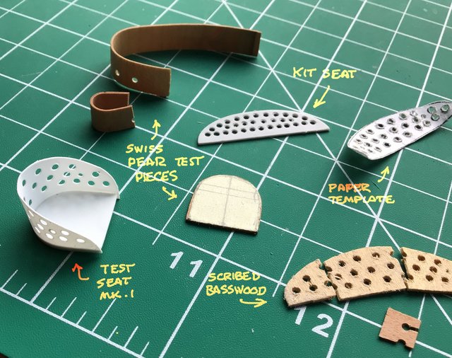

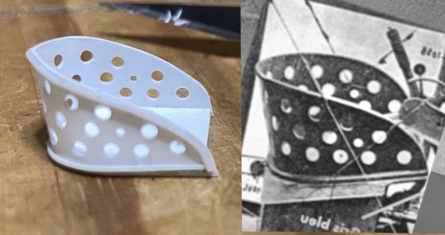

Thanks, Richie! I've actually made a lot of progress since last night, having abandoned my idea of making the seat out of the scribed basswood decking... not only did it crumble when I steamed and bent it, but I realized that in scale it would give me a seat back 1" thick (the original was 1/8" ply). So I got out some .010 styrene this morning and knocked out a Mk.I test seat in about forty-five minutes:
 The holes are staggered unevenly (although it's difficult to tell once it gets wrapped around the base) and the radius of the back is a little ragged, but all in all I'm pretty happy with it. The Mk.II should be better still.
Dave V.

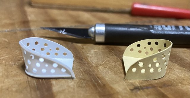

Thanks, Gary, Steve, Tim & Richie! I made some progress today, if only in realizing how far off the Mk II seat was from the real item. When I set it next to the Mk I from a day or two ago tonight it looked pretty good:
... but when I compared it to the photos of the actual seat it became immediately apparent how far off the shape was:
... I could also see that the half-round molding around the top and bottom was about twice as thick as the real one... I'd used a piece of styrene rod I found in my plastic bin, scraped down and stuck on with liquid cement. I'll probably go with stretched sprue next.
So, back to the drawing board... ah-gin, as Forrest Gump would say.
Dave V.
