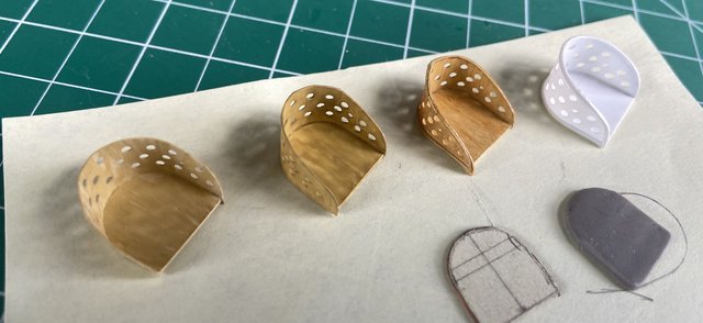

Thanks for the support, Stephen & Rick & Ben! I’m working on the Mk IV seat now, and while the radius of the "arms" is still a bit off I'm much happier with it overall when compared to the 1:1 seat:
The sloppy edges on the bead molding on the top edge are actually unsanded white Tamiya Surface Primer to fill in a slight gap in a couple of places. One of the reasons I was unsatisfied with the earlier versions was that I couldn't get a even curve in the seat back, which I solved by immersing the flat blank in boiling water for about twenty seconds, bending it around an AA battery, and then running cold water over it to "set" the shape; no stress fractures this time (visible on top of the back of the Mk III seat, second from R) I'm also starting to play with colors and ply finishes on the previous attempts (Mk IV at R, unpainted):
I guess I could move on to a Mk V, but we may have hit the point where the Law of Diminishing Returns kicks in. We'll see how the paint comes out on the current version. In the meantime I've been also working on the props—we're up to like a dozen now—and profile. Updates on those sub-projects soon.

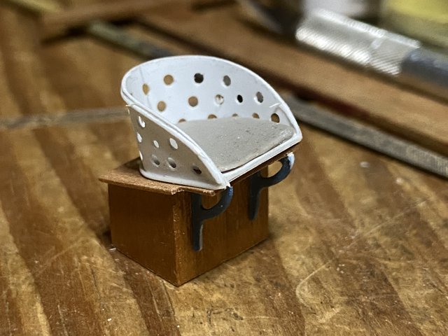

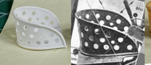

RE: my last post, it's been a while since I've worked on a model, and apparently I've forgotten one of the basic rules of the sort of semi-scratchbuilding I tend to do: To wit, don't spend time making anything until you know it's going to fit where you intend to put it.
When I started building the "box" that the short seat sits on last night, calculating the dimensions from the inside of the Amodel fuselage, it immediately became apparent that all my seats—Mks I thru IV—were 3-4 scale inches too wide to fit on the top of the box. I should have built the box first, then the seat... I'd based the width of the seats I was making on two sources, a) the 70-year old Bergen Hardesty plans of the N.17 that I'd saved from some 1960s-vintage model magazine (the old Scale Modeler IIRC), which showed the dimensions as roughly 17x18", and b) the seat from No 1 Son's Hobbycraft N.17 that was the first model he ever built on his own, back around the turn of the century. How different could the N.16 be, I figured?
But the good news is that I've made so many seats now I was able to knock the Mk V out in about a half-hour, which sits mocked up on the box with a basic un-cooked Super Sculpey cushion and a pair of plastic card brackets and looks... well, sort of okay at this point:
It needs final shaping, filling, priming, paint, and all that good stuff (as well as the holes & pulleys for the control mechanism & cables, etc.) but I think I may be able to move on from here with a clear conscience, detail-wise. Anyone have any suggestions on French seat-belts?
I think I'll unwind by having a glass of rum and Rose's lime juice to celebrate the 225th anniversary of the Battle of the Nile. Down with Bonaparte!

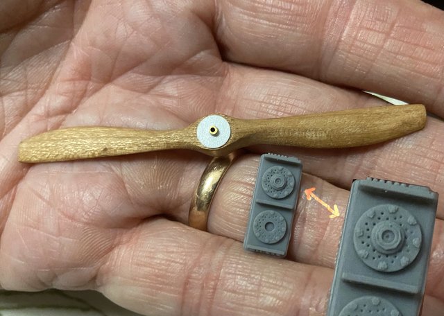

More work on the props, the upper one is the one I'm using to develop a finish that approximates the pigmented shellac (still too red, working on the color), while the bottom represents my best attempt to date at capturing those sexy Levasseur curves. The bottom prop isn't tinted yet; before applying the copal varnish I'm filling the grain in the mahogany with the old woodworker's trick of applying a drying oil (Watco Danish, in this case) with 500-grit sanding film. The extremely fine wood-dust gets incorporated into the oil, and after it dries you repeat the process as many times as necessary to fill up the open grain and leave a smooth surface for the varnish.

But back to airplane stuff; I was excited to get my prop hubs from Alex at Proper Plane in Kyiv today, they're brilliant!
No way I could have scratched them. And RE: the seats for the BE, I feel for you... at least I didn't have to weave mine, just drill out some styrene card!
D.V

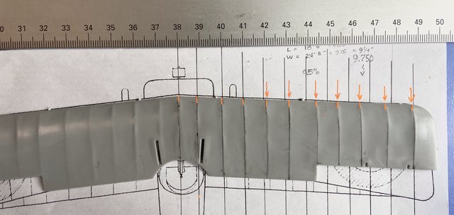

May I ask you to check the top wing for me?  11/16 had non-equal spacing between the ribs is it the case with your model?

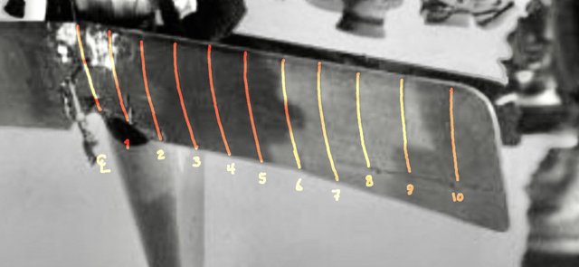

Edgar, I checked the top wing, and the spacing on the Amodel ribs (from the center of the wing to the actual wingtip) is approximately as follows: 7.9mm/11/9.5/9.5/9.5/12.7/9.5/9.5/11/11/11.
When I compared it to Ian Stair's drawings in the Nieuport Datafile Special I was horrified to see that the drawings showed 11 ribs, versus the 10 on the model (black lines indicating rib stations on the Stair drawings, orange arrows showing those on the model):
So I checked with the best photo I have of the N.11/16 upper wing, and was happy to see that it showed 10 also:
So it looks like Amodel got the correct number of ribs, do you know if their spacing is correct also?
The side panels on the kit are 41.2mm from the back of the cockpit to the firewall, and have trapezoidal access panels just aft of the aluminum "cheek".
