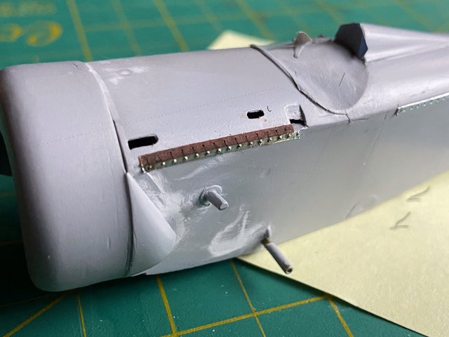

Thanks, Ken and Zac! Still putzing around with different methods of replicating the Nieuport upper deck lacing system, and think this one shows promise:
Mike's idea of an applique led me to try making the upper strip from thin "Nichiban" masking tape painted with Vallejo Red Leather & punched at 1/32" intervals to represent the grommets, and the lower from HVAC aluminum foil tape punched from the back to represent the lacing studs. If I can get it perfected (it's overscale now, compared to the photos in my last post) I'll do a more detailed explanation.

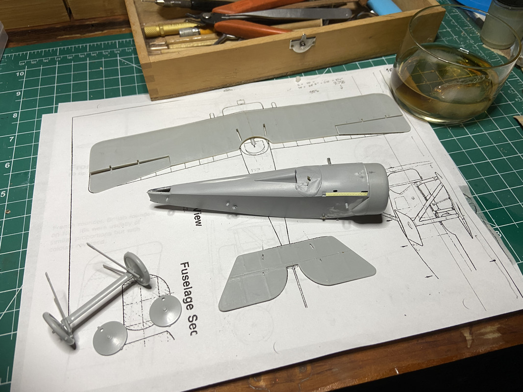

Although my new workspace isn't completely up and running yet, I was having withdrawls from not hacking up the N.16 and broke the bench in last night by doing some cleanup on the wing and ailerons and a rough assembly of the landing gear:
I'm mildly amazed—given the challenges I've been facing with this kit—that I've been able to maintain interest in this project for five and a half months, something which is due in large part to the comments, suggestions, and general feedback I've been getting from everyone here.
