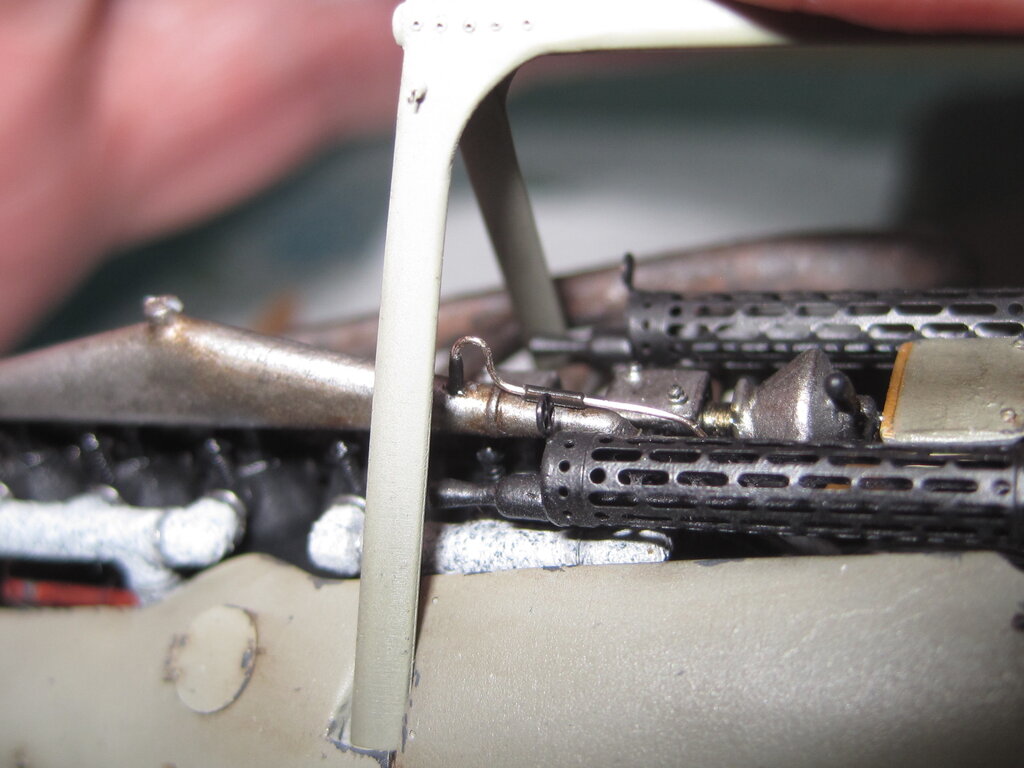

I have reworked the canopy strut of the D.I a little and detailed it more carefully.
Basically, I rebuilt the entire strut again - I had found parts for it in the Encore Alb. D.II kit.
The screw connections for the upper wing were made with 0.5mm aluminum tubes and a bracket for a rear-view mirror was added.
The rear-view mirror is documented in the original picture of the D.450/16 by Carl Holler.
The bracket on the strut is a thin aluminum rod from a tea light.
The wire holder for the mirror itself was bent from a 0.3 mm copper wire.
The eyelets for the tension cables are made of 0.09 thick silver wire.
The right rear strut base was extended again so that it looks more like the original and does not appear "cut off".
Various paint chips were also added.
Where the upper wing is "screwed" onto the canopy strut, two brass rods have been glued in to give the fit a little more strength.

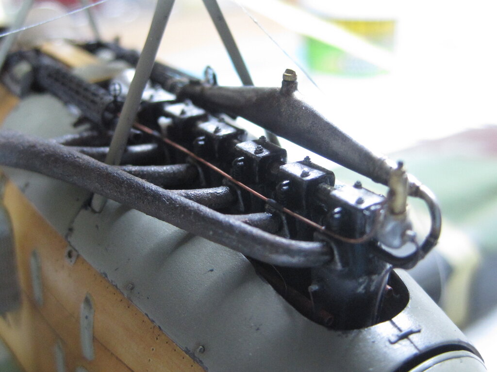

The expansion tank for the cooling water is also in place.
The cover has also been fitted to the tank.
Now it was time to lay a return line on the expansion tank.
I used 0.25 mm silver wire for this.
Servus
Bertl
Offline Umlaufmotor
  • Posts: 1217
Oil and pressure lines on the engine were also added and routed.
I used 0.3 mm copper wire for this.
By the way, the thin white engine number on the front of the first cylinder was painted on with a brush - I looked for matching numbers which consisted of straight lines and were therefore easier to paint.
The paint was Tamiya glossy white.
I just looked at a picture of the engine, the "characteristics" under the photo say it was June 22, 2009 .... .  :o
Servus
Bertl

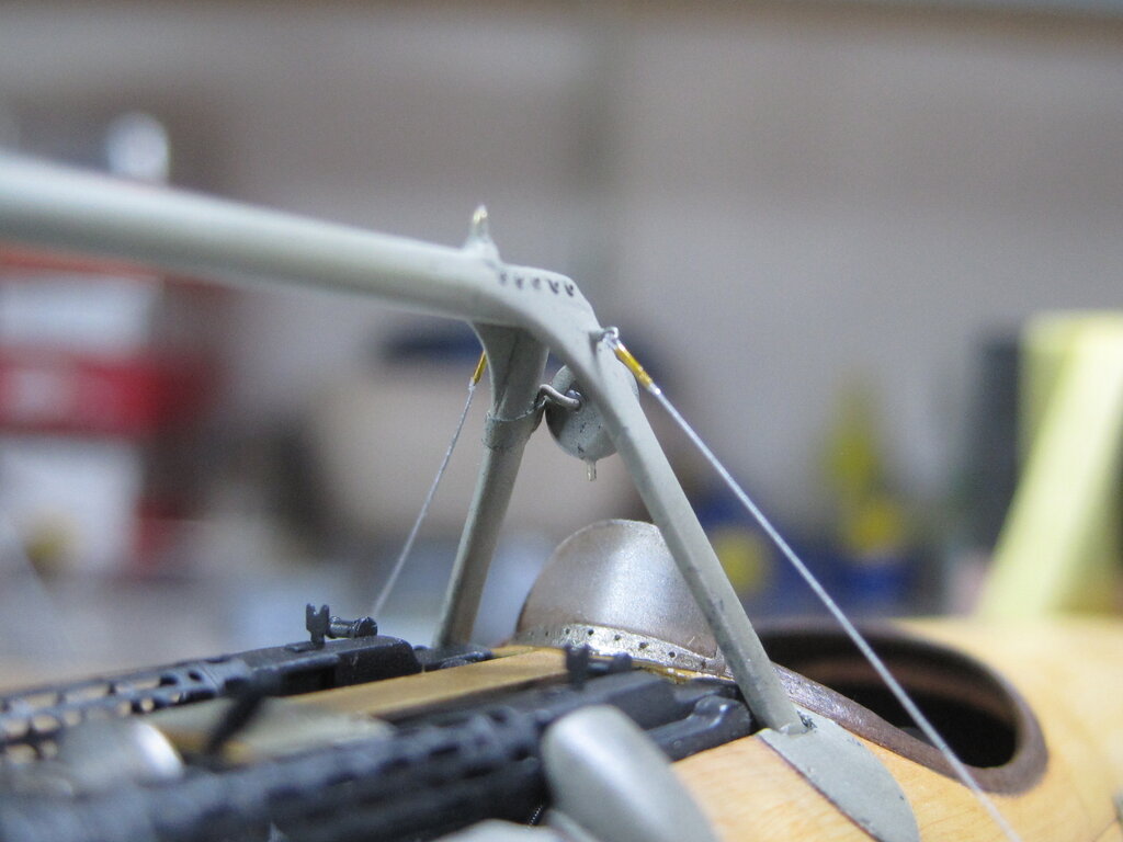

Now it was time to think about the rear-view mirror.
Carl Holler had always fitted a rear-view mirror to the Albatros D.I and D.II airplanes he flew.
It was certainly used frequently back then - more frequently than some of his contemporaries do in their cars today .... .
I used a mirror from the Wingnut Wings kits here.
However, it was sanded much flatter on the back, a hole was drilled for the bracket and the edge was reworked with a scalpel so that a mirror glass could be inserted.
As a reflector for the mirror I used parts of the chrome-plated casing of an empty AAA battery that was lying around.
The glass was punched out of transparent packaging.
Reflector and glass are both 3mm in diameter.
And believe it or not, what you see in the mirror is not the shadow of the tip of the tweezers, but their reflection  :D
The 0.3 mm brass rod was glued in place for easier handling during painting of the mirror.
However, a short section of it remains after completion.
This was often the case with the original as well; the pilot could use this short lever to adjust the mirror slightly.
Servus
Bertl
« Last Edit: March 19, 2025, 04:40:19 AM by Umlaufmotor »
Offline Umlaufmotor
  • Posts: 1217
The mirror was attached to the model.
I used white wood glue to adjust it, and after adjusting it, it was secured with superglue.
That's it for now.
Servus
Bertl
