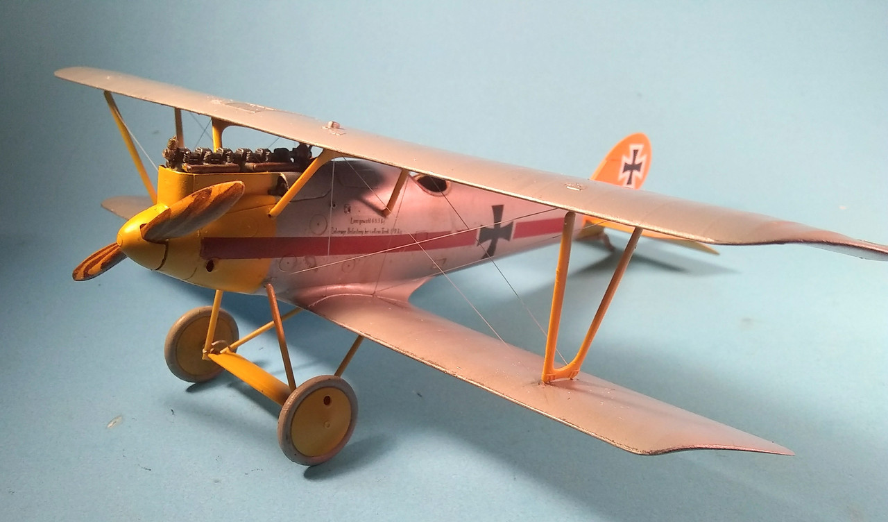

The wheels and radiator piping have been added to the DIII.

So now for a VERY SMALL update:
I have changed the color of the Albatros German Lilac/Mauve just a bit. The Polyscale color was considered very accurate in the Early 90's. I just couldn't wrap Myself totally around the color. So having discovered that Polyscale and Valejo seem to play well together I mixed some Intense blue from Valejo with the Polyscale Mauve. I then brushed a Thinned coat over the previously sprayed areas. This turned it a bit more Violet but left some of the Pinkish showing through. I think after some Oil Dot Filters to blend it in it will look great....or so I hope!
WNW crosses have been added to the upper wing on the Pfalz and Albatros:
« Last Edit: June 22, 2022, 10:12:11 PM by RAGIII »
