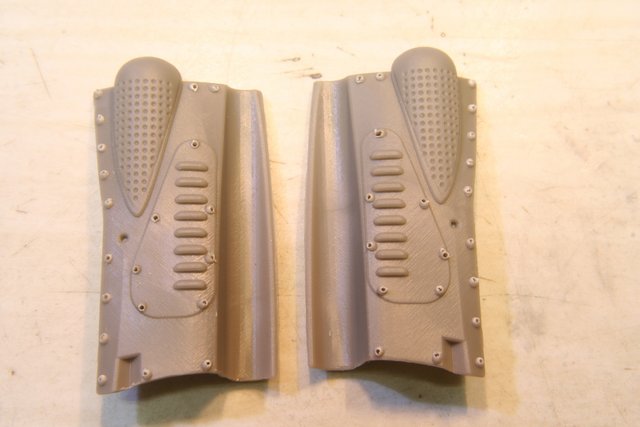

I have drilled some holes for engine panel cover fasteners.  These are 1/4 turn fasteners to be represented by wire, flattened on one end (not pictured).
I also had this crazy idea that I could improve the engine cooling slats.  I'll see how it turns out before deciding to use it or not.  I turned a round jig on the lathe to make the back ring into a circular shape.  Kit part on left.
Are there no slats in the parts set?
I just checked my 1/48 set, and the slats are thin plate with a axle in the middle, which just have to rotated.

Frank, no, the PART PE did not have the cooling slats, though I expected it would.

I was just looking again at your post Ken. What size drill bit are you using on those fasteners? It must be smaller than My usual #80  8)
Re: Roden 1/32 SPAD XIII - detail added
« Reply #24 on: August 02, 2021, 09:38:56 AM »
Rick, no, I used a #80 bit.  I did indent the positions with a sharp pick to get the drill bit to stay on target.  The wire fasteners are just 0.008", so they fit somewhat loosely.  I'll put them on after painting, so they will be silver colored.  Speaking of the #80 bit, I broke my HSS bit, so I need a replacement.

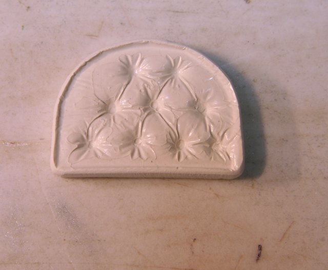

Made a seat cushion from Milliput and detailed the seat.  Belts are next.
The cooling slats I made look good, so I'll go with them.

more great work, both the grill and cushion look great

Great upgrades on this so far - love the cushion as it looks so realistic!
