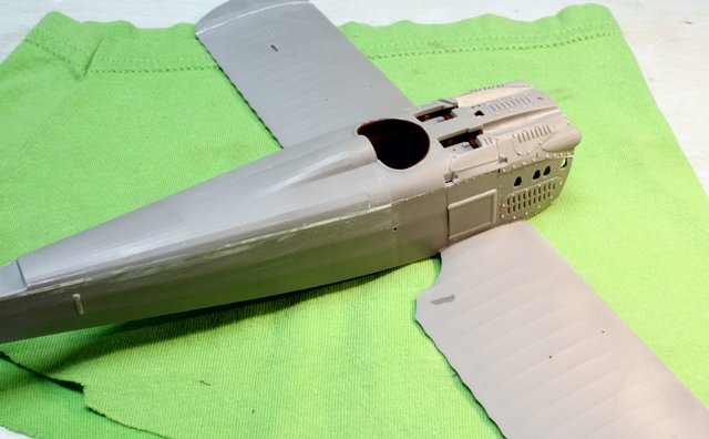

I got the fuselage top on.  I filled a gap under the edge of the engine covers with 0.010" styrene.  Otherwise, it fit fairly well.

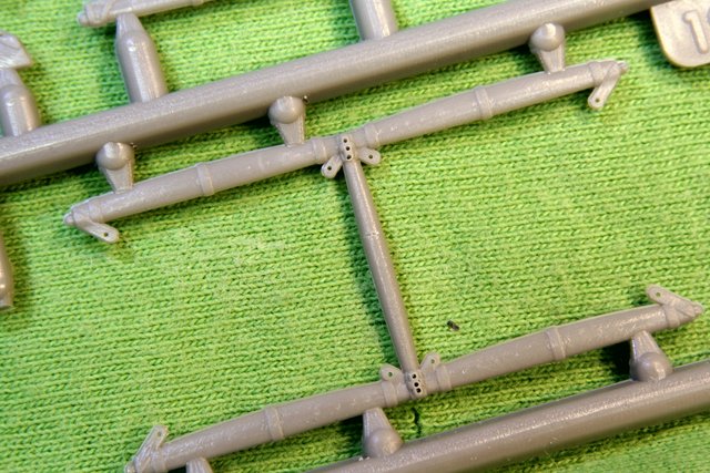

I've also been prepping the upper wing for painting, cutting roundel masks, and drilled some holes for the rigging.  I'm planning to use the provisions that Roden has made for the rigging, in addition to some of the PART PE pieces.

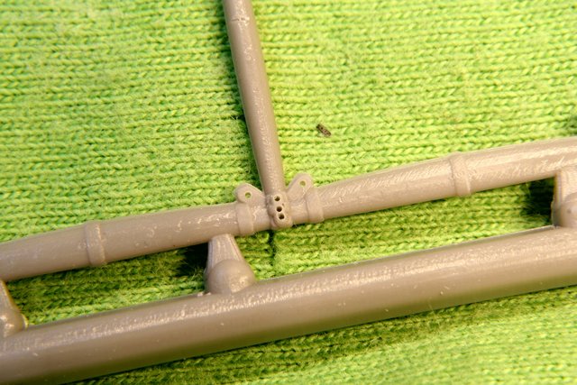

Here are some holes drilled in the rigging supports on the wings.  I have drilled 0.011" holes.  The three holes together are 0.020" apart.  I don't think this would have been possible without a mill for precise positioning.  The drill bit wanders some if the plastic surface isn't flat.
The 2 outside holes for the flying wires and the middle one is for the landing wires.

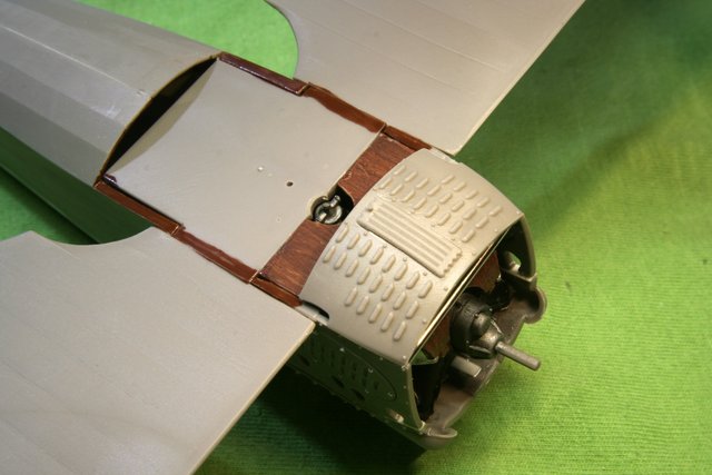

Thanks, all.  Another short  update.

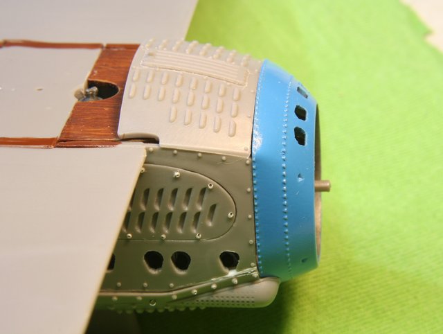

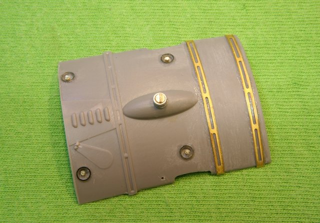

The bottom of the fuse where the fuel tank is has some detail.  Here, I've used the PART PE straps from the SPAD VII set.  Unfortunately, the VII only has 2 straps where the XIII has three.  The tank has 4 long bolts holding in place as well.  There is a drain in the sump area, too.

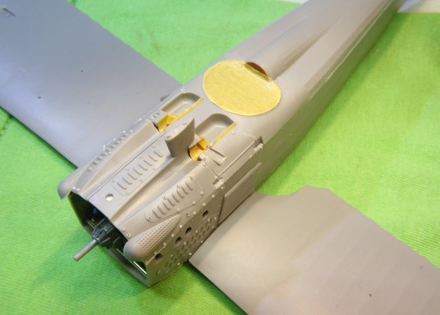

Some masking, getting ready for paint.
I have installed a spreader to widen the front of the fuselage sides to match the width of the cowling.  It's a bit overkill, but I used what was handy.
The bottom pan is installed.  One can see wood framework around the edges of the tank, so this area was painted brown.
The cowling set in place to check the fit.
I haven't come up with anything special for the louvers, so they may just get some black paint on the open ends.
Thanks for following along.
