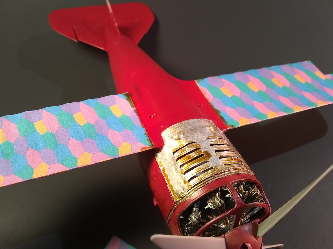

Thanks Alexis, I will give it a shot with what I have on hand. So today I made more progress. I have applied the Aviatic Lozenge to the undersides. I used the "Fresh" version as I figured this one was acquired by Udet and saw little service. Lower wing covered spanwise and upper is 45 degree angle! I also used a Mix of Tamiya Clear Orange and Smoke to simulate fresh oil stains. I kind of like the results  8)

I like the lozenge and the red fuselage.  Nice and colourful.  The clear orange and smoke looks very good. One can think you used real oil.

« Reply #84 on: May 22, 2021, 07:06:34 PM »
Veri nice effect, Richard!

« Reply #85 on: May 22, 2021, 10:02:00 PM »
Thumbs up Rick , looking very very nice !

« Reply #86 on: May 22, 2021, 10:20:28 PM »
Super work Rick, this is looking really beautiful. Those oil stains looks perfect. I watched a video on YouTube of a Bristol Scout which showed before and after photos at an air display. The oil stains looked very much like what you have done.

« Reply #87 on: May 23, 2021, 12:48:25 AM »
Amazing work on this one, Rick! I do like the extra detail and your colour rendition is superb! Regards, Marc.

Thanks Alexis. I managed to add the lozenge to the top side of the upper wing before I gave out last night  ;D
Thanks Marc. The color looks a little less bright in real life  8)
