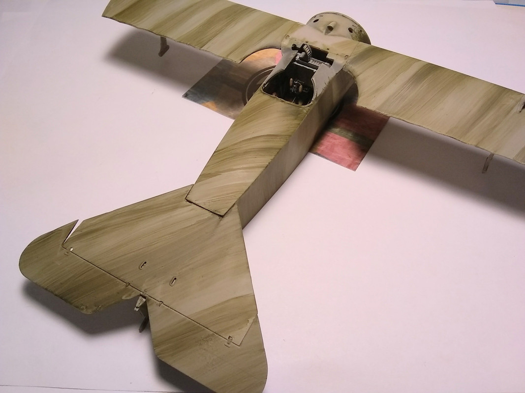

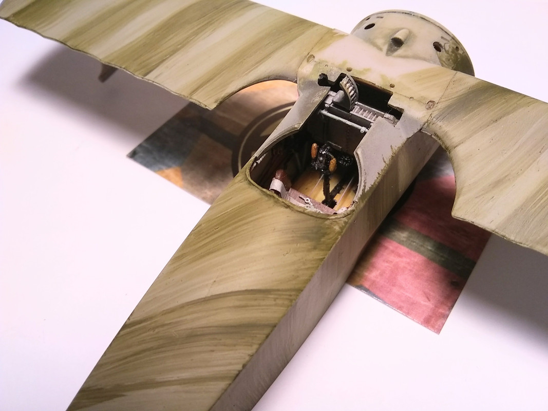

That's a beauty, Rick!  Making me think of the Meng kit I have.
Could you post a picture of the underside.  I'd like to see how the Archer stitching looks.
Thanks Ken.  I know I have confused things with deleting/crashing one kit and adding another. So here is a recap: 1. The Meng kit that was destroyed had Archer Stitching. 2. The Jasta 4 Roden kit has the Part PE Stitching. 3. The New Jasta 11 build has Archer Stitching as seen in the previous post  ::)

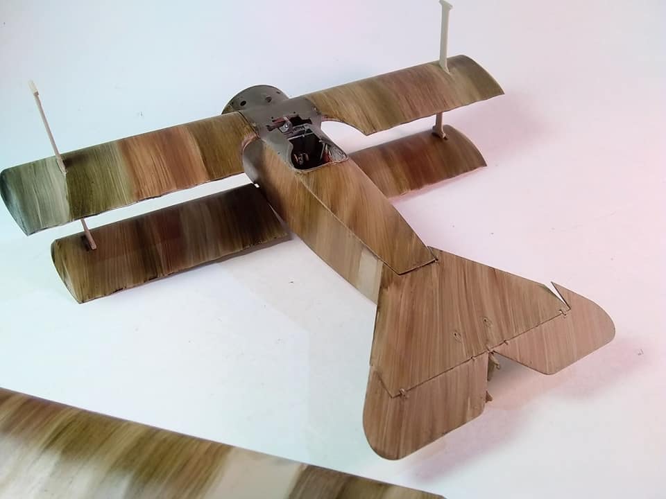

The second Roden/Meng DR1 is going fairly well. I have begun the Streaking using oils. In this case an Out of Tube OD and burnt umber. I am also doing a little "revisionist" thinking on the colors  ::) Some May like it and some not!

Thanks Terri, Steve, and Ed. I appreciate the comments. I have changed the camo on the Roden kit....More on that later. I also changed My mind on the aircraft I will model. Still Jasta 11 but 545/17 of Hans Weiss. In the Meantime a few notable points about the Meng and Roden kit: First lets examine Ailerons: There has been much said about the Roden kit and it's ailerons. So lets exaamine the options. The Fokker DR1 basically had three types:

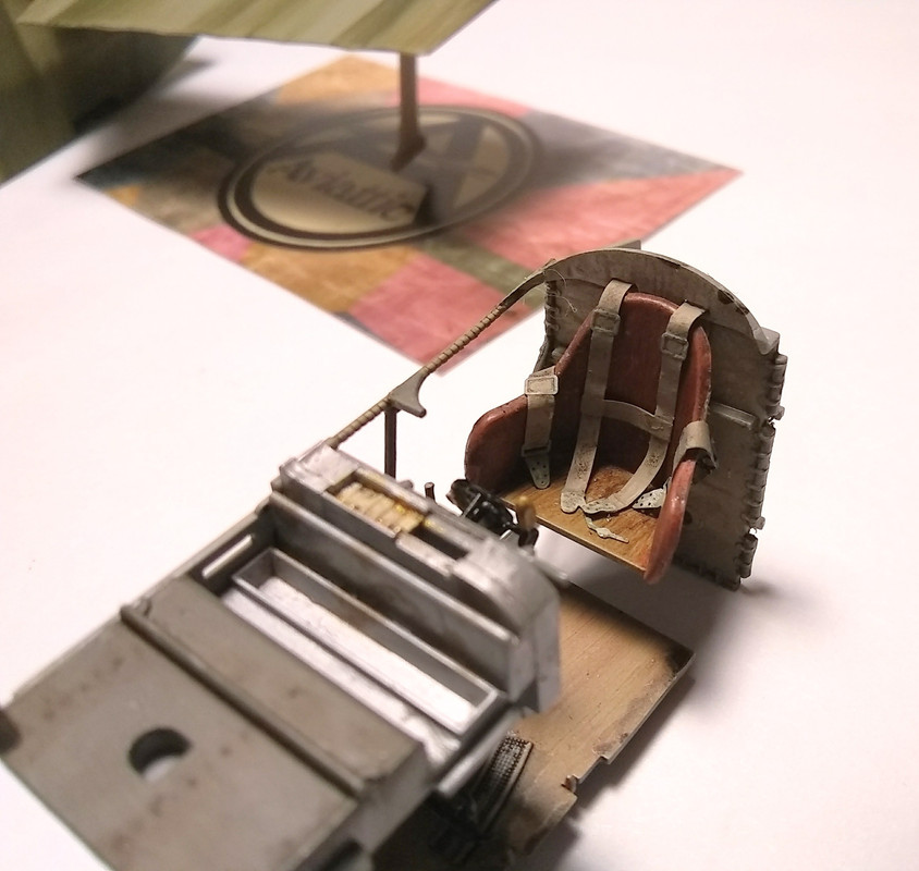

Thanks to rayb24 I now have another Meng kit that I received yesterday. I am wasting No Time getting underway  8) I noticed some detail that I had overlooked on My first build: The leading edge of the wings shows VERY SUBTLE detail where the ply covering is located. Easy to miss this and it explains why Ray Rimell said to" Mostly"  sand off the leading edge details on the Roden kit  :o  So moving along I have painted the Streaking on the Meng middle and lower wing. I also realized that No Seams would prevent me from painting the forward fuselage streaking on Kirschsteins DR1 so I went ahead and did so.
PS: I also have begun interior work on the Meng kit.

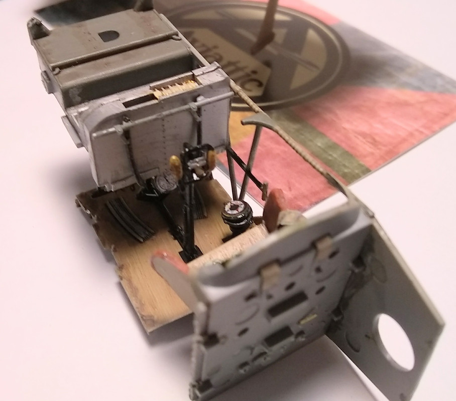

This arrived today courtesy of Richard at Aviattic. A Test shot of the interior decals for the Meng kit. The instruments are a Huge improvement over the kit supplied decals!
« Reply #313 on: December 14, 2020, 10:55:42 AM »
I made quite a bit of progress on both DR1 kits today. First I added the instrument decals from Aviattic sheet shown in the previous post to the Meng interior. Just a reminder here, if you use them remember that Aviattic decals are backed with clear so paint the appropriate color to back them. Second the sheet is a solid backing so you will need to trim as close as possible to the decal. After applying the instruments I glued the Meng fuselage together...No photos yet.

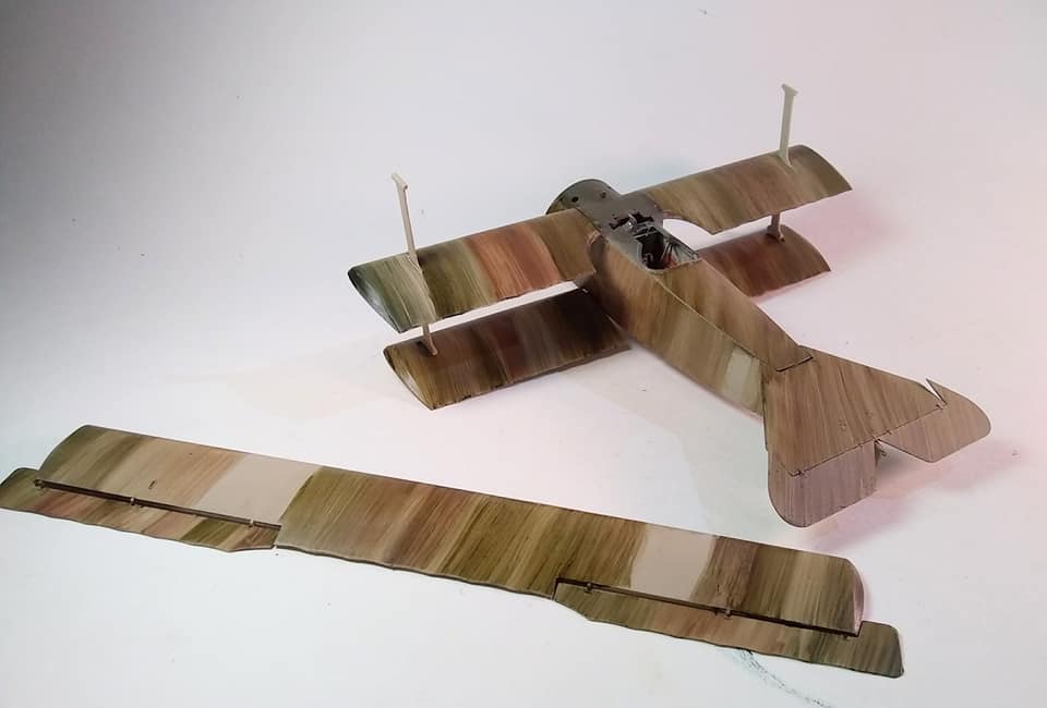

I also have finished the streaked camo on the Roden kit....for the third time. I really didn't like the revisionist scheme so went back and tried to remove the brown and add more green. The results were not satisfactory  >:( So I stripped all of the paint, re sprayed a beige-ish grey CDL base, then went back and did the streaking with oils. So since I changed the scheme three times it is only fair that I have now changed My mind on Markings three times. I went from 502/17 to 545/17, and have decided on an Early DR1 flown by Werner Steinhauser, Jasta 11 of course  ;D This gave me the opportunity to use the Early style ailerons.
Note: According to info from Achim Engels the Tachometer was Not under the ammo box where Mengnuts have it. He says it was attached to the side frame.
PS: I did add the control wires to the Meng interior before I closed it up, and The leading edges of the streaked camo will be cleaned up when the blue undersurfaces are painted on the Roden kit!
