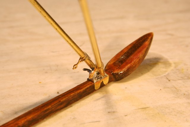

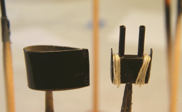

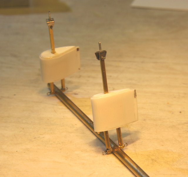

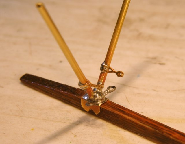

Another update.  The landing gear detail is taking quite a while.
Mock up and painting of the landing gear.
The toothpick mounting before painting.  I used PE turnbuckles for some of the cable mounting points.
Why does this feel so well-known to me? Scratching my head ... ;D ;D

Your solder work looks fantastic. What setup or method are you using to assemble such complicated structures?

Frank - I know a good idea when I see one.  Its your contribution to this build!
Kevin - Complicated structures are made of simpler ones.  Putting them all together is the trick, and in this case (as with most soldering I've done) having a jig to hold things in place is a key component.  I usually don't fabricate anything complicated - I just cob something together and solder quickly before it falls apart.
