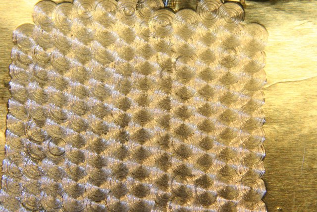

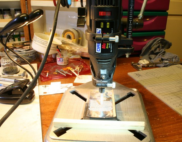

I have the turtledeck installed on the fuselage now and was continuing with other parts of the fuse, moving up to the cowling area.
I have had this idea for quite a while now and decided to try it - engine turning.
I used a Dremel drill press accessory and a Dremel tool that is made for sharpening chain saw blades.  It is a 1/8" round stone with a flat end.  In scale it makes 4" circles, which is rather large, but it's the smallest stone of this shape I could find.
I am using HVAC aluminum tape to do the engine turning on.  This will go on the firewall of the 504.  Beneath the aluminum tape is a piece of bicycle inner tube stretched around an aluminum plate.  This gives the tape some 'give' and makes a more even pattern.  The aluminum tape is taped to the aluminum plate with the bike tube on it (this is not shown in the pictures).  I clamped a piece of wood on the base to use as a guide to make straight rows of the pattern, moving the piece over after each impression.  The wood guide is repositioned for each row of impressions.
I screwed up a few times and had to reposition the piece to cover enough area.
I think it looks pretty good for the effort I put into it, especially since it will go on the firewall and not be very visible.  Next time, I will use my mill with its X - Y table to get more precise positioning of the impressions.

It looks great Ken, and very cleverly conceived!
Thanks for sharing another scratchbuild secret.

Impressive work as always Ken. The turned aluminum looks great!

I like how the effect turned out Ken , very convincing indeed.

Ken, that metal work is great, may be a bit strong.
I tried this on a smaller scale with a felt polisher, but it was not as successful as your method.

The machine turning is quite bright, but I must conclude that this is close to how it looks.  However, in scale, and after some time in the field with use and aging, it probably became quite dull colored.  Nothing some flat clear wont fix.
