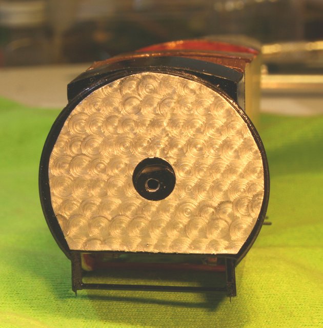

I have removed the painting masks and applied the engine turned firewall.
The engine turning looks more subtle than it does in the picture.

I am just now catching up on this one and must say how impressive your AVRO looks! The soldering of the gear, painting, and the turned firewall are awesome! The cowling really turned out to be a thing of beauty!

This is scratch building at the highest level Ken. The engine turning on that firewall is something to die for. Brilliant.
