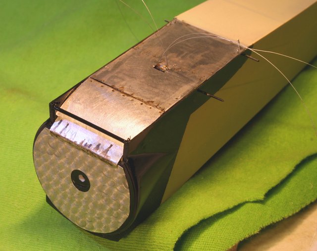

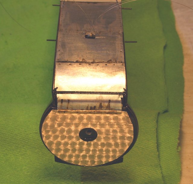

Waiting for more paint to arrive.  I have been using Model Master light ivory enamel for the CDL, but I haven't been able to find any recently.  I have decided to change my paint type again and have ordered several AK Interactive lacquers.  However, for CDL color, I will be changing to Tamiya racing white lacquer in a spray can.  I'll decant it for use in the airbrush when needed.  It's the same color as the light ivory, but a shade lighter, so I'll use it for a base color and use the rest of my remaining enamel light ivory on top of it to stretch what I have left.
Here, I've added the bottom aluminum panels and done some weathering.  The aileron cables are protruding from the pulley on the bottom and now I need the bottom wings for alignments, so that will be done next when the paint arrives.

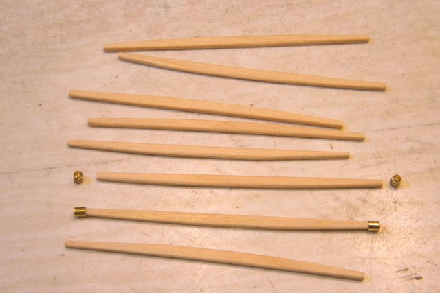

So, I've gone on to the wing struts and cabanes.  Made from wood and will be stained.  This time I'm going with brass ferrules for the ends of the struts, which will be painted black.
This 504 model has skinny struts, where later ones have much wider struts.

Those sytruts look very interesting. Which wood di you use? And where did you find/make the brass ferrules?
« Reply #127 on: December 30, 2020, 12:27:36 AM »
Thanks for commenting William, Kevin, and Stephen.
I honestly don't know what kind of wood the struts are made from.  They are made from coffee stirring sticks I found at the office.  They have a very tight grain.  I have used them on all my scratchbuilds.  Individually, they are a little too flexible, so I laminated two together with aliphatic glue and sanded them to the right dimensions with the seam going down the middle, which makes them suitably stiff.  The brass ferrules are 0.062" brass tubing that I drilled out one end to 0.051" and cut to length with a jeweller's saw.  I wanted to use the ferrules so that the wood struts don't split when I drill into them to glue in the mounting wires.

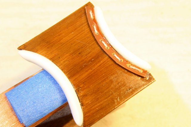

Now finally, a small update.  I now have more paint, so work can continue, but first, a detail - the cockpit coaming.
First heat some styrene and bend to a curve.
Add the rear strip.
A little paint and some sewing thread.
A look at the result.
