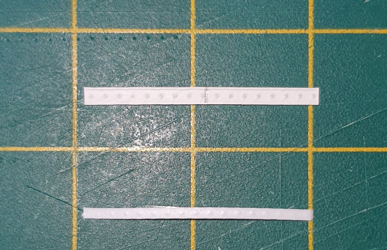

Rib tape
I considered applying rib tape to all the flying surfaces, but I decided against it. I have some good pictures of how it looked and I did some tests with a riveter tool on 0.25 mm styrene and stiff, paper. The result in both cases were disappointing. (top: paper, bottom: styrene.)
I looked on the internet for rib tape decals, but couldn’t find anything suitable. And even if I would it would be very costly, because there are so many…
So, I’ll take a 'poetic license' as Mike calls it, and leave them off.

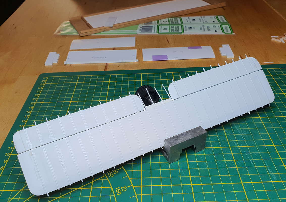

The upper stabilizer:
The trailing edge supports the 6 female hinges for the elevators, 2 cabane struts , the pivot points for the 4 rudders and 4 of the fin brackets. The spar near the leading edge supports 4 interplane struts and the other 2 cabane struts. On top are 4 guides for the elevator control cables. The four other fin brackets are mounted between the leading edge and spar.

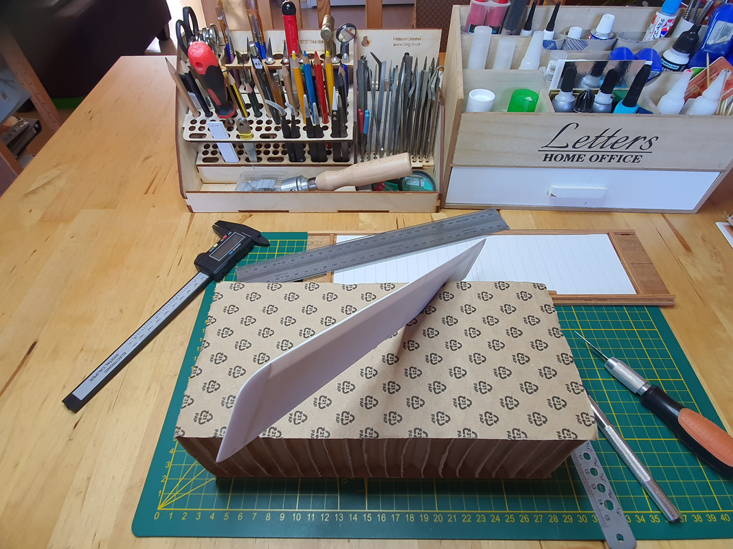

Here are some pictures of how it looks now and the jig I made, before the ribs are applied. I will finish the two elevators first, so I can align them with the stabilizer. I also have to figure out the how to make the rigging points at this stage.

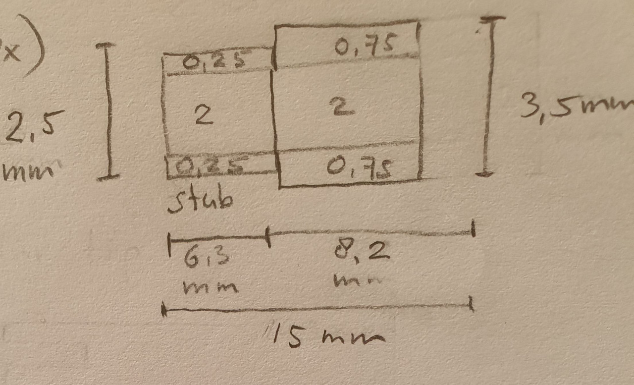

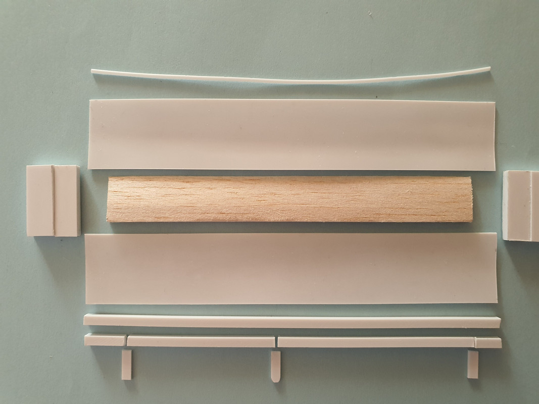

The leading edge of each elevator supports 3 hinges and 2 control horns. The middle spar has the 6 connection points for the control cables.
Here’s a layout of the parts I need for each of the four elevators.

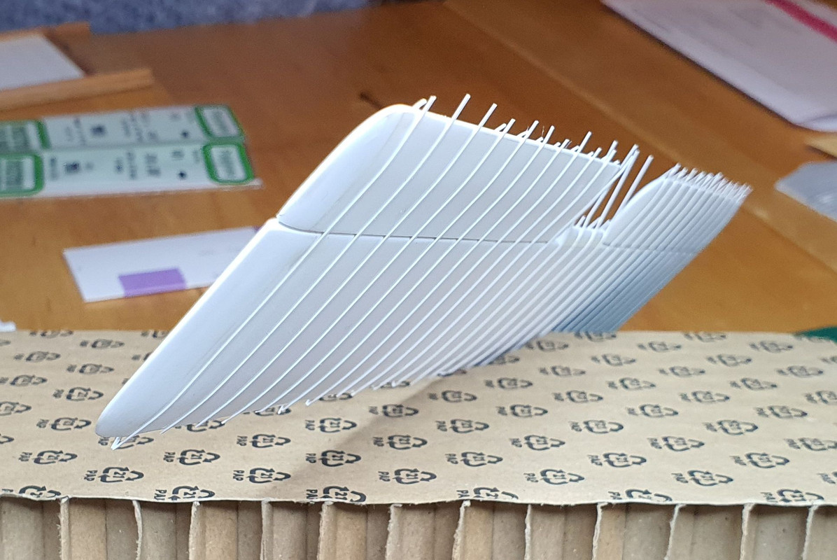

Here are a few pics of the top stabilizer and its elevators with the ribs applied. The new jig helped to allign the ribs properly. Before I clean them up, I'm going to work on the lower stabilizers and elevators first.
