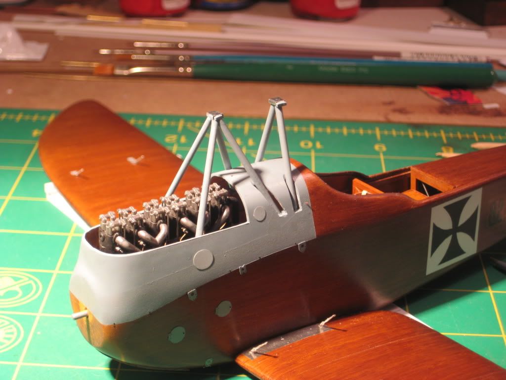

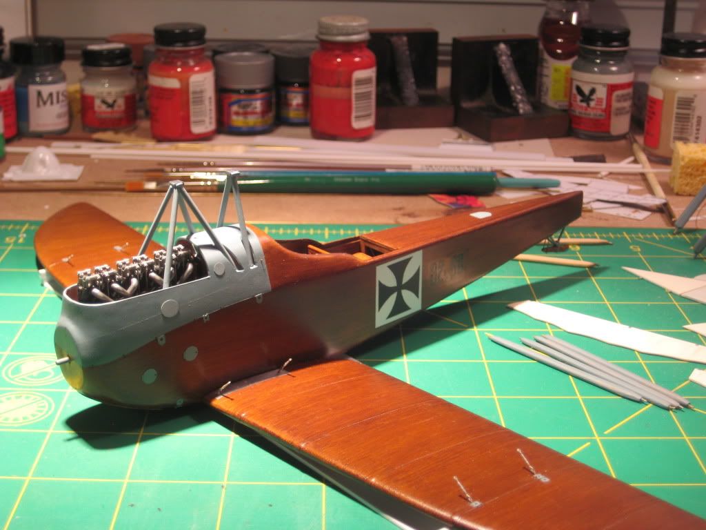

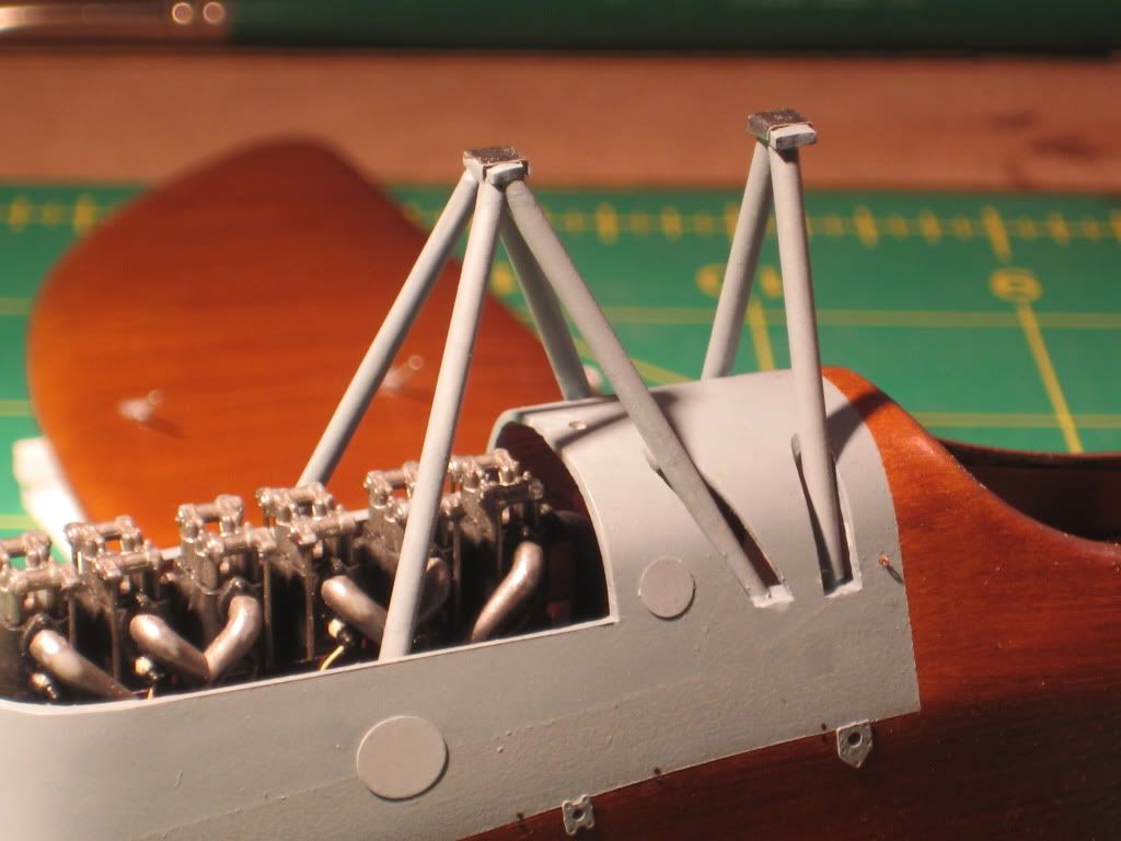

Here's a little more progress this week.  I have mounted the cabane struts in preparation for mounting the top wing.  However, before doing that I will need to complete the radiator piping above the engine, the mounting bracket for the radiator, and the exhaust pipes.  Here are the affixed cabane struts:
Further progress will be slowed by work obligations for the next week or so.  See you at the end of June!

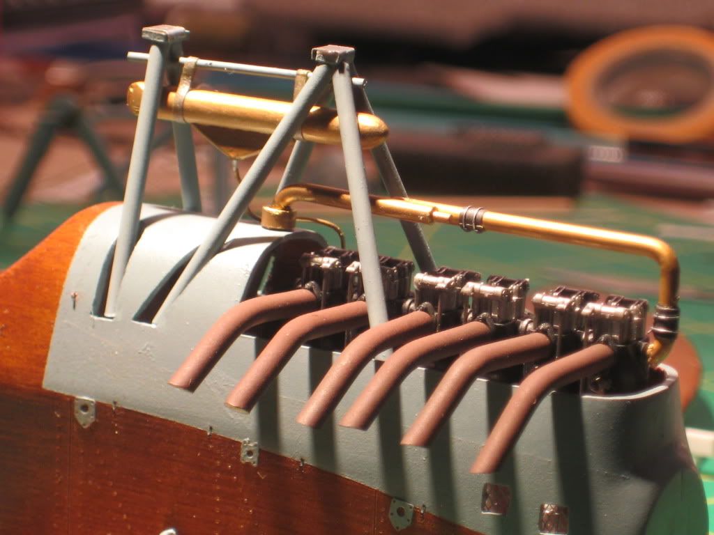

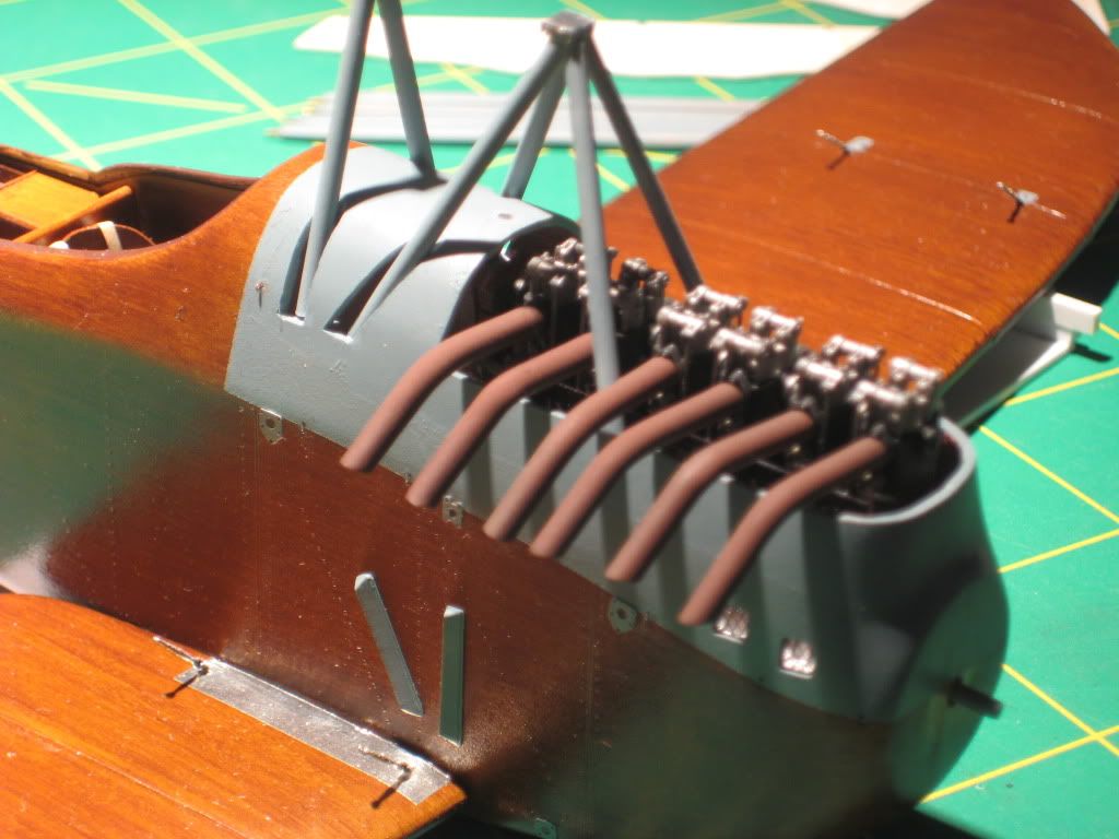

Okay, I've come up for air, so here's a little more progress.  The exhaust pipes have been crafted from Plastruct Butyrate tubing.  I chose Butyrate because it is softer than styrene and easier to bend without deforming or cracking (I also happened to have the right size in my scrap plastic box)  :).  I cut the tube to appropriate length and bent it over a paintbrush handle to match the drawings, then inserted a short length of brass rod of appropriate thickness in the attached end to serve as an attachment peg to the engine cylinders.  Here is how they look painted and tacked in place with white glue:
I have seen photos of both straight and bent pipes on Series 82 aircraft, and long and short pipes.  I suspect that field modification was not uncommon.  I like they way these look, so I'm sticking with them.
Next up: the radiator piping.  We're getting close now to the assembly jig and top wing attachment! ;D

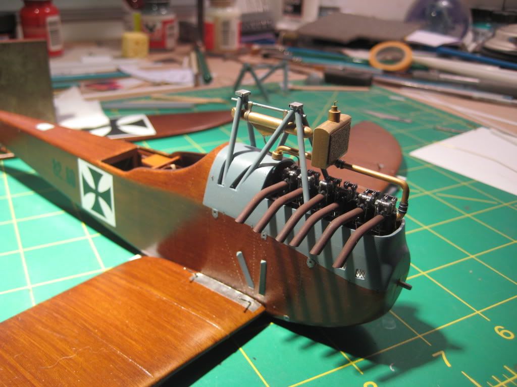

Well, the front end is beginning to look a bit busy, just as it should:
The radiator pipes and water tank are installed, but I just set the radiator in place for show.  It will require brass wire supports emanating from the forward cabane struts, and will not be permanently affixed until the top wing is in place.
A closer view:
The radiator pipes are made from another Plastruct product, butyrate plastic tubing with wire inside, which makes it very easy to bend into nice curves.  You can also trim back the plastic and leave a wire projection as a locating pin, which I did at both ends.  This was a leftover product from my model railroading days.  The insulation wraps are Tamiya tape slices painted weathered black, with silver-painted monofilament as the clasps.  The water tank is a length of Evergreen styrene tube with the ends shaped appropriately with filler and sanded to shape.  Painted tape strips (secured with CA) represent the metal straps which secured the tank.  Both pipes and tank are brush painted with Mr. Metal Brass, which gives a darker used look, IMO.  I may experiment to see if a darker wash would work to make them appear more weathered and tarnished.
I need to make the windscreen and install the radiator brackets, then the engine area will be complete.  Since the outboard lower interplane rigging runs to the top of the cabane assembly, I may do that before I install the top wing.  We'll see.  I think I will add the empennage elements soon also.  Then she'll really be looking like the avian beauty that was the Lloyd! ;D
