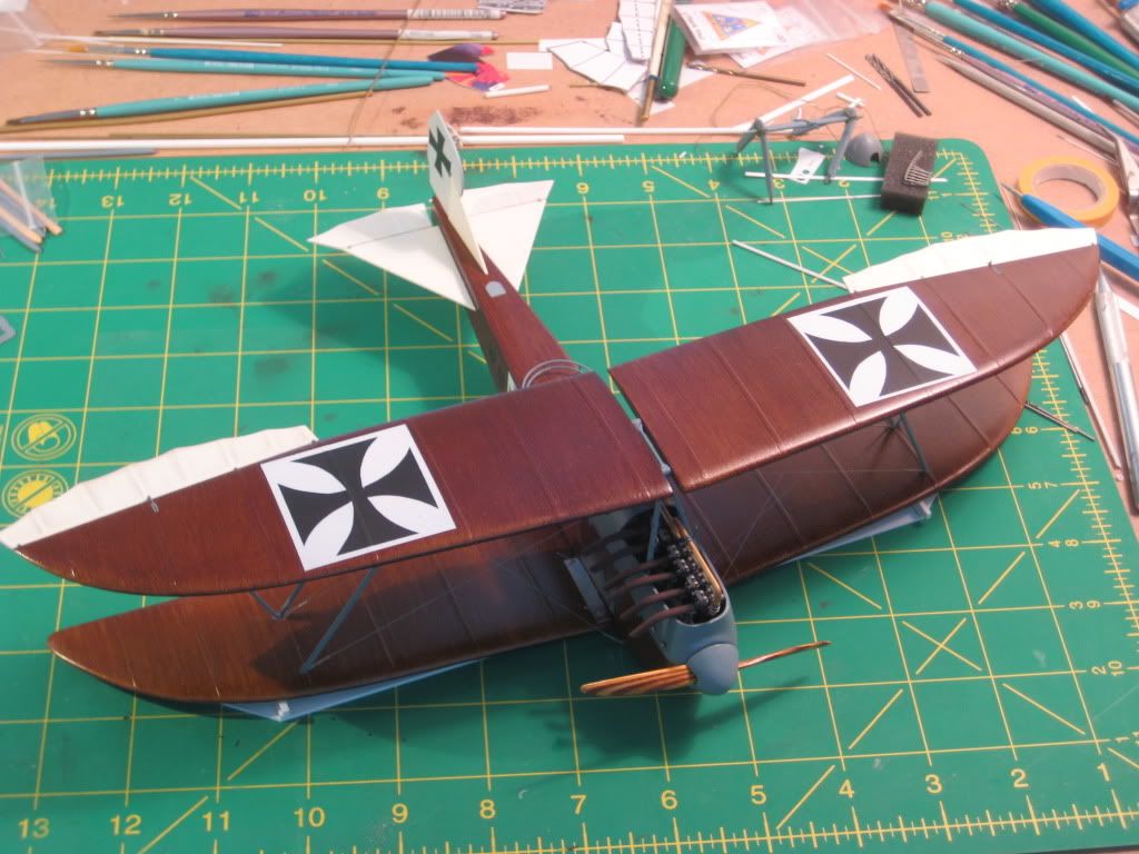

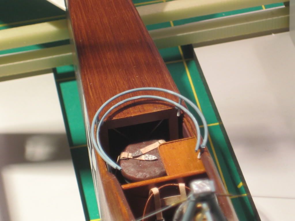

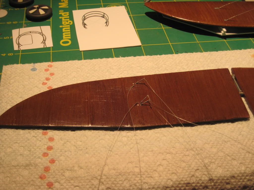

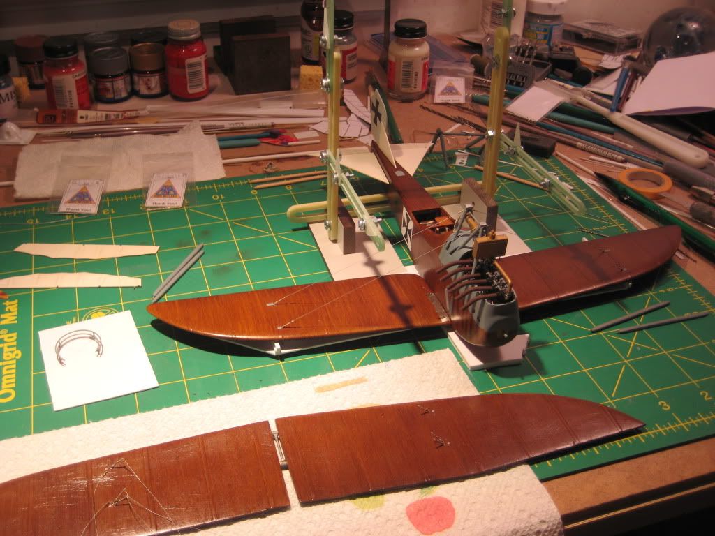

This is just a short update before I leave on vacation for 10 days, which will stall further progress.  I will be ready to mount the top wing when I return, then the landing gear, rigging and a few details and she will be done! ;D
Here is the state of the work bench this morning:

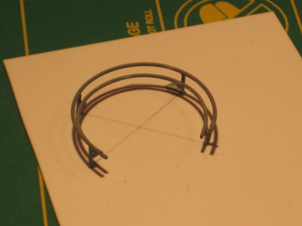

As you can see, the assembled bird is still in th jig awaiting the top wing, which now has the rigging attached to one side.  I'll complete the other side upon my return.  Off to the left you can see the completed and painted observer's cage, made from styrene rod.  Here are some closeups of everything, with the cage resting in place in the last photo
Slowly, but surely, we're getting there!  See you at the end of the month. :D

Magnificent work Bob. She's still looking like an almost completed injection kit; Scratch Building at it's best. Enjoy your vacation and I look forward to following the completion phase on your return.

« Reply #261 on: July 31, 2013, 12:59:49 AM »
 Bob,
She just keeps getting better and better my friend. I absolutely love the work you've done to date. Awesome gun ring too,must have been a real pain to get together. Keep up the awesome works my friend.

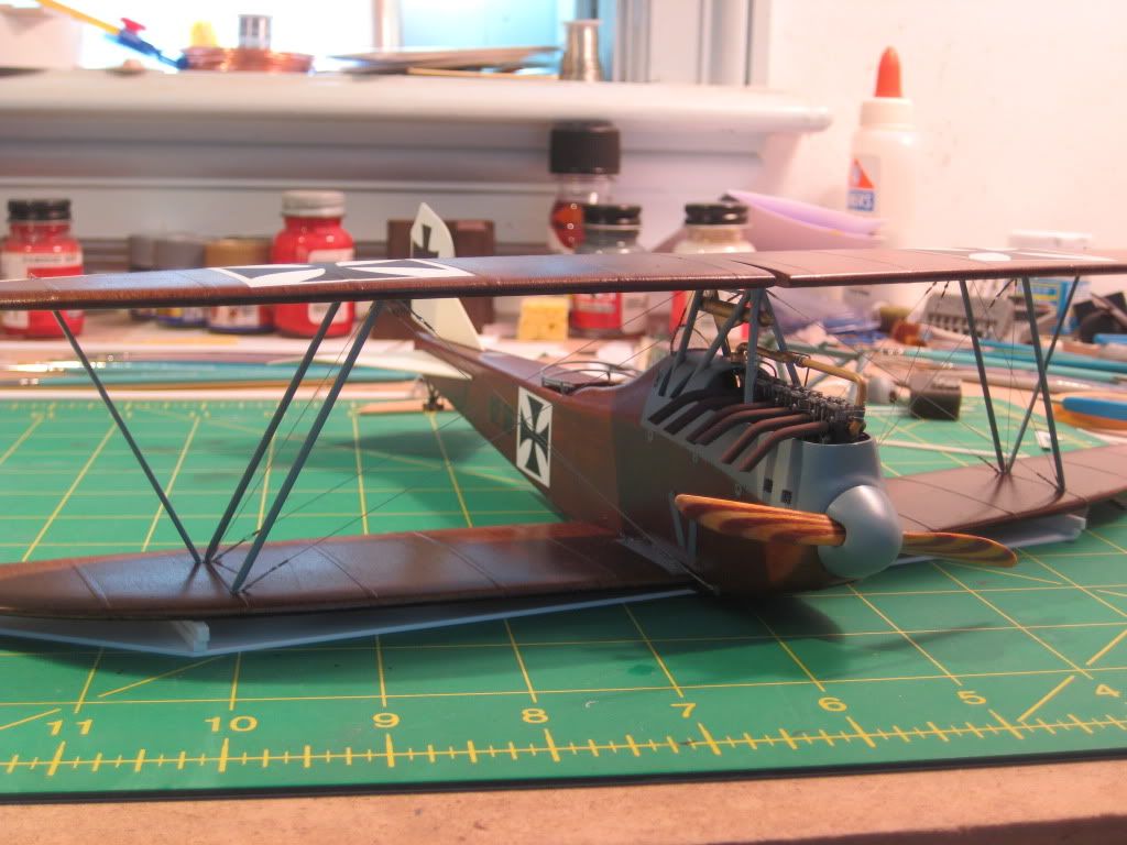

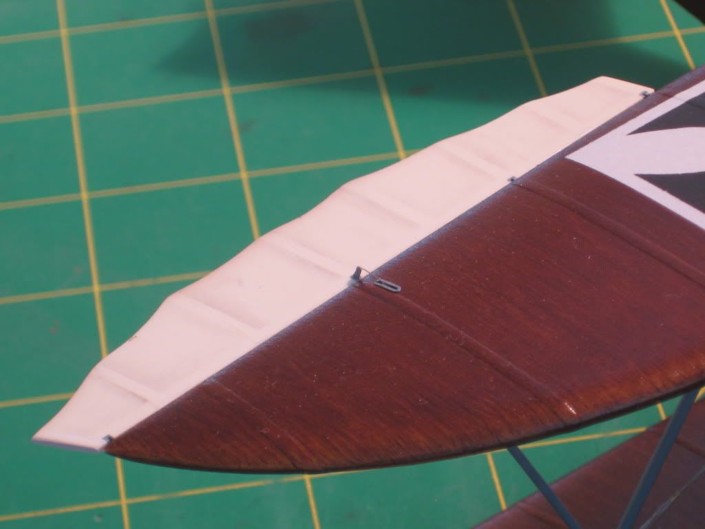

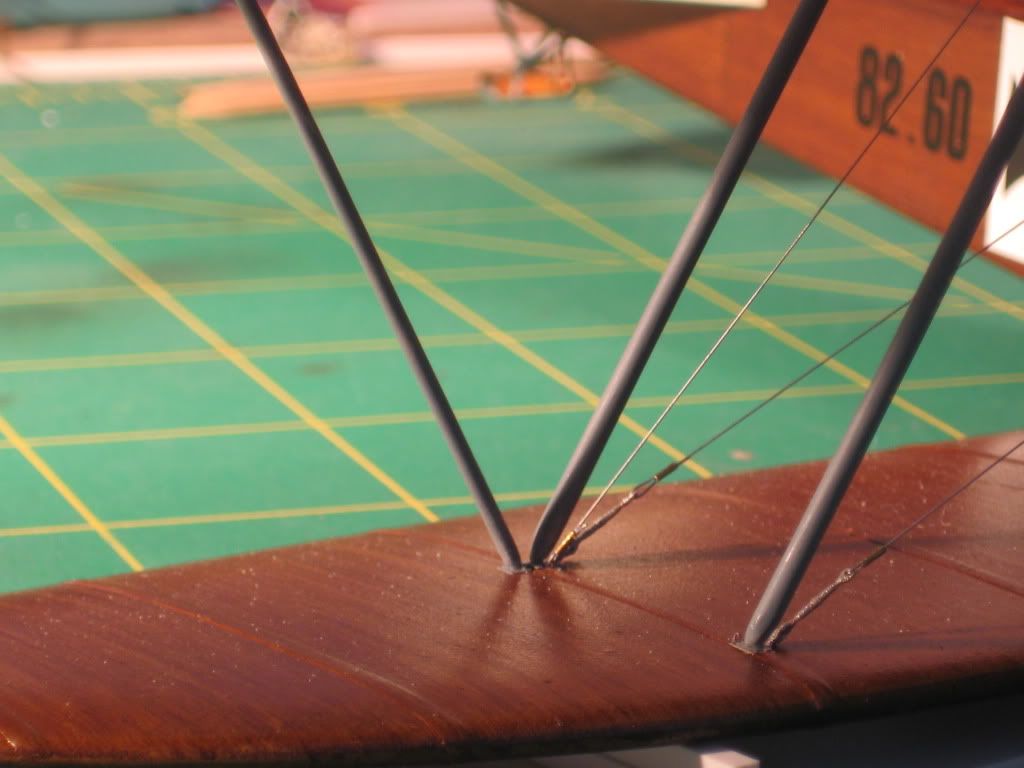

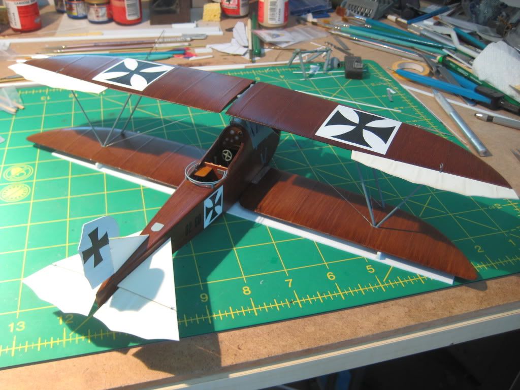

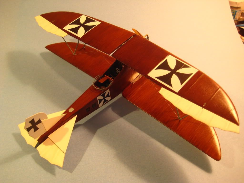

I've finally had some time to spend on this project, and the top wing is now mounted and the struts all installed (always a heartpounding adventure for me, but it worked out okay this time), with most of the rigging now completed (I have to replace two lines that didn't work out).  Here is where she stands:
The top wing mount was not without its share of adversity.  After epoxying the center support beat to the cabane struts with the top wing supported in the assembly jig, I discovered that my bamboo struts were a mm too short! :o  I made one new one, but the bamboo was still overscale and I didn't like the look, so I decided to try some 1/16 plastic rod.  I cut and sanded it to the right lengths for each strut by trial and error (my usual approach to modeling, with emphasis on the error ;)), and drilled the ends and inserted brass wire locating studs.  This all went surprisingly fast and the installation went well from that point.  The struts are not perfect airfoil shape, but they look fine to me and do the job.  They are much more scale appearance than their bamboo predecessors.
Now that the top wing is supported and rigged, I can flip her over and fix the two lnes that failed (one interstrut line had too much slack, and I pulled one Gaspatch turnbuckle out when I tried to bend it to line up with the direction of the wire).
Final major assembly step: adding the landing gear, always a hair-raising moment in my builds! ::) Hopefully she'll sit up pretty for me. ;D  After that, put the radiator back in place, add a few minor etch details to the fuselage, and she will be complete at last!  Hooray!!!  I am skipping the observer's MG because I don't have a commercially available Loser in 1/32 and I have already spent enough blood, sweat, toil and tears on this build. ;)  I declare that she is a training machine (some of the WKF Series 82 aircraft were in fact used as trainers) and thus unarmed. :D

Very nice indeed Bob, great to see this one nearing completion. You can certainly be very proud of her!
« Reply #264 on: August 04, 2013, 08:24:56 AM »
Amazing work. She looks very sleek and beautiful!!
« Reply #265 on: August 04, 2013, 01:53:29 PM »
  Bob,
Awesome update my old friend. She's looking every bit of a Masterpiece!
« Reply #266 on: August 04, 2013, 10:57:36 PM »
A true masterpiece in the making Bob. What a beautiful job you're doing here.

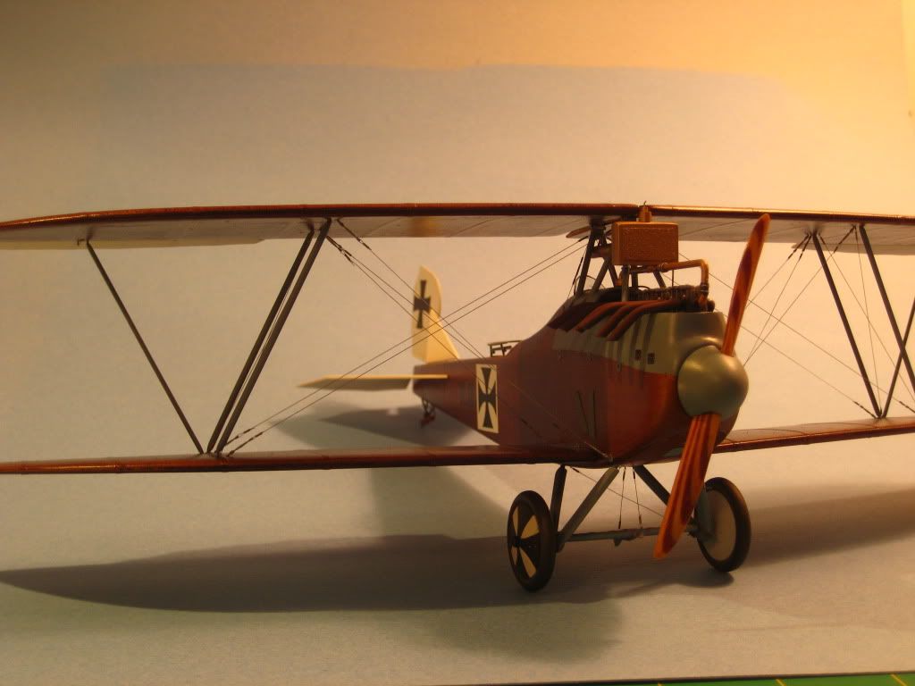

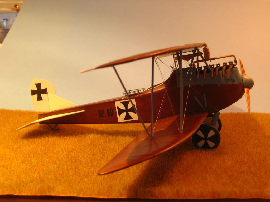

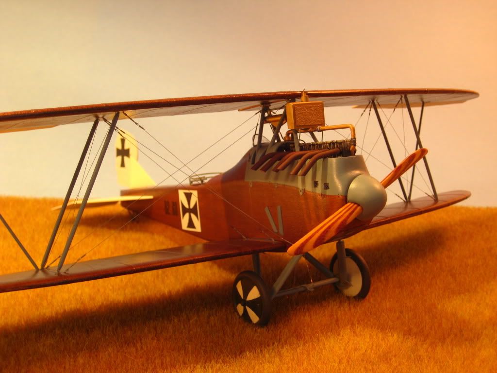

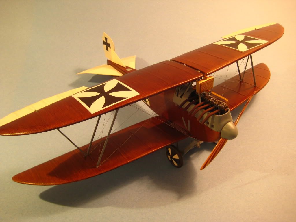

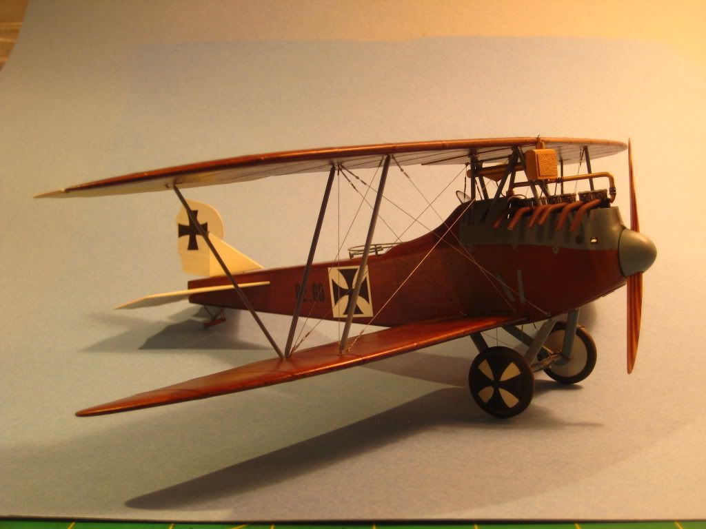

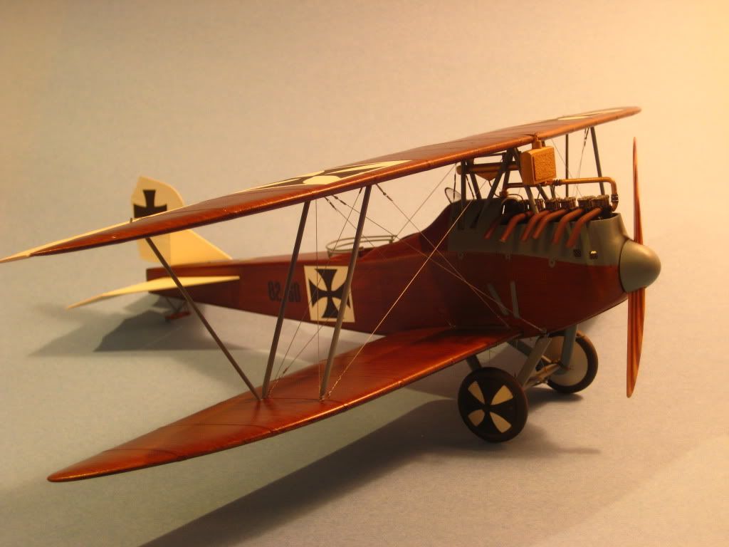

Thanks for your kind words everyone. :D  Drum roll please . . . she's finally finished!  I got the rigging fixed, and then the undercarriage installed without trauma.  Undercarriage rigged, radiator added, a few details and: voila!:
Sorry for so many haphazrd and poorly lighted shots.  I was excited! ;D  I still need to do a little weathering, and I just ordered decals for the Jaray prop logo (Can you believe someone makes A-H prop logo decals in 1/32?!), a very cool spread eagle.  Other than that, she's done!
Thanks to all of you who followed this build for a long 8 months--I couldn't have finished this without your support and encouragement. :D  I will take some better photos and post them over in Completed Models next week or so.

Wow Awesome , It looks fantastic , Hats off to a great looking model ,
