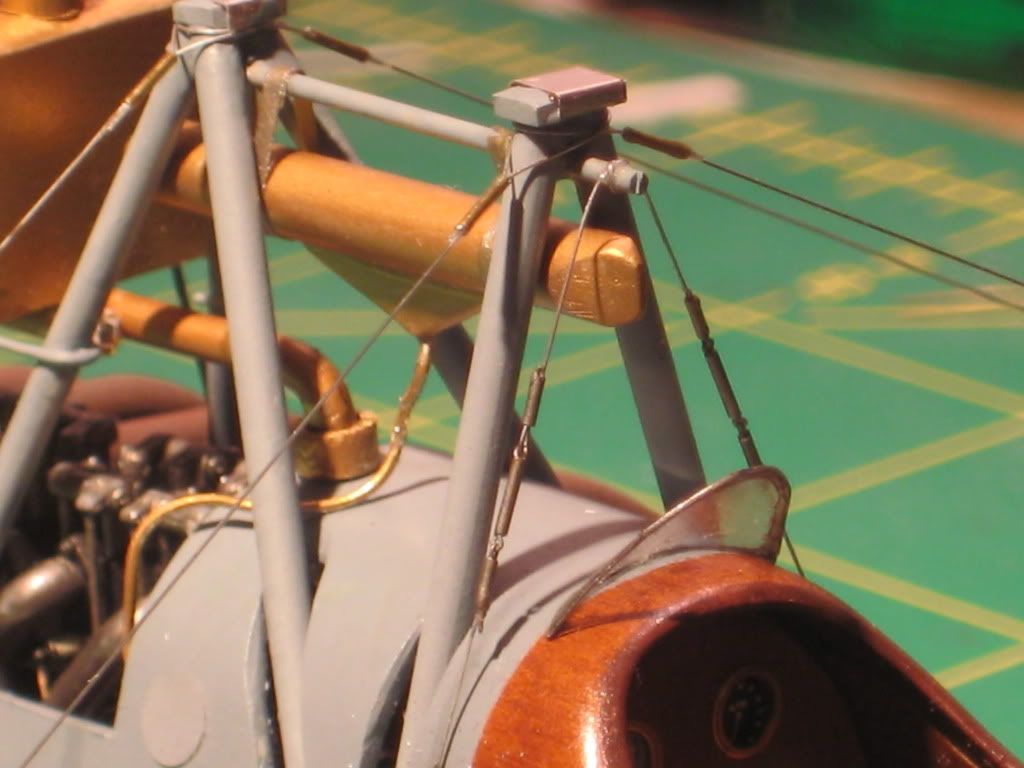

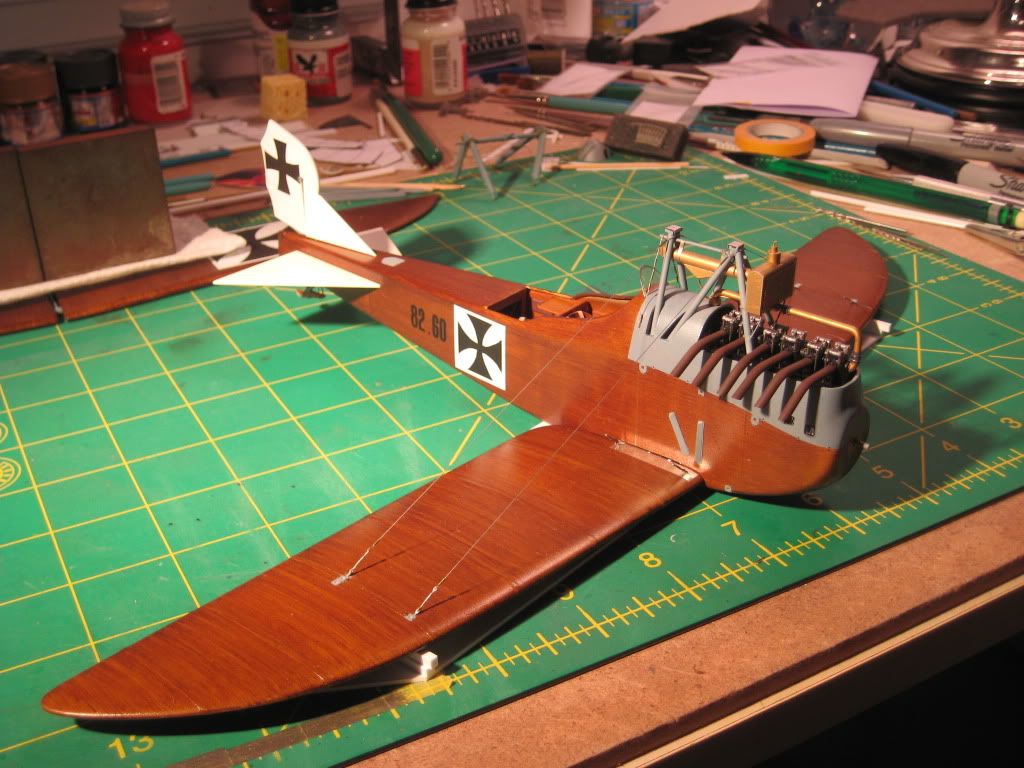

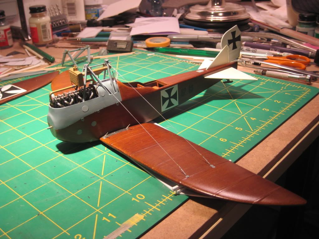

Thanks everyone! ;D  I have added the radiator supports and windscreen, and completed the cabane rigging.  I also dry-fitted the tail planes just to see how she would look.  ;)  I may go ahead and affix those soon.  Here she is this evening:
The rigging is monofilament colored with a silver Sharpie, affixed with Bob's Buckles tubes to the Gaspatch turnbuckles in the wings.  I like the way Bob's tubes allow adjustment of tension in the line before gluing, and the clean connection they provide.  The cabane rigging uses Bob's tubes and buckles.  The windscreen may have too much rake to it, so I may make another.  It is made from clear plastic bubble packaging.
Well, it seems that I am just about ready to break out the jig and place the airframe therein, preparatory to positioning and affixing the top wing. ;D  At last! (Still have to make that observer's cage though.  Wish me luck Willi!).

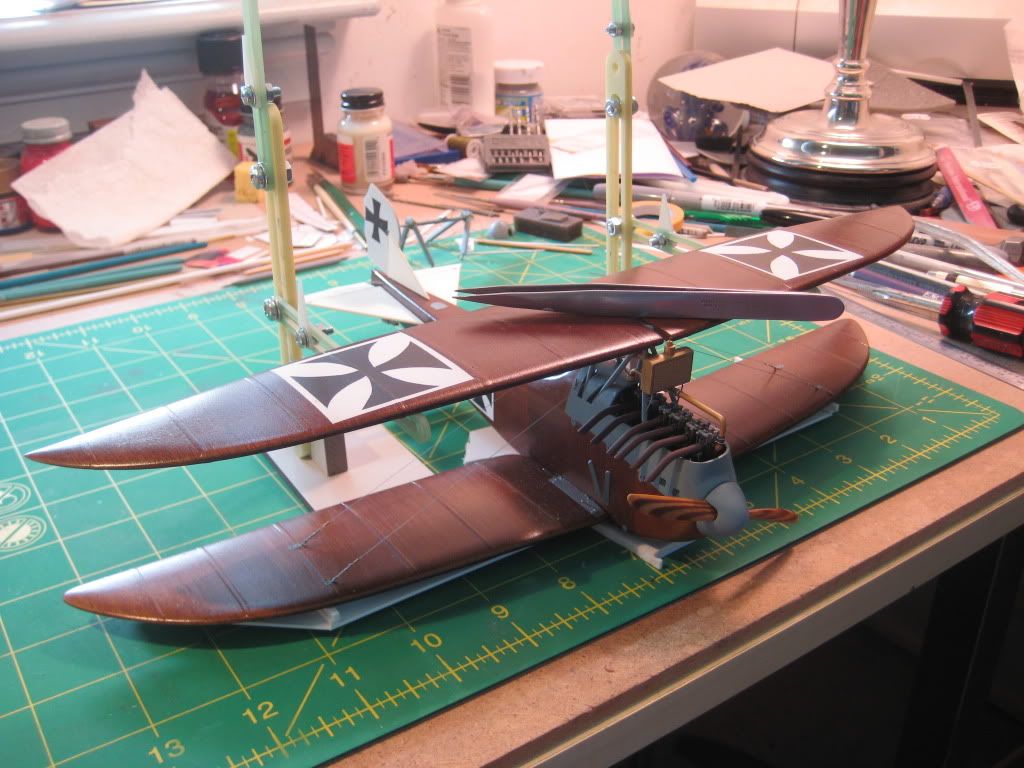

Here's a teaser of this bird in the jig, with the top wing just resting in place (the tweezers are for weight:
There is a serious side to showing this, and I am requesting your thouhts on the best way to proceed.  I have made interplane struts from bamboo skewers sanded to shape with brass pins inserted at each end, bent appropriately to establish the inboard rake of the struts.  I have drilled holes in the bottom wings for the struts, but not yet in the top wing.  My thought was to secure the top wing in the appropriate position in the jig relative the the rest of the aircraft, resting on the cabanes, and then insert the struts in their bottom holes and mark the drill points for the bottom of the top wing that way.  I will also add the rigging points, hardware and rigging to the bottom of the top wing before installing.  I've never done struts this way before, so I thought I'd solicit the wisdom of this assemblage before I foul things up completly.  ;)  Any suggestions or thoughts would be much appreciated.  Thanks!

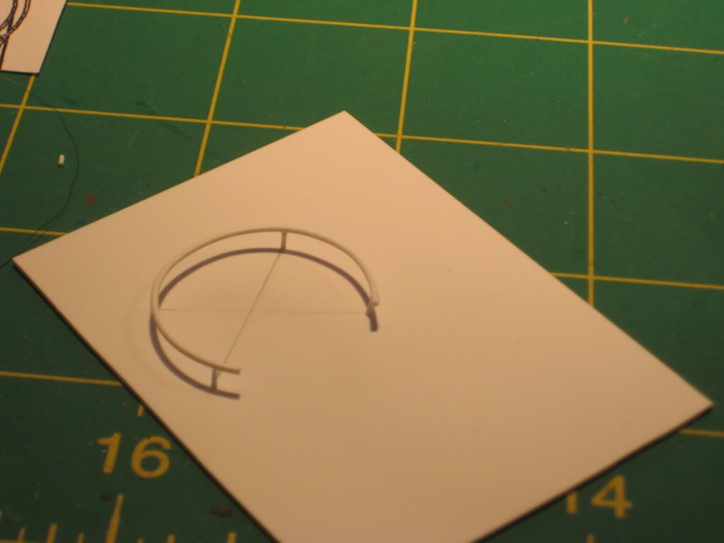

I've also started crafting the observer's cage, a la Willi's (Miami Angler's) method of bending plastic rod as shown in his build log at Swanny's for his beautiul 1/48 SH Lloyd.  Thanks for the technique Willi! ;D

Thanks Ernie!  This is my first WWI scratch build, and I did it because I really wanted a LLoyd in 1/32, and there was so much help and encouragement on this forum. :D  I've tried new things and learned a great deal.  However, it will be nice to get back to an OOB build once this one's finished, as I've been at it for about seven months now.  ;)  I'm at the most dicey part now, top wing attachment and struts---it's very different than a kit, where everything is pre-measured and engineered for you, and it's a little scary for me, particularly with those funky angled A-H struts!.  I hope I can figure it out. :o

Very nice indeed Bob,
 re the upper wing mountings: personally I would mark and drill the rigging and strut mounting holes prior to mounting the top wing, using the plans, then mount the wing, then tweak your strut pins to fit properly....I've tried it the other way around and although it fits nicely it may not be accurate, and drilling the wing when it's in place is not a good idea - you may not be able to get the drill in the correct place and angle, it can loosen the wing, and cause all sorts of other problems!
« Reply #253 on: July 08, 2013, 12:10:16 AM »
Thanks Ian.  I've looked things over and have decided to follow your recommended approach.  I think it will work just fine.  I appreciate your insight and guidance. :D
