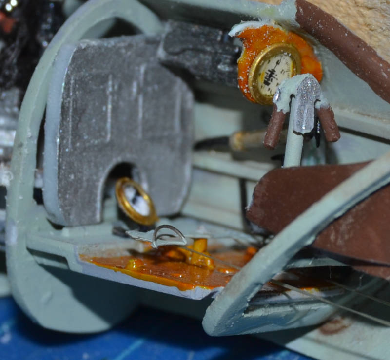

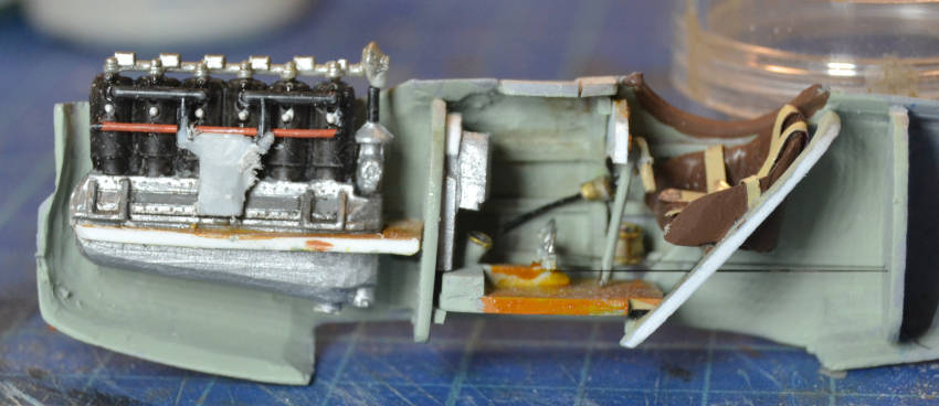

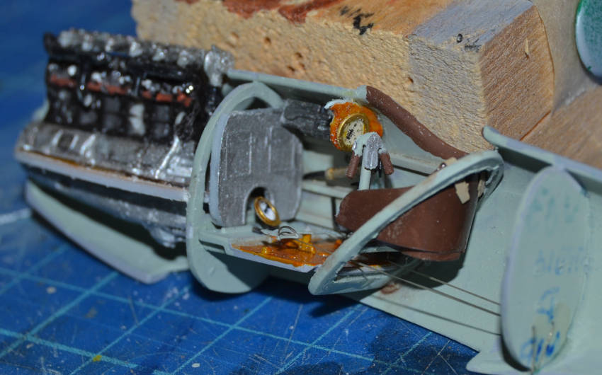

Hallo dear forum mates, I finally succeeded in getting back to the workbench for some hour, I completed the two cockpits and here are some pictures.
I ask the forum mods to move this thread to the "Under construction" section.
Thanks
BLUE MAX kit, For this kit everything was scratch built but the control stick...
here is the port half, I had to cut a bit the horizontal elements otherwise the seat woul have not fitted
Starboard half
EDUARD Kit. On this kit I was able to use some parts provided into the box.
Port half
Starboard half
The EDUARD fuselage is now closed, I am going to close the BLUE MAX one.
Thanks for watching!
Antonio

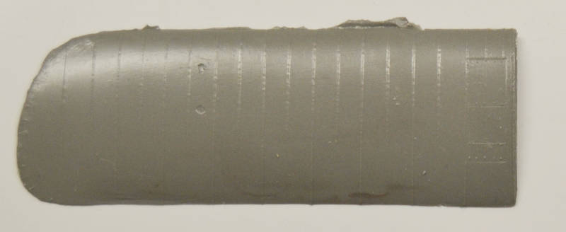

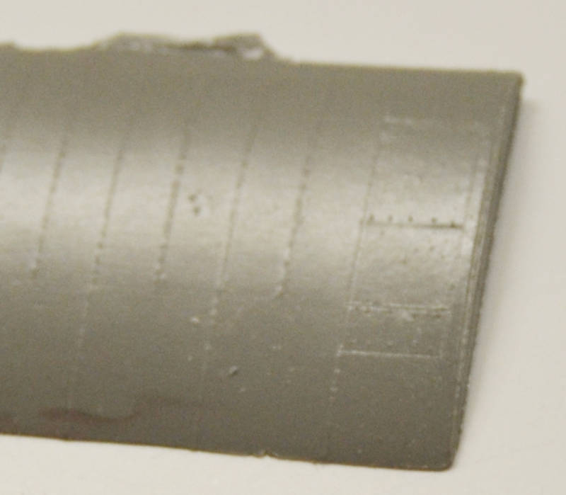

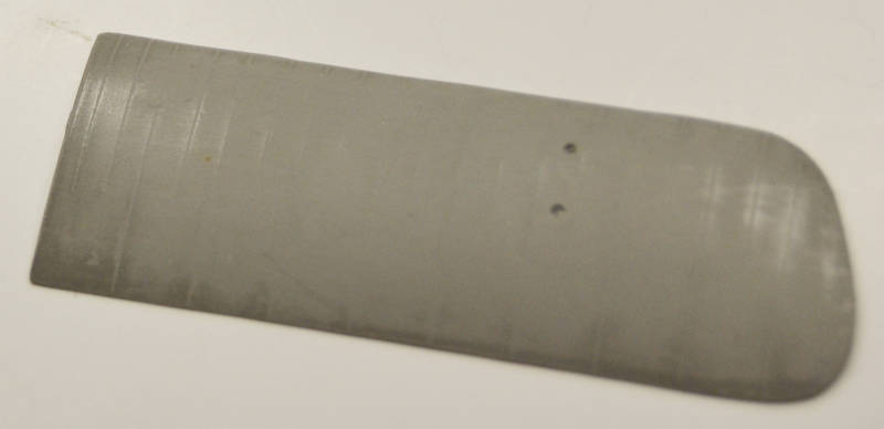

Thank you Stephen, I have closed both the fuselages, I am working now on the lower wings of the Blue Max.
This is the lower left wing as found in the box
A detail oft the surface:
Here is the lower right wing as I started smoothing it:
Here is the lower surfaces of both the lower wings:
Moreover, here they are compared with the Pfalz D IIIa at war vol.1 schemas (I hope I am not infringing any copyright)
The wings ave a wrong profile at their tips and I am shaping it better, but they also appear to be larger but I won't dare filing that excess...
Thanks for watching.
Antonio

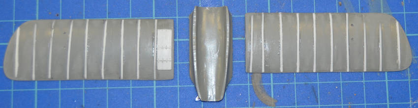

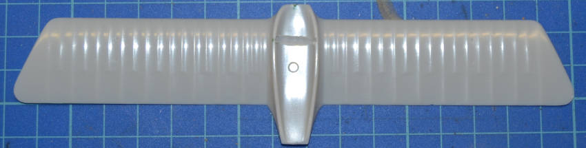

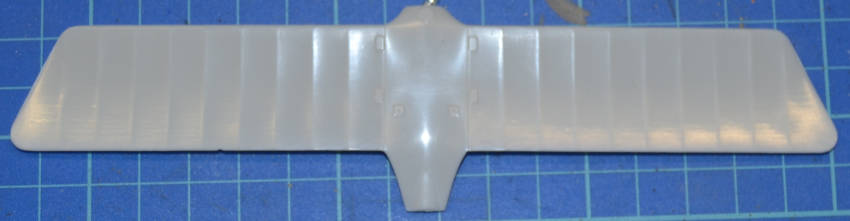

Here are the lower wings of the Blue Max (DIIIa) slightly improved on the shape:
Here are the finished wings: I smoothed the surface and used some plasticard strips (Thickness 0.25 mm, width 1 mm on bottom surfaces and 0.75 mm on top).
The white details are scratch built by me.
The center section in the BM kit is separated from the wings and I will use pins to get them together, the Eduard kit is better having cast the bottom wings in a unique piece.
