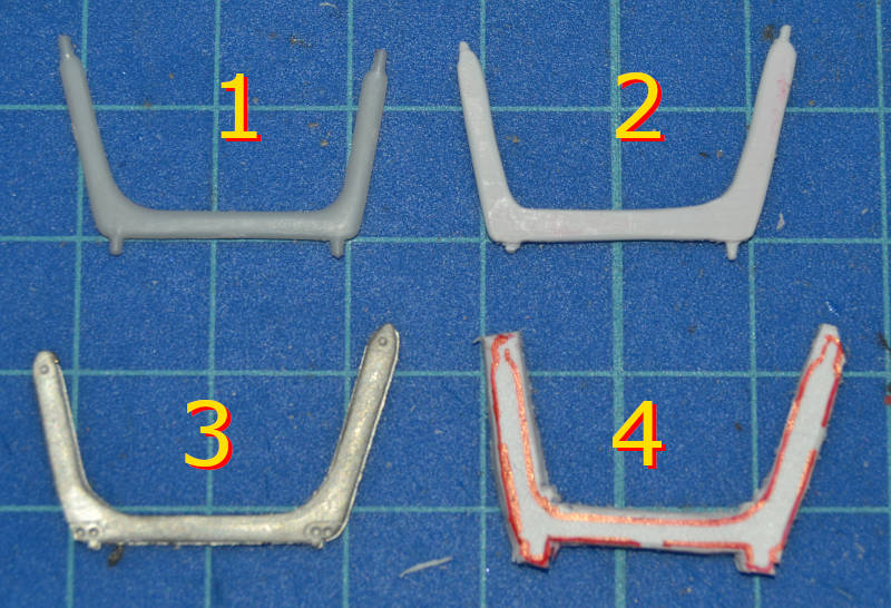

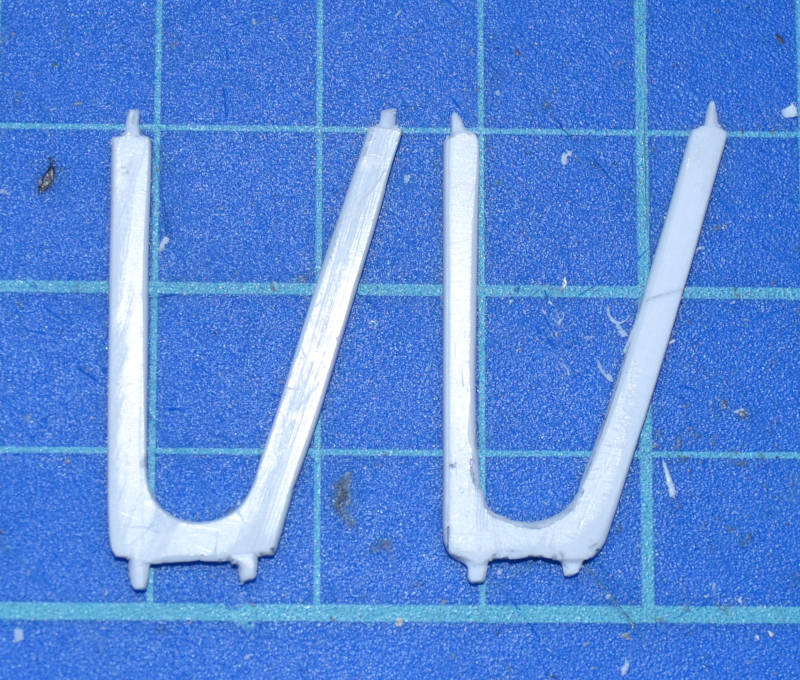

As I had done for the interwing struts of the Blue Max DIIIa, I made from scratch the cabane struts of the same plane, as the other struts they came in white metal which is difficult to polish and to handle and has an uneven surface I don't like.
Here you can see, for comparison sake:
No.1 - one strut of the Eduard kit
No.3 - the Blue Max strut in white metal
No.4 - the "raw" piece I cut from a plasticard sheet 1 mm thick before being worked
No.2 - the first self made strut ready
Here are the two struts ready, you can see the great flex-i-file tool I use a lot in these cases

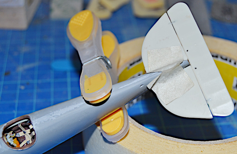

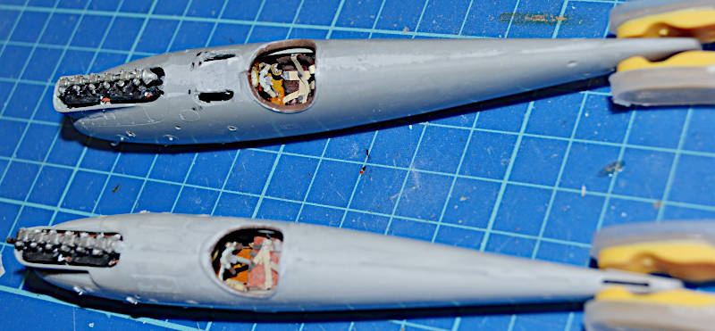

I had closed and sealed with putty the two fuselages:
And I took care of the tail of the Blue Max, from the Black Dog resin kit I had purchased.
Holes pierced in the fuselage:
Pins inserted in the horizontal planes
And this is how it looks all together onto the plane...
There is a gap due to the thickness of the Blue Max rear end, although the tail planes are not fully on their place and the gap should show less once glued all together, I think I will file a little the left stabilizer.

Re: Pfalz DIII / DIIIa 1/48 Group Build After Build
« Reply #88 on: June 22, 2020, 09:06:31 AM »
Nice to see these ones back on the bench , both are coming along really well so far :) :) :)
« Reply #89 on: June 23, 2020, 12:18:55 AM »
Great to see you going on these two again! The two fuselages look amazing glued together. With a bit of work on that left side I am sure you will nail the tail plane and elevator! I am looking forward to your progress!
