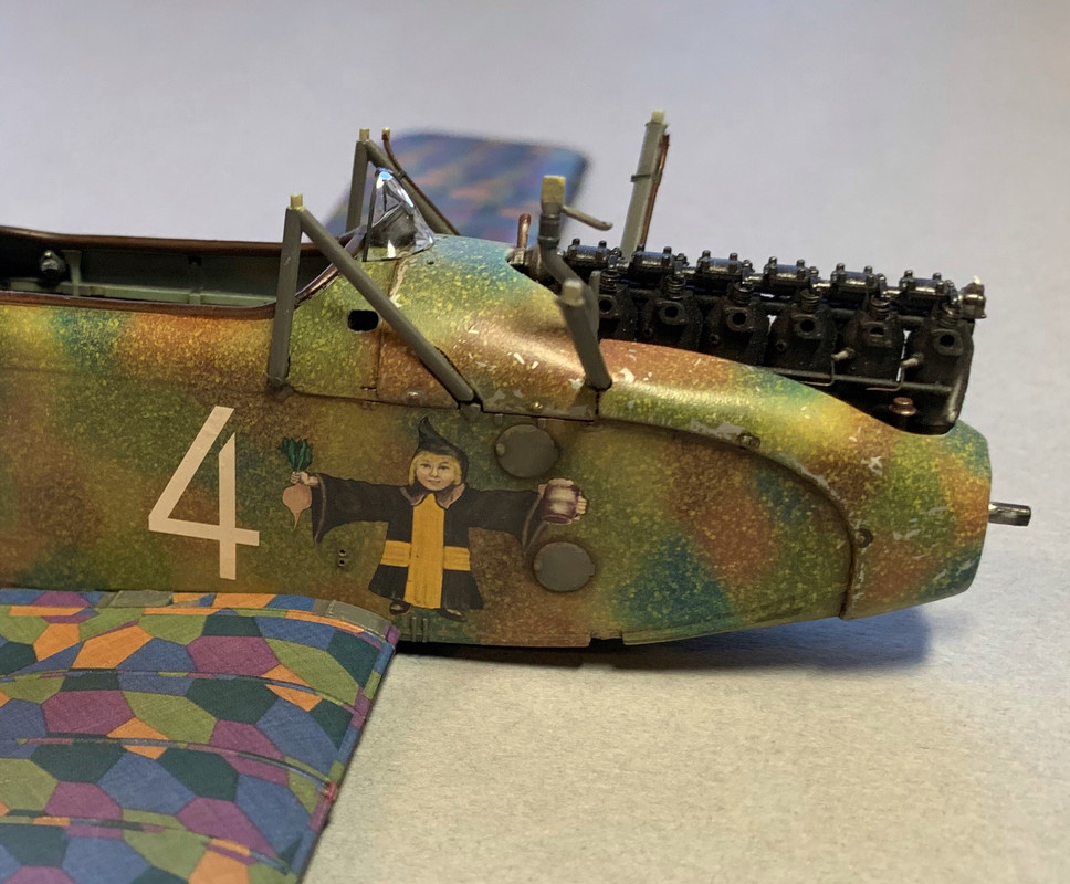

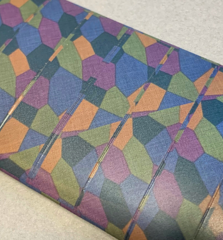

Lozenge complete. The Aviattic cookie cut lozenge really is a treat. Great to work with, tough yet very thin...
Stickers on, weathered & sealed in. Now, I did have major problems with the Wingnut decals; not a statement I thought I’d ever use. But, they took an age to soak off, nearly all cracked with handling and I had some adhesion issues too. Even after they were finally stuck down I found some areas on the national markings lifting in small pockets, even though they’d been sealed in.
I’ve emailed Richard at Wingnut’s for info. It’s a shame, because although all looks fine in the photos (with a little PS touch up) it doesn’t quite cut it to the naked eye, which means I would be loathe to put it on a competition table (which I enjoy doing at Telford every year ::) )
I’d be interested if anyone else has this issue. Incidentally, I mentioned it to Richard at Aviattic, and he said there’s, believe it or not, a worldwide issue with rubberising agent...
Anyway, all looks ok in the pics...
Actually, you can just see a little of the lifting I mentioned towards the top of the ‘4’ if you look closely...

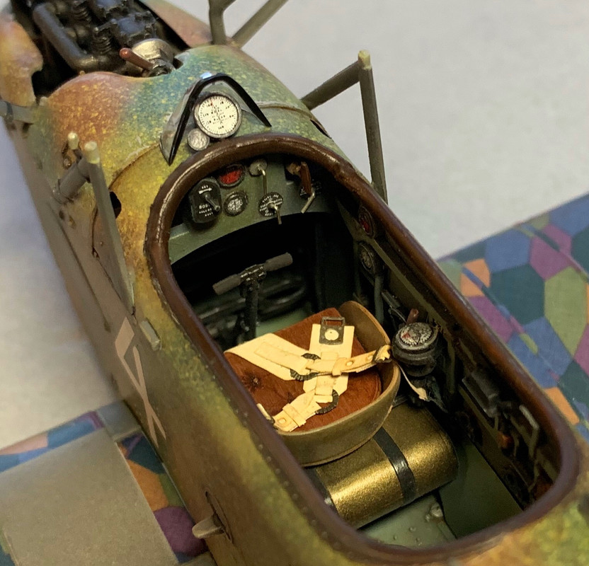

Quick view of the cockpit before I put the scarff ring on...

More Guy goodness, thanks for the update and I see the lifting in the shot.

Wow Guy, great update, those Aviattic cookie cut lozenge look awesome along with the rest of your build.

Guy, again a great update with result, that makes me speechless!
Really pitty about the decal issue. May be you can put thinned white glue below?
But in one thing you are wrong:
Since Scarff was a British officer and gunner the weight balanced Scarff ring can be only found on British aircrafts and not on german ones ...
... but I know what you mean ;)

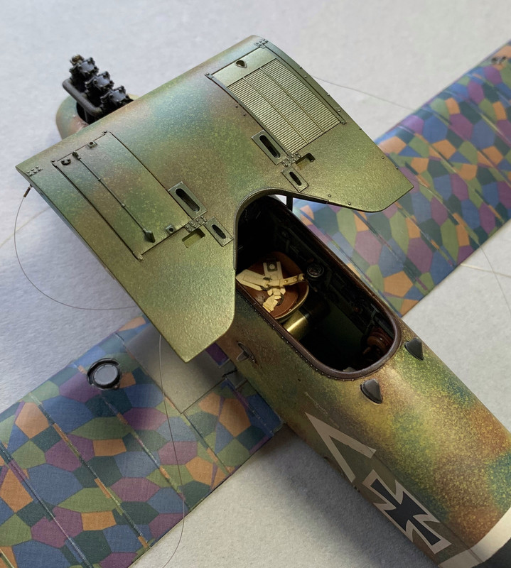

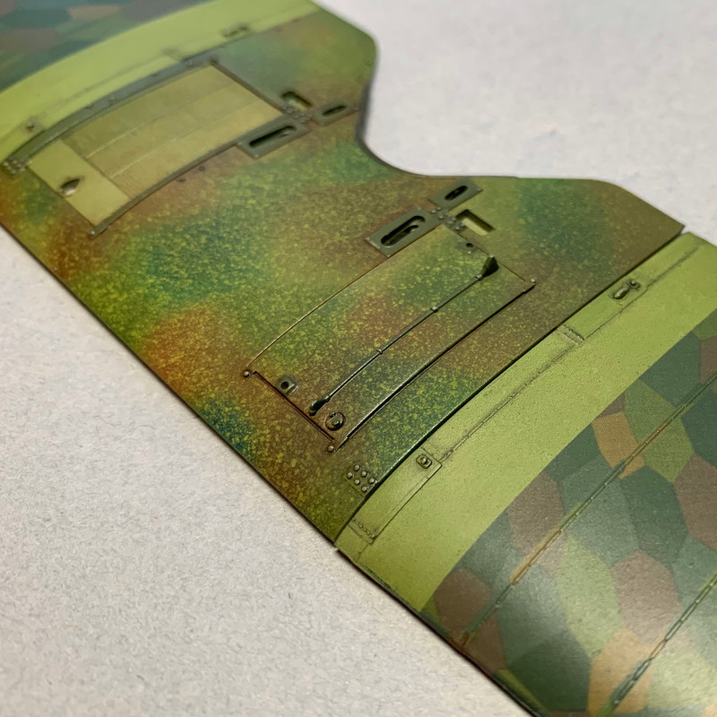

So almost finishing off really... top wing done, decalled and then a green glaze as per Wingnut’s recommendations.

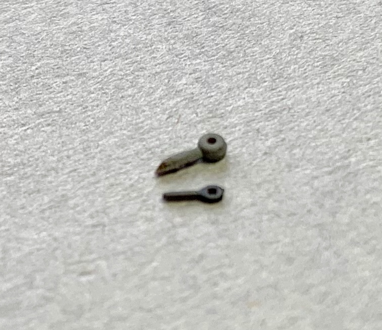

Top wing on and a start on the rigging. I’m using Gaspatch’s resin anchor points and one end turnbuckles. Beautifully moulded and a little finer than their metal counterparts, but equally a little brittle, but I haven’t had any issues so far... will let you know how I go. I find the whole top wing attachment thing infinitely easier when there’s a centre section. At this point I’m pleased I spent the time aligning and masking the struts as the centre section just popped into place - hardly any need for glue even.
Little out of focus, but this is the resin anchor point next to the kit one...

Guy I love the sheen you have on the model, what clear coat have you used?
