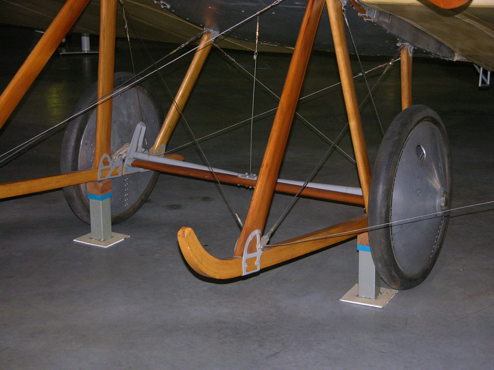

The kit parts. Wanted to use them, really!
But the axles are to short for the spoke wheels (but correct for filled plastic ones). The middle strut was only there on some Tabloids, but - you guess - not on this Russian one. In the manual was nothing stated about it, just on the box cover and the painting page it was visible.
Additionally I have looked at pictures of the replica from Hendon ...
Source: abpic.co.uk (Air-Britain Photographic Images Collection)
And found a lot of fantastic pictures in high resolution here:
http://www.maquetland.com/article-phototheque/5982-sopwith-tabloid-hendon
One example:
After some work with pear veneer, including bending with steam, this is the result:
All struts are secured with brass pins, also in the skids:
I think, this looks better!
And matches the datafile drawing.
