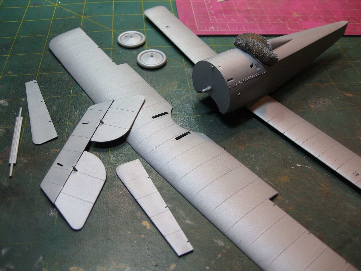

   Mark, I've got the wings on; I measured the dihedral as 3 degrees on the data File 3 view and CA'd them in place using a brace at each tip to ensure the angle.
    I also completed the painting of the silver dope overall using Tamiya Flat Aluminum acrylic however it resulted in a really terrible finish and, after some hand wringing, I stripped it all off using Windex which worked beautifully. I then tried a second base coat using Model Master enamels, 10 parts of their Aluminum #1781 with 1 part #2055 USN Blue Grey to tone it down a bit. This produced a good finish to start with however I can't publish photos right now as Photobucket appears to be down. My plan is to add some Alclad II to the forward metal portion of the fuselage to provide a little contrast, add the national and serial markings, and then post shade the entire model. I'm still not sure about the markings, whether to use the decals I have or use the Miracle Masks from Mal Mayfield. The latter method would be my first attempt at the masked markings technique and I'm a little intimidated by it.
    I'll be away for the weekend but hope to be back at this on Tuesday of next week, more to follow and hopefully photobucket will be back in operation by then.
Re: Hobbycraft 1:32 Scale Nieuport 17- Capt W.A. "Billy" Bishop V.C.
« Reply #125 on: October 28, 2016, 07:26:56 AM »
    Just found Photobucket working after being down most of the day. Here's the main components with the second (enamel) silver dope finish:
  ....and a closer view of the finish:
    It should look better with a coat of clear over coat after the makings are added and the post shading and weathering completed.

I like your finish/paint mix there Lance. I've been pondering what I'm going to use on my Noop builds, and plan on doing some experiments on some scrap to see what will work for me.
« Reply #127 on: October 28, 2016, 02:23:14 PM »
Beautiful finish, Lance!  What did you use?  I really like it.
« Reply #128 on: October 28, 2016, 08:30:36 PM »
I agree with Bud, and have the same question. Excellent finish!

    The finish is ModelMaster Enamels as described in the post just before the photos above, I seen to return to the "old" enamels whenever I get into difficulties.

Very nice Lance. I like how you described your difficult decision to re-think the finish, and used a different approach to get a happy result. I think we all struggle when it comes to those difficult phases of model building, and some just put it back on the shelf and start something new  :-\ Hopefully your little tale will inspire others to "plod ahead"  :)

Re the 'silver' - Though I prefer using Tamiya acrylics to all others I've never had particularly good results with their metallics. Paint of choice in that direction has always been Alclad but recently I bought some of the AK Extreme Metal range and though having only test sprayed them onto a plastic card panel I was very impressed with the finish and smoothness of application. With no lacquer smell like Alclad either I'm looking forwards to using them in the near future on a project. (I have a feeling I may have said this before, if so, my apologies - call it an age thing ::))
