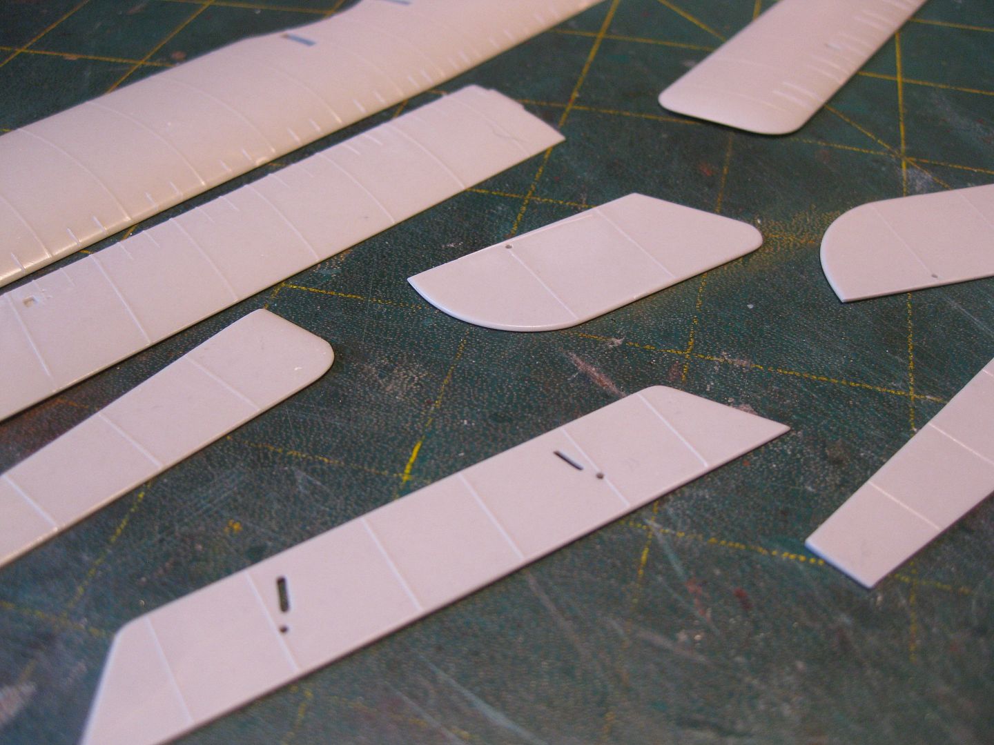

    This is a very simple little kit, the total parts numbering around two dozen. The basic molding is good, measurements and accuracy quite reasonable, and it provides a good platform to produce a decent model of the subject. Detail is lacking however, and thus the large number of A/M bits to be accompanied by some scratched additions. Last, I find the plastic difficult to work with. Unlike the soft easily worked plastic in Roden and Wingnut's offerings it is extremely hard and very brittle; care must be taken to avoid breakage, especially with the more delicate parts.

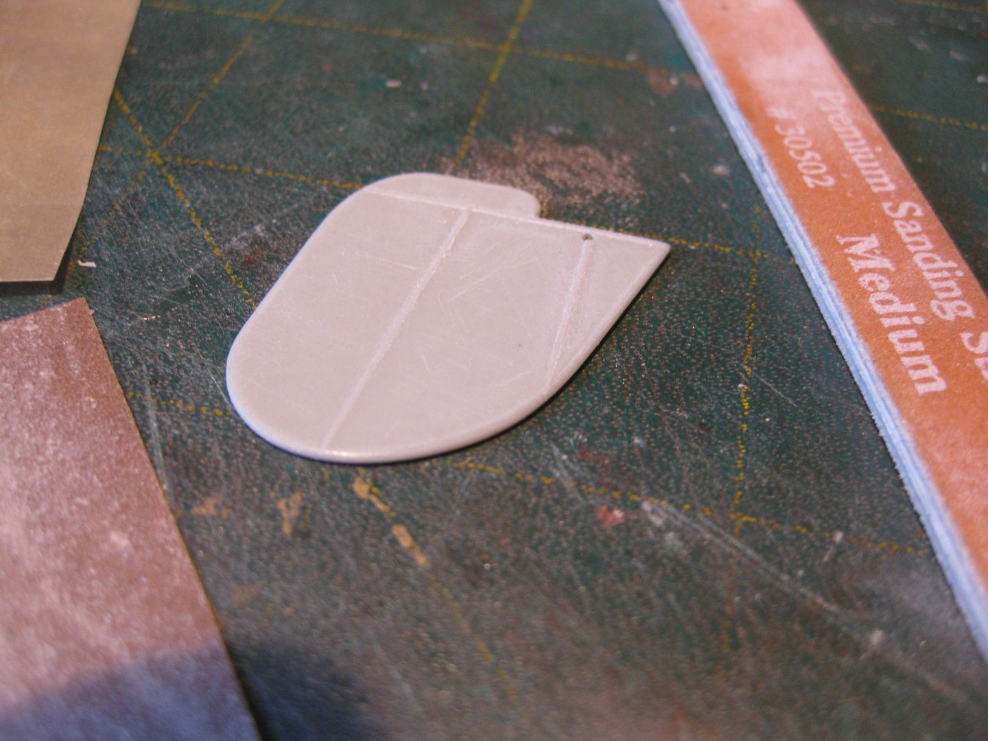

    I started with removing the basic parts from their sprues, a lot of flash, ejector pin marks, and molding marks had to be cleaned up. Control surfaces were separated from the component parts and the secondary wing "riblets" along the top leading edges were sanded down to reduce their exaggerated profiles. The main rib tapes were left as was, they appear well done as represented.

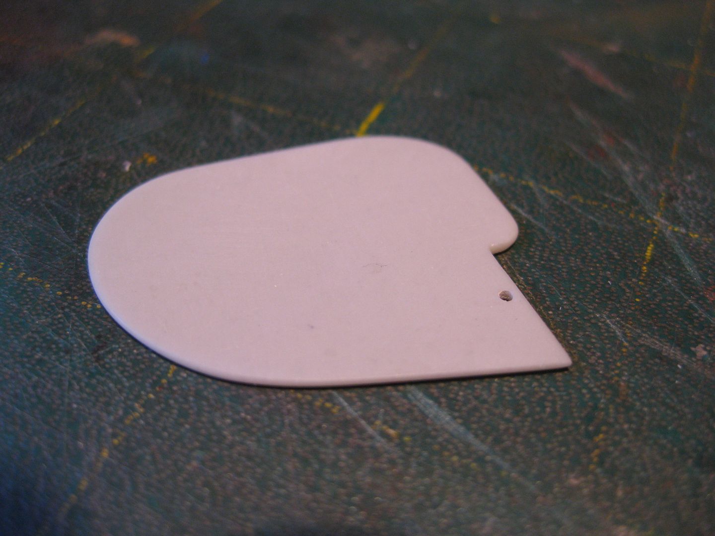

     The frame work represented on the rudder was removed as it is far too exaggerated, this detail can be represented with a little post shading at the painting stage.

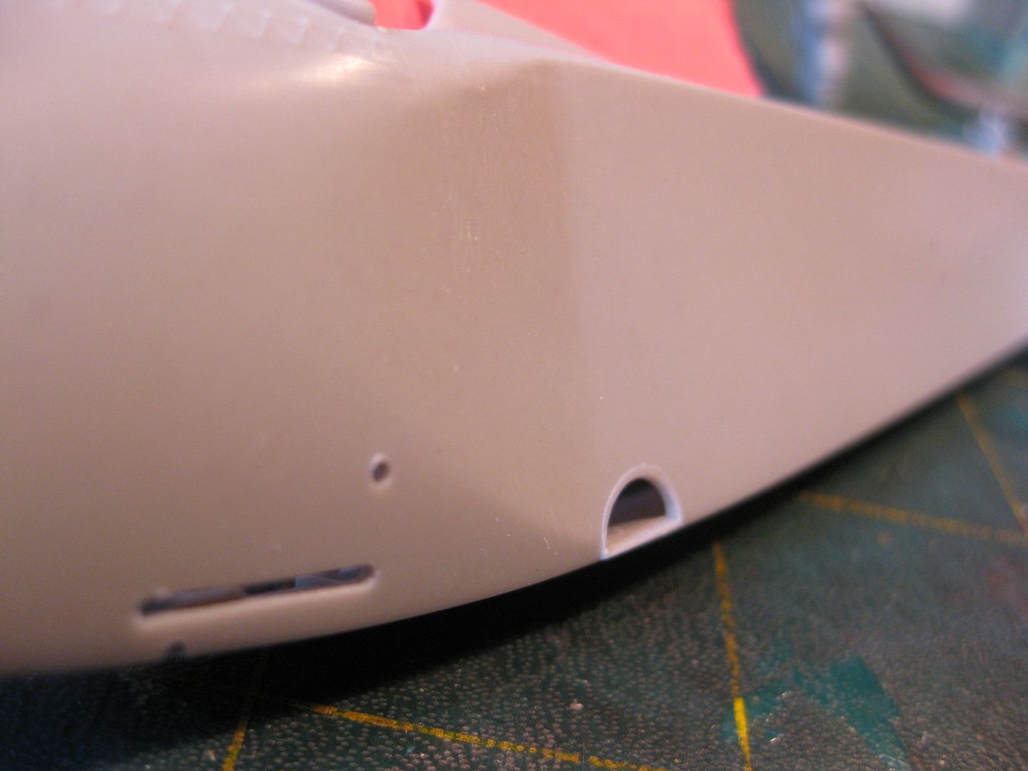

    The fuselage foot step was carved out and cleaned up, the "Tom's" Photo Etch set has a metal outline for it to be added later.

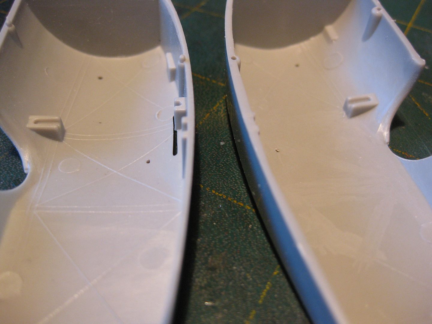

     I also removed the molded internal bracing wires etc from the insides of the fuselage and cleaned up the pin marks etc., before and after left to right here.

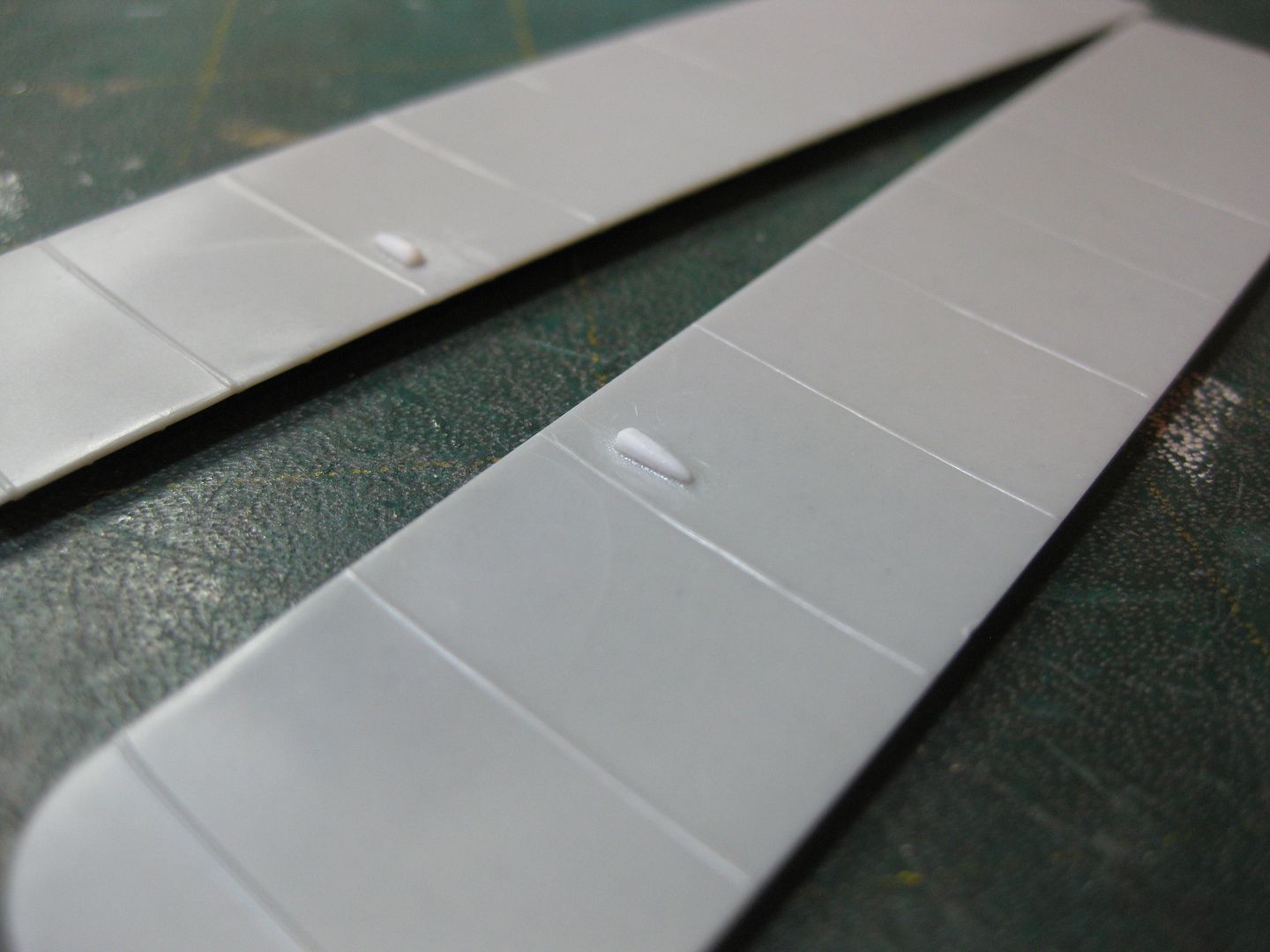

    The strut fairings on the under surfaces of the lower wings were far too small; they were shaved off and replaced with scratch versions made with scrap from my Evergreen "bundle".

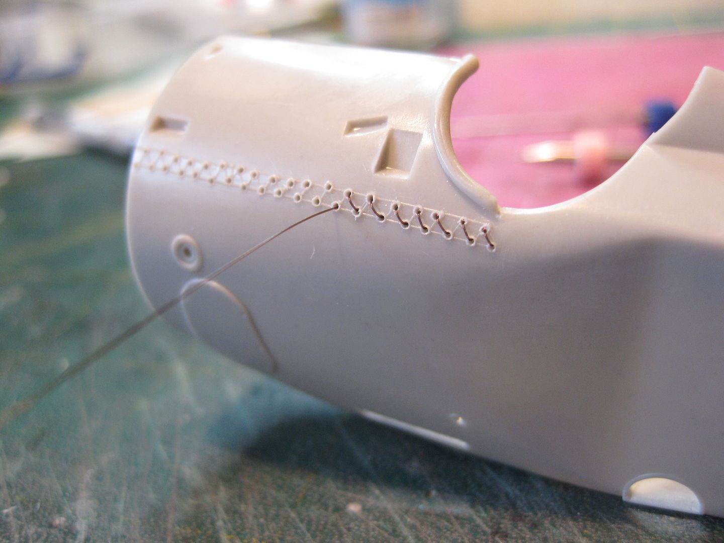

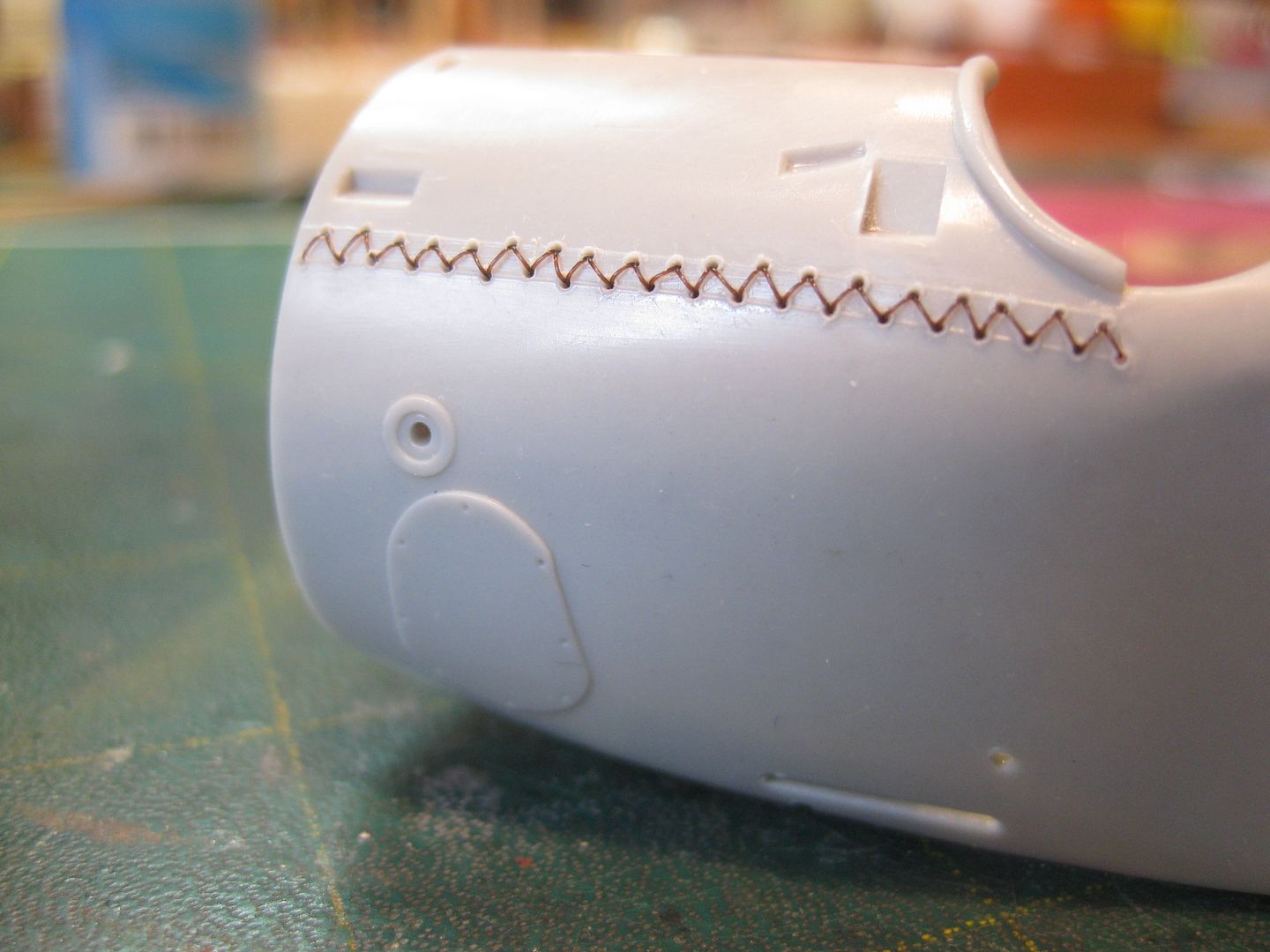

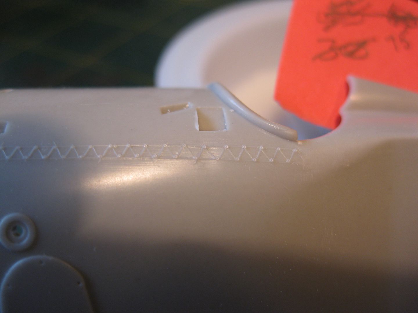

    Last at this stage was the stitching on the forward fuselage, a detail I puzzled over for days. Options included leaving them as is (unrealistic appearance IMHO), Photo etch, which I judged out of scale and lacking in relief, and finally the real thing, hand stitched through 78 drilled out rivets. Inspired by Greg's success in his Build I chose the latter and am quite happy with the results. I'll add the "flap" that covers to top portion of this detail at the finishing stage.
    Here's the stitching as on the Kit......
    Stitching in progress with holes drilled and rivets "raised" with a little work with a sharp pin. Line is 0.12mm Maxima Chameleon.
    And the finished version........

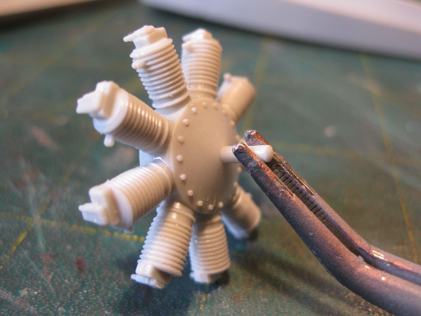

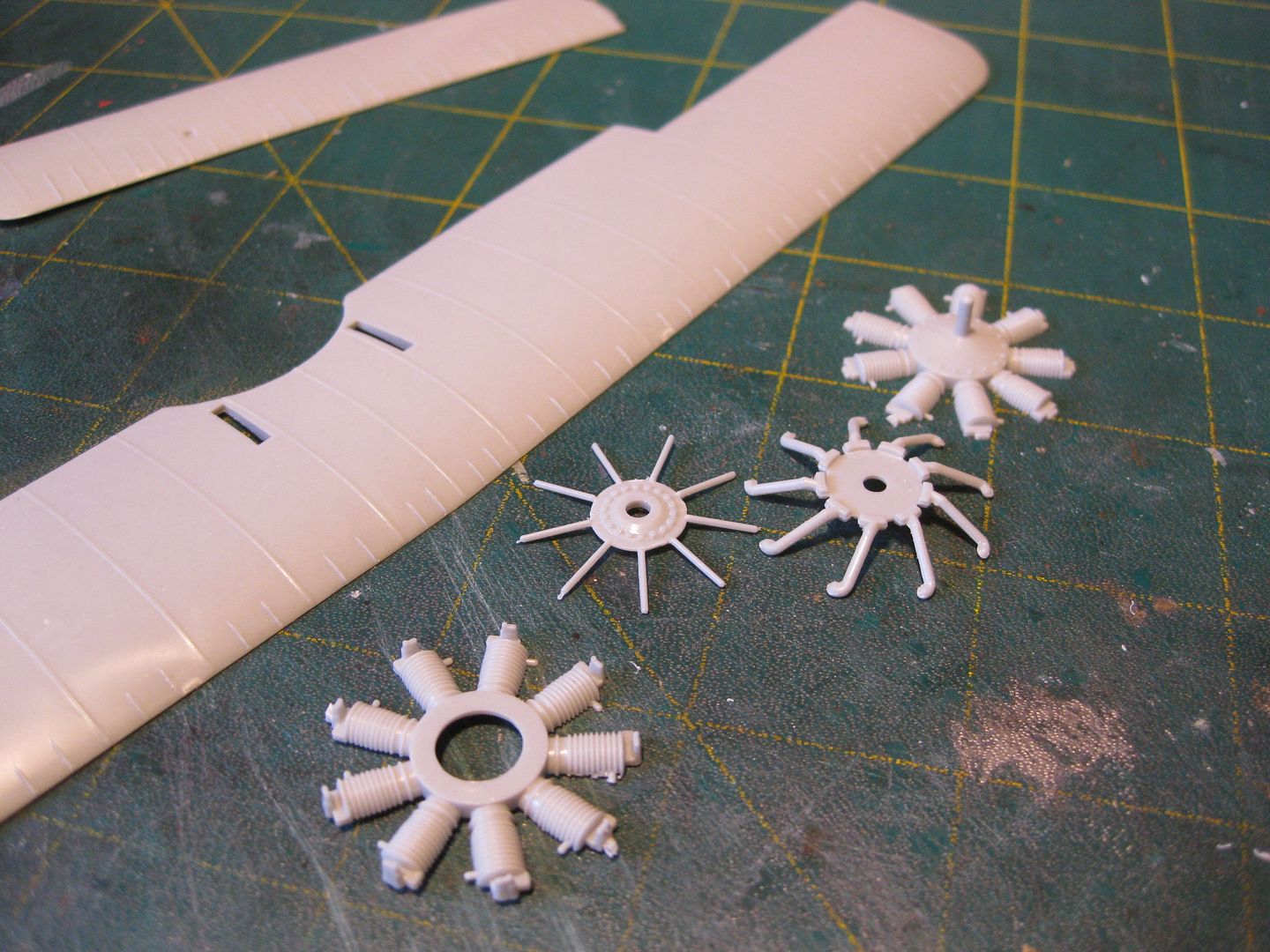

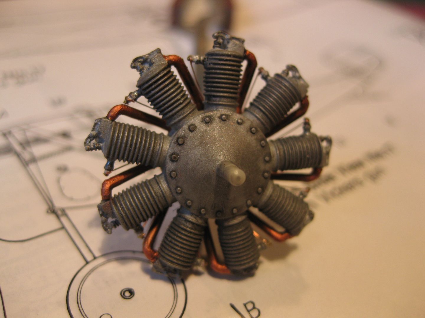

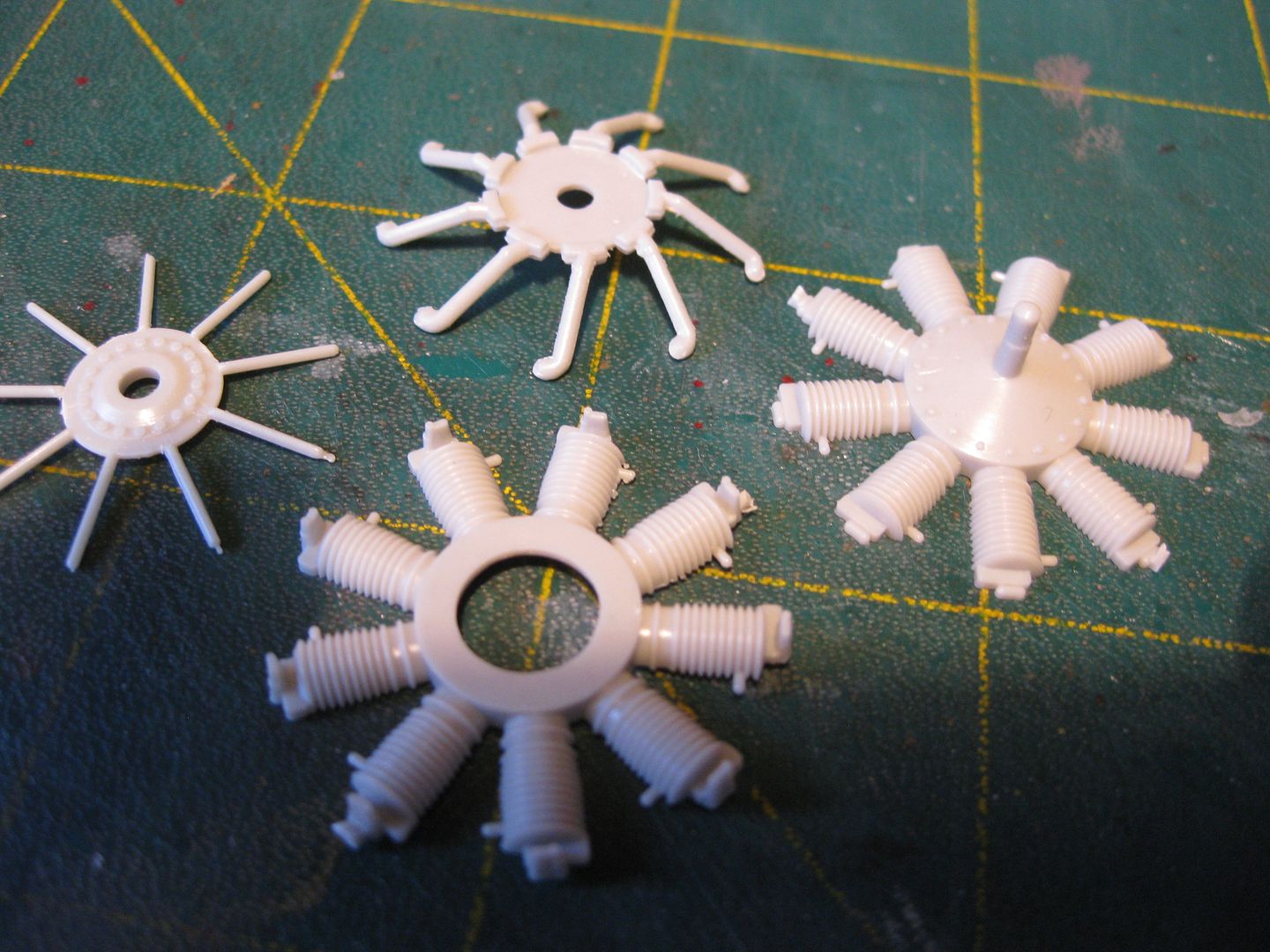

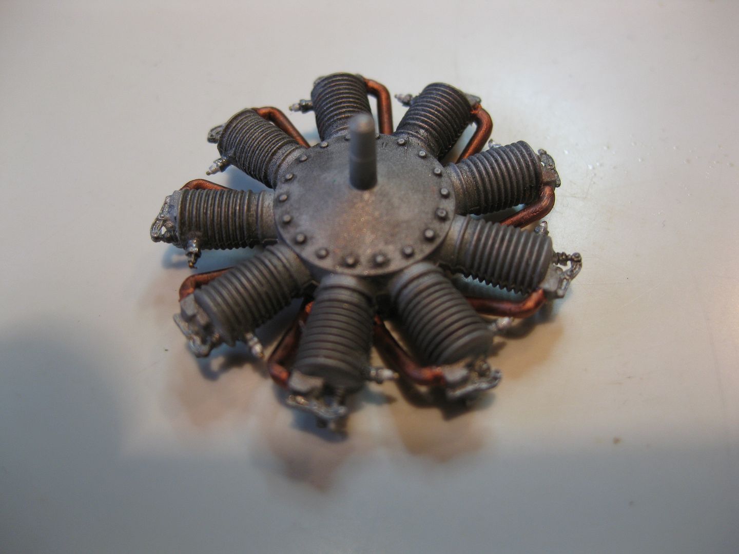

    here's the next retro update and final one I hope, then I can start working in real time. I considered an after market engine but given it's a Le Rhone 9 with not much detail visible once cowled and very little detail on the face I decided to improve the Kit's very basic version. The Kit engine comes in 4 pretty "rough" pieces.......

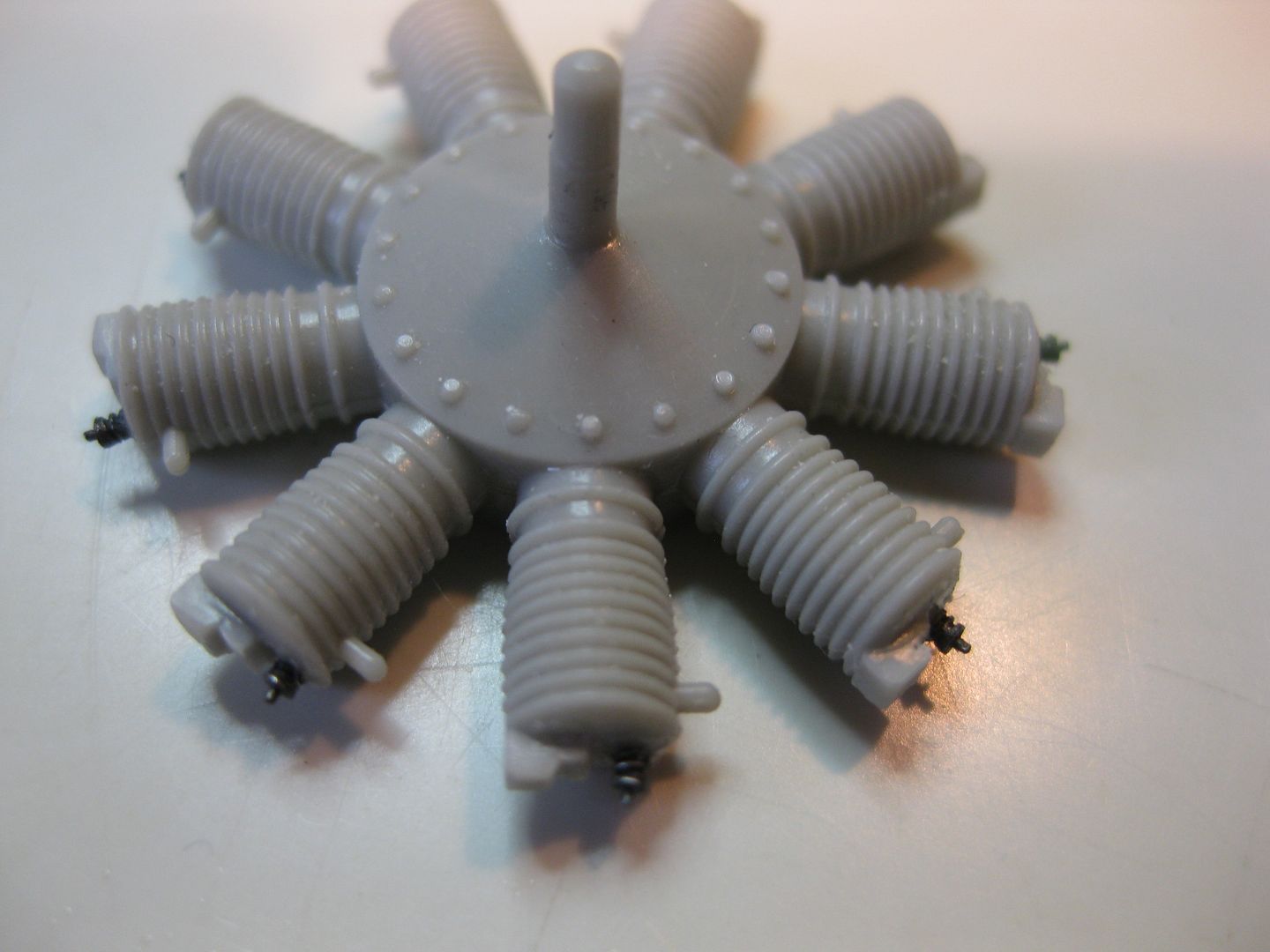

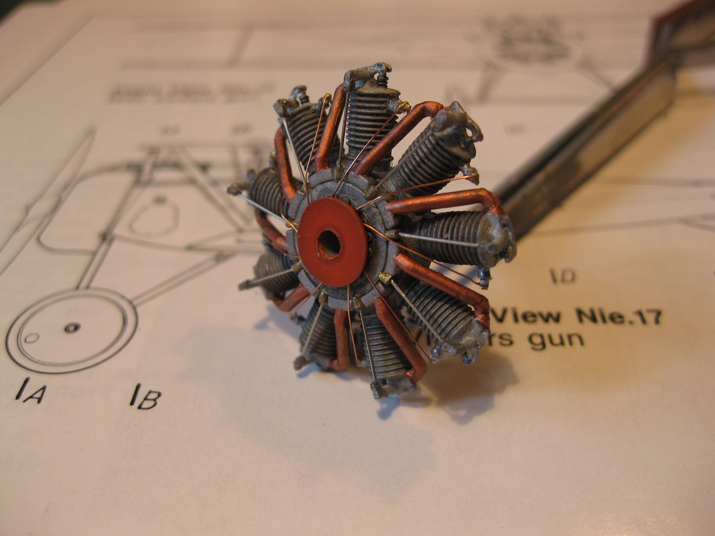

   After a lot of clean up the crankcase was assembled and the valves were removed from the intake sides of the cylinders and replaced by Taurus valves from the scrap box.
Taurus valves and springs in place.....

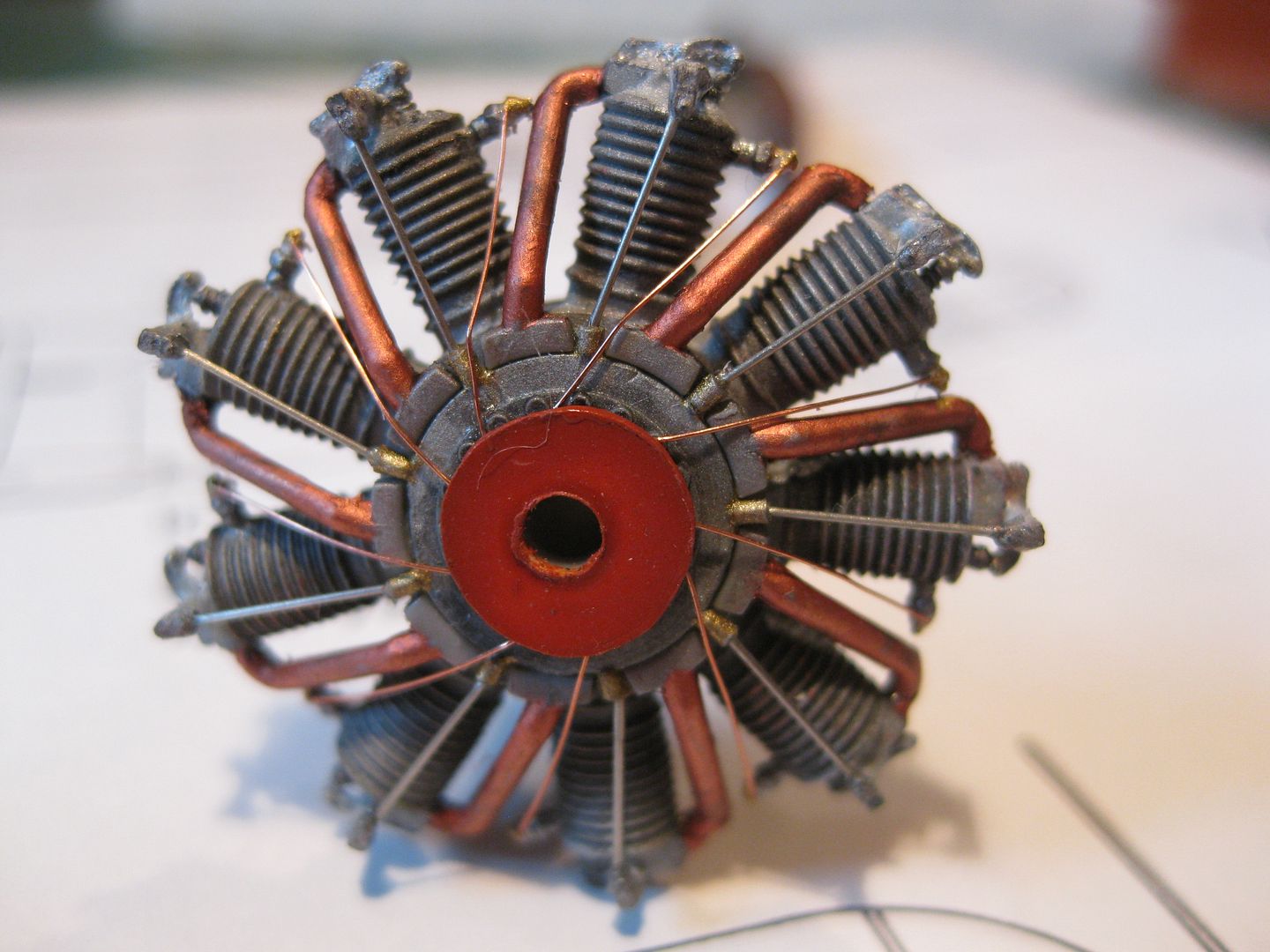

   At this point the basic painting was done, the copper exhaust manifolds added, spare Taurus valve lifters added and Taurus short version spark plugs replaced the "stubs" molded on the cylinders.
    Following that step I scratched an ignition wire race for the back of the engine, added the plug wiring, and installed the new stainless (guitar wire) push rods to the previously drilled out brass lifter fittings at the bottom end and some scrap Taurus upper lifter fittings at the top end.
   Finally here's a front and back view if the finished and "dirtied" Le Rhone.
   I've thanked Wonder Dog for the generous donation of his DNA in this last shot and removed the hair when he wasn't watching!

That's a very nice result for a basic kit supplied engine Lance. I particularly like that coppery finish on the intake (?) tubes - what paint did you use and was it brushed or sprayed? Neat trick with those stitching holes too, very effective.
