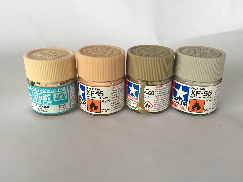

Guys, thank you very much for the so many and so nice comments, they are appreciated! I'm detailing the cockpit, adding lines, etc. I still haven't decided how deep should I dive into the detailing trap....while I want to recreate every detail, I also want to finish the build in few months and not few years :)
Sasho - I really love the colour effect you have on your wood - can you tell us what paint/varnish colours you used? It certainly has an extremely realistic look to it and I'd love to try to emulate it....

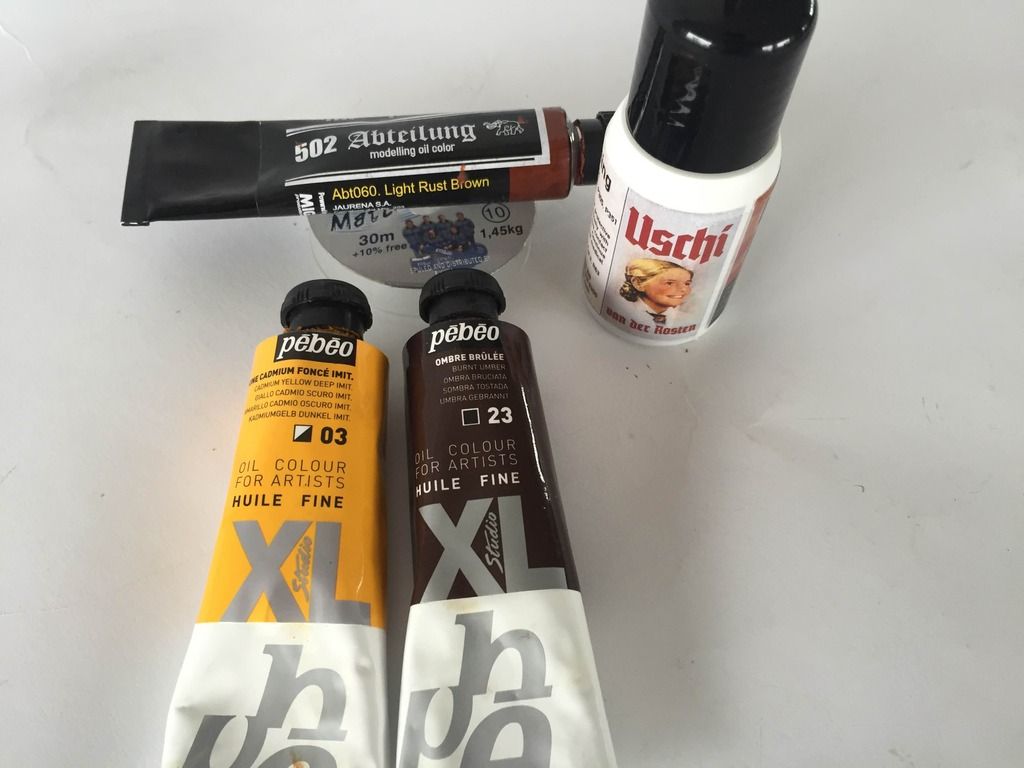

@Tug and zavod44: nothing fancy regarding my woodgraining technique, it is the standard Oils over acrylics, a bit tweaked to my personal preferences. Yesterday I just started to paint the inside of the nascelle, so I will take pictures that will be posted with my next update. I can strongly reccomend to check Bertl's builds where he explained the same technique with a way better result than I will ever achieve....and many others that I absolutely shamelessly have stolen, used and abused :)

Thanks for the response Sasho - it wasn't so much the technique you'd used as I had guessed you'd used oil over acrylics but what attracted my attention was that lovely honey yellow colour. What I'd really like to know if you wouldn't mind revealing all is what your specific colours were both in the acrylic undercoat and the oil overlay. The effect you have is very reminiscent of boxwood and looks extremely effective and I'm certainly going to try to achieve the same effect on my next model. I look forwards to your next pics - perhaps you wouldn't mind elaborating a little on your choice of colours as well.

Ooooooh.... oil paints, great I'll get started then......Thanks....

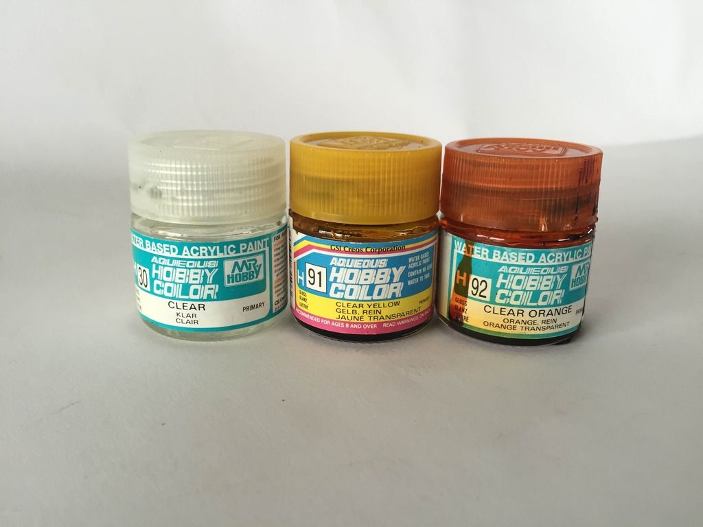

as I said, nothing fancy about the technique itself, it is the usual oils over acrylics. The nest pictures shows the paints - the first one is for the acrylic underlayer, on the Fe.2b I used mainly Gunze Radome. The second one is the oils with the accelerator and the third one is for the mix that seals them. For this I use 1:1:2 clear Yellow:clear:orange:clear. This makes the mix a bit more transparant and provides better control of teh final color.
If you have more questionss let me know:)

Thanks for that Sasho, I'll top up on what Tamiya I have at Telford in a couple of weeks plus the Gunze stuff. After an ebay win tonight I now have a lot of wood to do  ;)
